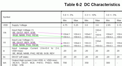

PostPosted: Wed Jul 15, 2015 2:28 pm
ArnoldLayne wrote:
Another thing is that according to the datasheet, it is not TTL compatible. The DS states a high level input voltage of VDD*0.7, which at 5V is 3.5V (the same column also states VDD-0.4 which really makes me wonder which is true now). (see page 24)
It's true the inputs of the WDC 'C02 are not TTL compatible. The simplest solution is, don't use TTL to drive the inputs of a WDC 'C02! You can still use the familiar 74__ series chips. Just be sure to select the CMOS versions, usually denoted by a 'C' in the part number (such as 74HC 74HCT 74AC 74ACT). IOW avoid 74LS (or, if you MUST use it, include a pullup resistor).
As for the data sheet, they've done a poor job lining up the rows, and perhaps that's causing some confusion. My take on Table 6-2 is that BE, D0-D7, RDY and SOB adhere to one set of specifications, and IRQB, NMIB, PHI2B and RESB adhere to another.
cheers,
Okay. So, if I happen to have stuff on the data bus that does not have CMOS-outputs (which I do), like an old NMOS TMS9929 for example or even non-CMOS SRAM, I should buffer D0-D7 through a 74HCT245 to be on the safe side. Is that correct?
Ah, thanks.. makes a lot more sense now.
PostPosted: Wed Jul 15, 2015 3:34 pm
Yes, correct. I presume the outputs of the stuff you mention are rated to meet TTL levels. And the "T" in 74HCT245 means it will accept those levels.
Adding that '245 is probably overkill, but I can understand if you prefer to do things "by the book." A lot depends on the nature of the doc that's available. With the TMS9929, for example, if you're lucky the doc will be explicit enough to assure you that the '245 is not necessary. It may well be the case, but the folks who wrote the doc may've omitted certain info, assuming the user would be connecting to more NMOS, or to TTL.
Pullup resistors are still an option, although you'd need eight of them.
BTW, most other 'C02 manufacturers do cite TTL levels as being acceptable on the inputs -- it used to be a big selling point. Nowadays it's much less important.
One situation still makes it attractive. In a mixed-voltage system, a CMOS device operating on 3V can directly drive the input of a device operating on 5V if the 5V device is specified to accept TTL levels. But if you needed to input a 3V signal into a WDC 'C02 running on 5V, a level converter would be necessary (assuming you're determined to meet spec).
