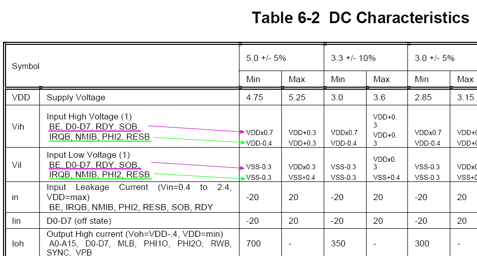

ArnoldLayne wrote:
Another thing is that according to the datasheet, it is not TTL compatible. The DS states a high level input voltage of VDD*0.7, which at 5V is 3.5V (the same column also states VDD-0.4 which really makes me wonder which is true now). (see page 24)
It's true the inputs of the WDC 'C02 are not TTL compatible. The simplest solution is, don't use TTL to drive the inputs of a WDC 'C02! You can still use the familiar 74__ series chips. Just be sure to select the CMOS versions, usually denoted by a 'C' in the part number (such as 74HC 74HCT 74AC 74ACT). IOW avoid 74LS (or, if you MUST use it, include a pullup resistor).
As for the data sheet, they've done a poor job lining up the rows, and perhaps that's causing some confusion. My take on Table 6-2 is that BE, D0-D7, RDY and SOB adhere to one set of specifications, and IRQB, NMIB, PHI2B and RESB adhere to another.
Okay. So, if I happen to have stuff on the data bus that does not have CMOS-outputs (which I do), like an old NMOS TMS9929 for example or even non-CMOS SRAM, I should buffer D0-D7 through a 74HCT245 to be on the safe side. Is that correct?
Ah, thanks.. makes a lot more sense now.
