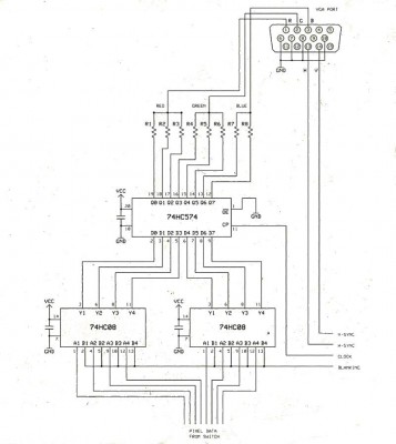

PostPosted: Tue Jun 23, 2015 6:13 pm
Posts: 632
You nailed it!
A few ns of lag and the dreaded fat/skinny first/last pixel issues rears its ugly head.
Not so bad on a glass CRT, but horrible banding on an LCD.
All outgoing signals MUST sync to a clocked register.
Funny, I could probably generate VGA with a handful of 555 timers, one-shots, and some 1970's op amps, but try to make 100% perfect VGA and draw a single pixel border around the edge of the screen (0,0-399,299 in my case) without banding, fuzzng, or thickness variations... now that's another thing altogether! Challenging even on an FPGA so I have found out.
I use the 163's quite a bit in other parts of this project, but in the video addressing circuit, I had to stick to the 590's for reasons I will get into as I detail everything.
I use them in another circuit I call "fast clear" as well, which is clocked at an amazing 50Mhz on this breadboard!
163's didn't like that kind of speed.
Thanks,
Brad
you wouldn't have to use pull-down resistors to hold the low level required during blanking, but alas, there would be another problem.
Right -- that's one of the problems I noticed. The other is that, on '574 (or '273), the prop delay from clock to output will differ from the prop delay from OE\ (or CLR\) to output.
To provide the absolute timing regularity that video demands, it's pretty well obligatory to arrange things so a single clock signal updates both pixel data and blanking.
I would consider replacing the '574 with a pair of '163 counters, which offer synchronous load and synchronous clear, both from a single clock. ('163s are great little chips -- good for so much more than just counting!)
cheers,

PostPosted: Tue Jun 23, 2015 8:48 pm
Posts: 3366
It's all good, and I envy you being able to indulge in a project like this. 8) What I was referring to was more basic, though -- simply the notion of replacing this
with this:
In this application the '163s "counters" don't count in any way -- they are used simply as edge-triggered registers, featuring the synchronous load and synchronous clear modes we require.
It takes a pair of 163s to implement the 8-bit register, but I didn't bother to explicitly draw both 163s. The power and control pins all go in parallel; only the data IO pins are separate. The CET and CEP inputs can be tied either high or low; the thing won't ever count anyway because the load & clear functions both override the count function (and clear overrides load).
The only potential problem I can see is if one '163 happened to be significantly faster or slower than the other (I don't think a slight difference would matter). Luckily, for a project like yours it's acceptable to hand pick your parts. As long as both 163s are from the same vendor -- the same lot, even -- I expect that'd resolve any issue. But it's always possible there's something else I'm missing.
cheers,
PostPosted: Wed Jun 24, 2015 12:38 am
Posts: 632
Hey, thanks for the idea of using a 163 as register with clear... never thought of that one!
It's like learning a new op code!
Although this will certainly come in useful at some point, there is an issue driving the DAC from a 163 as I have found out in a different test. As you mentioned, pathways are not perfect through each of the 4 bits, and this shows as slight phasing on some monitors that have to self adjust. So I would still need one more 574 after the 163's, which puts me back to the same chip count as the 2 AND gates.
But I will be using this idea elsewhere, so thanks for posting this!
Cheers!
Brad

GPU -> 1024 cycles @ 20 MHz = 323 Sprites
So if the 6502 could actually run at 20MHz, it could only send 8 sprites per frame as compared to 323 sprites drawn by the 37 logic chips in the GPU!!
And since the 6502 need only hurl out a few bytes to setup the GPU, it may only need 50 cycles of time before it can move on to other game tasks.
With the GPU having an independent dual bus, the 6502 could go onto game logic or doing sound tasks while the GPU is running... no waiting around!
So that's my plan.
I will start hammering in chips sometime this weekend, depending on the flow of cloud juice.
Radical Brad
PostPosted: Fri Jul 03, 2015 2:40 pm
Posts: 10838
Excellent - I love block diagrams, they can convey so much more than code or schematics or text.
Edit: so your GPU gives you the equivalent horsepower of an 800MHz 6502. That's a new record!
