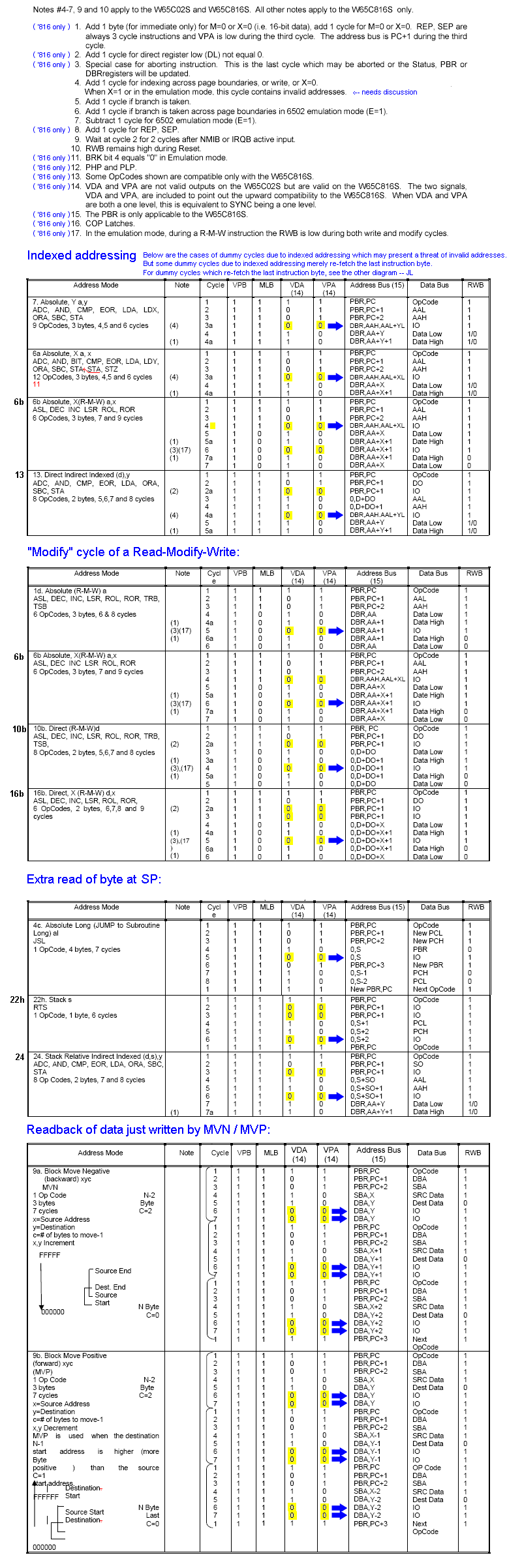

PostPosted: Sat Jun 27, 2015 1:21 am
Michael wrote:
Something like this?
That's good info, Michael -- clear and easy to read. Where did it come from? Unfortunately it's not arranged in a way that lets you quickly notice all the dummy bus cycles. Table 5-7 of WDC's '816 datasheet is NOT easy to read, but at least it makes dummy bus cycles obvious; you can just scan down the columns for VPA & VDA and look for cases where they're both zero. But Table 5-7 is seven pages long!
Here, then, is my edited version of Table 5-7 -- sorted and highlighted to show every case where dummy bus cycles occur. Despite being part of an '816 datasheet, Table 5-7 apparently applies to WDC's current 'C02 as well (the W65C02S).
As you can see below, I rearranged and condensed the seven-page table into two tall, skinny gif files. Although I was reasonably careful, it's possible I accidentally introduced some errors, so check the WDC original if you prefer to see their errors only! :wink:
Edit: I will be adding detail and revising these gif diagrams, so I suggest you do NOT download them. Here is rev1 of the first table. Matters related to indexed addressing I moved up near the top, for easier reference to the notes. IMO indexed addressing is by far the most confusing cause of dummy bus cycles!
cheers,
'02 and '816 dummy cycles due to misc causes rev1.gif [ 164.26 KiB | Viewed 1474 times ]
'02 and '816 dummy cycles due to extra read at PC.gif [ 203.93 KiB | Viewed 1474 times ]

Yikes, having to keep track of the D flag is a deal breaker :( I do plan to use a lot of BCD arithmetic. Thanks for the ideas but I think I will have to leave this feature out. In the future I think I will also only buy 65C816s even when I really want a 6502.
