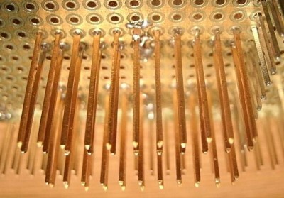

PostPosted: Thu Jun 18, 2015 8:10 pm
Here's another mounting method for SOJ (below).
Also I've edited my previous post to include a circuit for two wait-states. Compared with no wait states, this results in roughly quintuple (5 times) the available memory access time. /CS is presumed to go low before the start of phase two, as already discussed.

Brad, how do you normally keep the IC in place? A dab of hot glue? Blutack? (:D)

Posts: 690
Once you solder the 4 bent legs, the IC is pretty well affixed since it seats nice in the socket.
Here is a closeup of the operation...
http://forum.6502.org/viewtopic.php?f=4&t=3329
Brad
