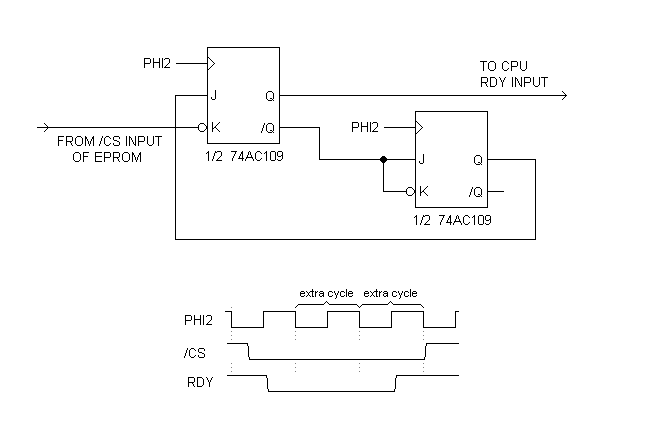

You could use a dual-rate clock.
Jeff's solution (above) is more elegant, has a very low parts count and can be rigged up to only affect devices that need a wait-state. Otherwise, the system runs full speed ahead at all times.
Unlike the NMOS parts, the 65C02 (and 65C816) will respond to RDY during write cycles. So there's really no good reason to not use wait-states to accommodate slower devices.

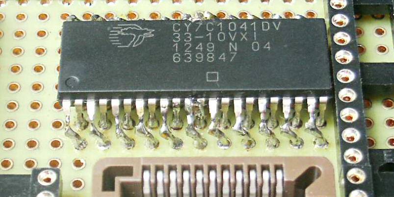

The 10ns SOJ packages are easy to hand solder.
I have done this using 3 different moethods; adapter, ribbon wire to socket, and most recently, dead-bugged to socket.

The one you linked to has .025" square posts, which are too fat to go into a normal IC socket. Aries and others do however have the appropriate adapters. This is what they look like:
I have a few with different numbers of pins here. The adapter usually costs a lot more than the IC, but it sure makes things easy.

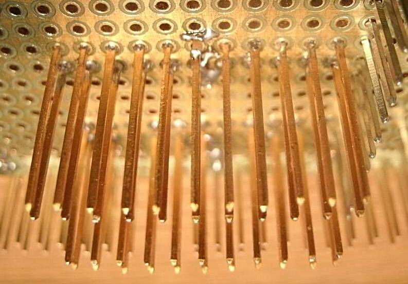

Posts: 3526
Re: Speed & EEPROMs
Here's another mounting method for SOJ (below).
Also I've edited my previous post to include a circuit for two wait-states. Compared with no wait states, this results in roughly quintuple (5 times) the available memory access time. /CS is presumed to go low before the start of phase two, as already discussed.
cheers,
double-wait-state generator.gif (4.32 KiB) Viewed 2634 times

Once you solder the 4 bent legs, the IC is pretty well affixed since it seats nice in the socket.
Here is a closeup of the operation...
