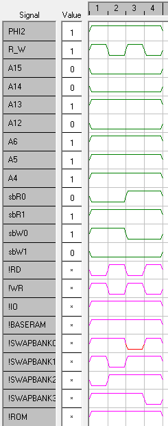

Ok here we are with the dual read bank, write bank implemented (Many thanks to Peter).
I get an odd error with this, though, when trying to simulate it. It seems to generate a parse error in the .SO file when compiled from WinCUPL. If I then go into the Simulator and compile it I end up with what I expected.
Here's the code and the data I ran it with. Can anyone else reproduce the error?

There .SI file:
Name     AddressDecoder;
PartNo   Lattice22V10B;
Date     02/04/15;
Revision 01;
Designer shalewyn.com;
Company  shalewyn.com;
Assembly XXXXX;
Location XXXXX;
Device   g22v10;
ORDER: PHI2, R_W, A15, A14, A13, A12, A6, A5, A4, sbR0, sbR1, sbW0, sbW1, !RD, !WR, !IO, !BASERAM, !SWAPBANK0, !SWAPBANK1, !SWAPBANK2, !SWAPBANK3, !ROM;
VECTORS:
1 1   0 0 1 0   1 1 1   0 1   1 0   * *   *  *  * * * *  *
1 0   0 0 1 0   1 1 1   0 1   1 0   * *   *  *  * * * *  *
1 1   0 0 1 0   1 1 1   1 1   0 0   * *   *  *  * * * *  *
1 0   0 0 1 0   1 1 1   1 1   0 0   * *   *  *  * * * *  *
And my eventual results after recompiling from within the Simulator:
Confirmed as working (so far) in a GAL :)
[EDIT] I've just removed A5-A7 (pins 7-9) as they are not used. Frees up 3 pins for future use.

I noticed a few things on your original post. The Selects field had 6 bits vs. 5, so I corrected that.
It also appears that it does not matter if I define Selects as [s4..0] or [s0..4], WinCUPL formats it as [s4..0].
The manual also said the default value is HEX so I removed the 'h' prefixes. The example in the manual also had a full
16-bit hex address even thought the AddressBus only had A15..A12 defined, so it must strip off any extra bits. That is why I used the
full 16-bit address in the table.
Here is the output from the Simulator (click to enlarge):
Vector 1 = $0000
Vector 2 = $2000
Vector 3 = $8000
Vector 4 = $8010
Vector 5 = $8020
Vector 6 = $8040
Vector 7 = $9000
Vector 8 = $FFFF
It appears correct in the simulation, I have not tried it on actual silicon.
Daryl

Ok, the following seems to work. I've added in the bank control selects with appropriate inputs and restrictd the ability to write to a device until phi2 goes HI.
Partno     Lattice22V10B;
Date       02/04/15;
Revision   01;
Assembly   1;
Location   1;
Device     g22v10;
 * Lattice GAL 22V10B pinout, DIP, top view
 * I/CLK.[ 1     24 ].VCC
 *     I.[ 2     23 ].I/O/Q
 *     I.[ 3     22 ].I/O/Q
 *     I.[ 4     21 ].I/O/Q
 *     I.[ 5     20 ].I/O/Q
 *     I.[ 6     19 ].I/O/Q
 *     I.[ 7     18 ].I/O/Q
 *     I.[ 8     17 ].I/O/Q
 *     I.[ 9     16 ].I/O/Q
 *     I.[ 10    15 ].I/O/Q
 *     I.[ 11    14 ].I/O/Q
 *   GND.[ 12    13 ].I
 * $0000-$1FFF : %0000 0000 0000 0000 - %0001 1111 1111 1111 : Base RAM area
 * $2000-$7FFF : %0010 0000 0000 0000 - %0111 1111 1111 1111 : Swap RAM area
 * $8000-$8FFF : %1000 0000 0000 0000 - %1000 1111 1111 1111 : I/O area (VIAs, ACIAs, etc.)
 * $9000-$FFFF : %1001 0000 0000 0000 - %1111 1111 1111 1111 : ROM
 * Inputs
Pin 1 = phi2;
Pin 2 = cpuRW;
Pin [3..6] = [A15..12];
Pin 13 = SbR0;
Pin 14 = SbR1;
Pin 15 = SbW0;
Pin 16 = SbW1;
 * Outputs
/* s0 - NonSWAP RAM
 * s1 - Swap RAM bank 0
 * s2 - Swap RAM bank 1
 * s3 - Swap RAM bank 2
 * s4 - Swap RAM bank 3
 * s5 - I/O (VIAs, ACIAs, etc.)
 * s6 - ROM */
Pin [17..23] = ![s0..6];
 * Main
FIELD AddressBus = [A15..12];
FIELD Selects = [s6..0];
/* Note that each device which can be written to has 2 entries - one for reading and
 * one for writing. This is because writing should only ever happen when phi2 is HI
 * so we need one rule which allows read if cpuRW is HI and one rule which only
 * allows writes when cpuRW is LOW and phi2 is HI. */
TABLE AddressBus => Selects {
   [0000..1FFF] => 'b'0000001 & cpuRW;             /* S0 - Non-swap RAM read */
   [0000..1FFF] => 'b'0000001 & !cpuRW & phi2;          /* S0 - Non-swap RAM write */
   [2000..7FFF] => 'b'0000010 & !SbR0 & !SbR1 & cpuRW;    /* S1 - Swap RAM read bank 0*/
   [2000..7FFF] => 'b'0000100 & !SbR0 & SbR1 & cpuRW;       /* S2 - Swap RAM read bank 1 */
   [2000..7FFF] => 'b'0001000 & SbR0 & !SbR1 & cpuRW;       /* S3 - Swap RAM read bank 2 */
   [2000..7FFF] => 'b'0010000 & SbR0 & SbR1 & cpuRW;      /* S4 - Swap RAM read bank 3 */
   [2000..7FFF] => 'b'0000010 & !SbW0 & !SbW1 & !cpuRW & phi2;/* S1 - Swap RAM write bank 0 */
   [2000..7FFF] => 'b'0000100 & !SbW0 & SbW1 & !cpuRW & phi2; /* S2 - Swap RAM write bank 1 */
   [2000..7FFF] => 'b'0001000 & SbW0 & !SbW1 & !cpuRW & phi2; /* S3 - Swap RAM write bank 2 */
   [2000..7FFF] => 'b'0010000 & SbW0 & SbW1 & !cpuRW & phi2;   /* S4 - Swap RAM write bank 3 */
   [8000..8FFF] => 'b'0100000 & cpuRW;             /* S5 - IO read */
   [8000..8FFF] => 'b'0100000 & !cpuRW & phi2;         /* S5 - IO write*/
   [9000..FFFF] => 'b'1000000;                /* S6 - ROM */
Test results
Date     02/04/15;
Revision 01;
Assembly 1;
Location 1;
Device   g22v10;
ORDER: phi2, cpuRW, A15..A12, SbR0, SbR1, SbW0, SbW1, !s0, !s1, !s2, !s3, !s4, !s5, !s6;
VECTORS:
/* each test comprises of a set of read and a set of writes.
* 1st test is for PHI2 being HI and the 2nd for PHI being LOW */
/* Base RAM test 2xRead, 2xW1rite */
11 '1' 0110*******
01 '1' 0110*******
10 '1' 0110*******
00 '1' 0110*******
/* Swap RAM bank 1 read, bank 2 write tests 2xRead, 2xWrite */
11 '2' 0110*******
01 '2' 0110*******
10 '2' 0110*******
00 '2' 0110*******
/* Swap RAM bank 3 read, bank 0 write tests 2xRead, 2xWrite */
11 '2' 1100*******
01 '2' 1100*******
10 '2' 1100*******
00 '2' 1100*******
/* I/O test 2xRead, 2xW1rite */
11 '8' 1100*******
01 '8' 1100*******
10 '8' 1100*******
00 '8' 1100*******
/* ROM test 2xRead */
11 'F' 1100*******
01 'F' 1100*******

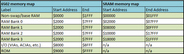

And finally here's the 1Mbit RAM IC version. This one doesn't use 4 different modules, but utilises a 1Mbit (128KB) RAM. It splits the IC into quarters, maps banks 0-3 to each quarter by controlling A15 and A16 address pins.
Base RAM sits in the first quarter (bank 0).
Memory map now looks something like this:
Total RAM space is:
24KB x 4 banks = 96KB + 8KB base RAM = 104KB Total RAM
Additionally, you have 4KB of I/O address space and 28KB of ROM space for the OS.
Total addressable space (by cheating)? 136KB. Not too shoddy.
Please see attached for the .PLD and .SI files (I had to rename them as TXT so I cold upload them to the forum):
[EDIT] Now changed to be compatible with the 65C816 (thanks BigD :))
ADDRESSDECODER_PLD.TXT [4.2 KiB]
Downloaded 105 times
ADDRESSDECODER_SI.TXT [514 Bytes]
Downloaded 90 times
My next step is to drop this into a 4Mbit SRAM and also find a way of possibly using the slack 8KB lost in each bank area except bank 0 (i.e. +$0 to +$1FFF).
