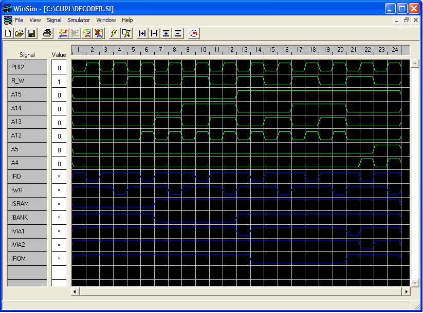

 Post subject: Re: GAL Address Decoder
PostPosted: Fri Apr 03, 2015 12:27 am
Posts: 996
Location: Berkshire, UK
I couldn't get the FIELD definitions to work but it compiles correctly when done long hand

In the traces vectors 1-4 test RD and WR decoding, 5-20 test each 4K page from 0xxx to Fxxx, 21-22 test VIA1/2 and 23-24 test unmapped IO page addresses.
Andrew Jacobs
PostPosted: Fri Apr 03, 2015 1:17 am
Posts: 8387
BitWise wrote:
I couldn't get the FIELD definitions to work but it compiles correctly when done long hand.
I've never been able to get FIELD statements to work in WinCUPL. I believe this is yet another of many bugs in that software.
PostPosted: Fri Apr 03, 2015 4:50 pm
Posts: 491
Location: Switzerland
Hi banedon,
Lattice GALs have rather TTL output levels than CMOS output levels. It's normal that Voh is about 0.9V less then VDD.
I also have some suggestions regarding your decoder. You now create many swap bank select signals. Do you really intend to have as many SRAM chips? Wouldn't it be easier to have one large SRAM and create address mapping that match the bank select inputs?
Also I think your terms are not correct if BASERAM is $0000 to $1FFF as in the description the term would be
BASERAM   =   !A15 & !A14 & !A13
and the code for the Swapbanks would be for e.g. Swapbank 0
SWAPBANK0   =   !A15 & !A14 &  A13  & !sb0 & !sb1
            #   !A15 &  A14         & !sb0 & !sb1
Also the VIAs have two select pins. When using CS1 you can select decode VIAs using only one output of the GAL. E.g. you could create a select that as asserted for $8000 to $803F. This signal would be connected to /CS2 of both VIAs. CS1 of the first VIA would be connected to A4 and CS1 of the second VIA is connected to A5. Addresses $8010 to $801F would address the first and $8020 to $802F address the second VIA, the only thing is that you should never access $8030 to $803F as this selects both VIAs.
cheers
Peter
PostPosted: Fri Apr 03, 2015 5:50 pm
Posts: 740
cbscpe wrote:
Hi banedon,
cheers
Peter
Hi Peter
Thanks for your advice and suggestions.
I certainly could try that, although I really wanted to get the wretched decoder working as a test before I considered such things first (which it now does! :)).
I could put in a 1Mbit device and then split down possibly, although I was looking at possibly keeping it to 4 separate devices so it's modular - you put in what you need. But I suppose with the price of SRAM these days...
With regard to the VIA's that isn't a bad way of doing it and is pretty similar (in part) to the way Garth Wilson's primer is set up.
PostPosted: Fri Apr 03, 2015 6:41 pm
Posts: 740
I forgot to mention that you are quite correct with regard to this. Many thanks :)
PostPosted: Fri Apr 03, 2015 6:58 pm
Posts: 491
Hi banedon,
you can even get one step further in simplifying decoding. When using a 32kbyte (62256) or 128kbyte (628128) device and in case you only have RAM from $0000..$7FFF I normally just tie A15 to the /CE of the RAM. In case you don't use a Bank Switching it's a 32kbyte device in case of Bank Switching it's a 128kbyte. So the GAL creates no /CE for the RAM at all. Bank select then is done via the following equations, where R15 and R16 are the signals that connect to the 128kbyte SRAM address pins A15 and A16.
R15     =  !A15 & !A14 & A13 & sb0
        #  !A15 &  A14       & sb0
R16     =  !A15 & !A14 & A13 & sb1
        #  !A15 &  A14       & sb1
so the decoder does not change whether you have only 32kbyte RAM or 128kbyte Bank Switched RAM. That makes it easier to test the decoder. Thanks to JEDEC you only have one PIN (VCC of the 32kbyte SRAM) that needs a jumper or a different wire on a solderless breadboard. And as you said, a 128kbyte SRAM e.g. an AS6C1008-55 comes in PDIP has an access time of only 55ns, good for a 10MHz system is cheap, they sell currently for about 3USD.
As for bankswitching, sometimes you want to copy data from one bank to the other, therefore I would introduce 4 bankswitching signals, one set of 2 signals that control the bank you read from and 2 signals that control the bank you write to
R15     =  !A15 & !A14 & A13 & sb0r &  RW
        #  !A15 &  A14       & sb0r &  RW
        #  !A15 & !A14 & A13 & sb0w & !RW
        #  !A15 &  A14       & sb0w & !RW
R15     =  !A15 & !A14 & A13 & sb1r &  RW
        #  !A15 &  A14       & sb1r &  RW
        #  !A15 & !A14 & A13 & sb1w & !RW
        #  !A15 &  A14       & sb1w & !RW
without creating select signals for the RAM you have plenty of free pins on your GAL.
cheers
Peter
