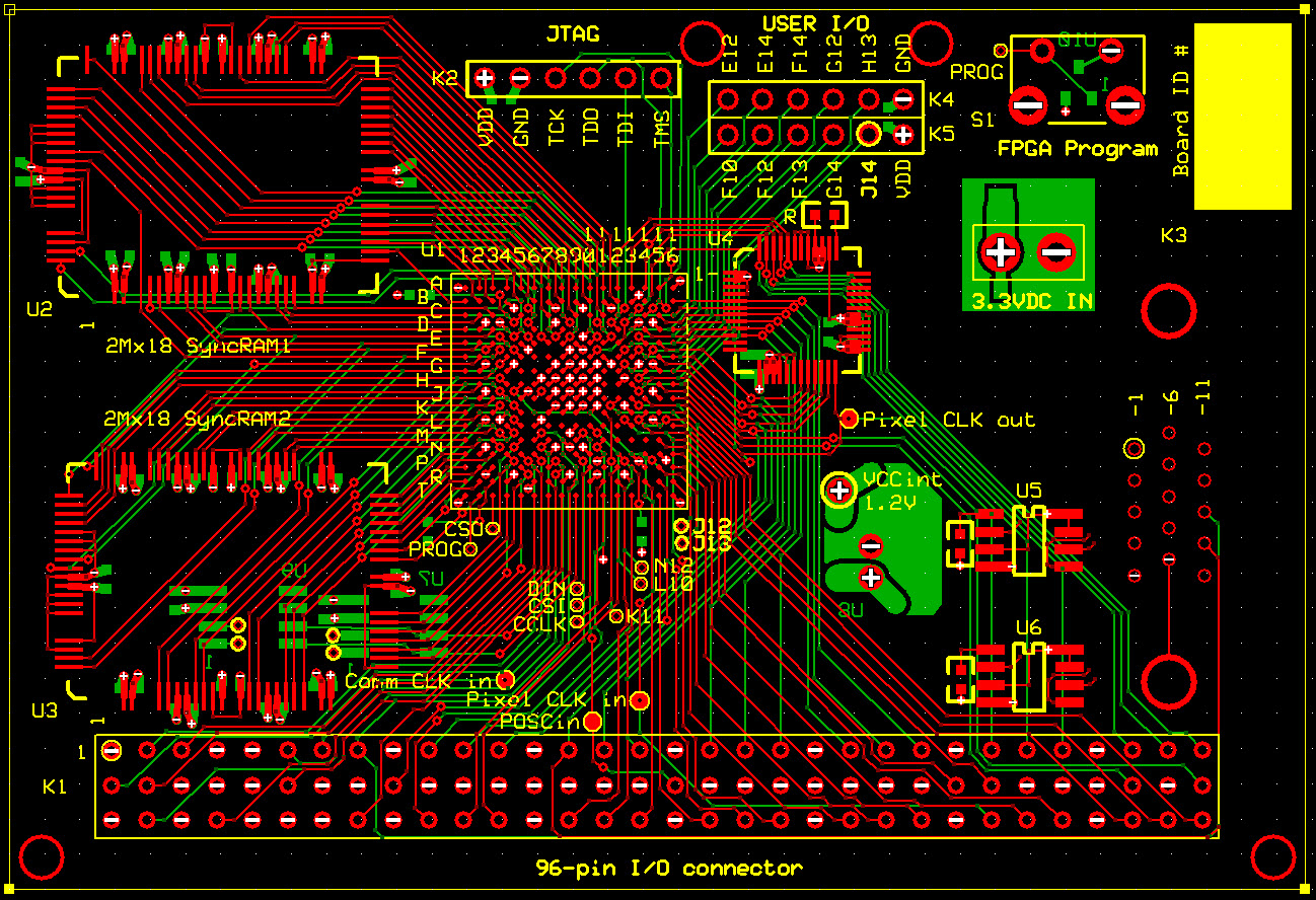

It looks pretty nice EE, but the little engineer in my head tells me that your average trace length could likely benefit from rotating the FPGA and SRAM assemblage 90 degrees clockwise like so (rotating the actual chips 90 degrees as well):
              OS           OS           OS
                    SRAM        SRAM
                     U3          U2
              OS          FPGA          OS
                 U9  U7    U1      U4
                 +======== I/O ========+
... where OS stands for "other stuff".
I know, I'm a stinker for even bringing it up at this stage of the game, but that little engineer in my head wouldn't leave me alone!
Mike
Yes it is late in the game! But thank you for your observation, it is very valid! One thing I can do that won't involve me starting from scratch is to move the Vreg at the bottom right of the FPGA further to the right, which would allow the videoDAC and a great many signals to be shortened.
I had focused on keeping the traces to the RAMs as close as possible, everything else was secondary. Those long traces you see are primarily for the RGB data in and RGB data out. PVBV2 design closely follows the original PVB design... And now that I think about it, those long traces may have been contributing to some things that were happening but didn't realize at the time. i.e. some colors appeared to be 2 pixels wide IIRC. I was also using a slow videoDAC, ADV7125 rated @ 140MHz when the pixel clock was ~150MHz. I'm sure both were contributing... However thinking about it further now, if the Pixelclockout trace length was close to the RGBout trace lengths, maybe there would be no issue with the length? Irregardless, shortening the trace lengths of these critical signals cannot be a bad thing!
I'm also investigating a free PCB layout tool called FreePCB, where one can just start laying down parts.
PostPosted: Mon Dec 22, 2014 8:56 pm
After 7 hrs of some relocating, things are looking much better I think! But my head hurts. Time for a brew. :)
The videoDAC is much closer to the FPGA and the RGB I/O is more or less converging on the bottom right of the FPGA, instead of looping around the I/O connector.
Also, the relocation of the 1.2V VReg for the FPGA VCCint isn't really that much further, maybe 1/4".
Thanks Mike for your critique!
Notice, there's 5 free signals at the bottom of the FPGA circled in yellow, but unnamed. 2 are GCLKs. Also, 10 more signals were able to routed through at the upper right of the FPGA, 1 of those also a GCLK. These 10 signals might go to a .1" female user I/O expansion connector.
File comment: 6th Iteration of PCB Layout

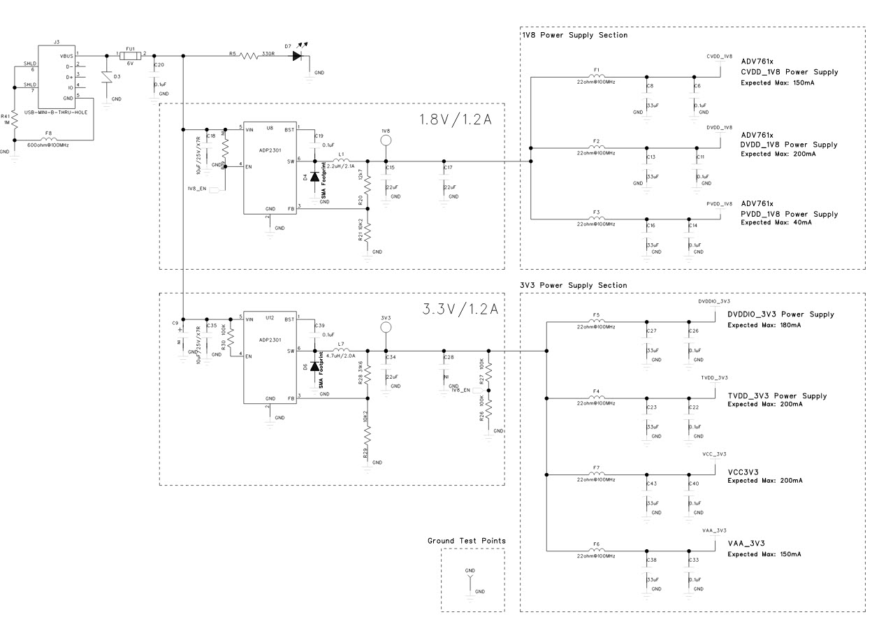

Since I'm not following Xilinx' rules on their recommendations for proper power supply bypassing, I'm debating on adding power supply filtering for the 3.3VCCO/AUX for the FPGA and also the 3.3V analog for the videoDAC in the form of an inductor and 2 cap's for each supply, sort of like Analog Devices does in their Connection Note (CN0282). Can anyone give me some tips on the values to shoot for? It looks like their values aim to filter out switching noise from their switching power supply IC's (ADP2301).
PostPosted: Fri Dec 26, 2014 1:59 am
Posts: 8546
L1 & L7 are necessary parts of the switching regulators, and the layout of those is very critical to get good behavior, that being especially important for the analog portions of your circuit. Are you laying out that part of the power supply though?
F1 through F7 are ferrite beads. Check out this one: http://www.mouser.com/ProductDetail/Lai ... YbBQ%3d%3d (or others in that family). How much current do they need to handle? Make sure you have ones rated for it so they don't saturate and lose their "choke" value.
Next, get the 0.1uF chip capacitors as close as possible to the power connections they go to on the chip, to get the lowest possible inductance for an AC path from that power pin or ball to the ground plane. For BGA, that will probably mean putting it on the back of the board, on the side opposite the IC (although I have not done any BGA layout to speak with any authority about how to do that). You can get those in 0402--maybe smaller (since you can get by with a WVDC of 16V or even 10V)--but I don't know if you're able to mount something that small by hand. Small is good for reducing inductance though. Take a look at this article from Dr. Howard Johnson on minimizing bypass capacitor inductance. The capacitors that are 33uF in your diagram don't have to be as close.
PostPosted: Fri Dec 26, 2014 2:25 am
Ah, I missed the fact that they were ferrite beads! I assumed they were typical inductors based on the inductor sign but missed the F1-F7 part numbering. Thanks for pointing that out!
I can't get a bypass cap next to each of the BGA power pads, which is why I was thinking the next best thing would be to isolate the BGA 3.3V with it's own power plane and filtering, same for the 3.3V analog section of the videoDAC.

I believe the PVBV2a has been finalized.
All the design goals have been reached for this board layout and now I feel like $200 is a price I'm willing to pay to get this thing rolling!
I've added 2 more power planes that are filtered using a ferrite bead and a few capacitors, within the 3.3V main power plane shown at the bottom pic.
One plane is for all the FPGA VCCO/VAUX pads, I count 25. The layout provides for a 0805 ferrite bead, a 0805 cap, and 2 0603 cap's. 6 amp rating of a ferrite bead this size are more than enough, as well as 33uF for an 0803 cap. I decided on a ferrite bead with a rating of 22ohm @100MHz, based on the Analog schematic I had posted above.
The other plane is for the analog 3.3V power of the ADV7125 videoDAC. The ferrite beads and caps are all 0603 sizes as the current demand is much less.
Any critiques welcome! Thank you.

PostPosted: Sun Dec 28, 2014 9:25 pm
Posts: 8546
It appears that all parts are on the top. Is that correct? If so, I think it would be good to put the power layer on the back, so it's not between the signal layers and the ground plane. The power layer has big chainsaw cuts in it, making it unsuitable as a plane layer for any signal traces that cross the cuts. I think your ground plane is continuous though, right?
PostPosted: Sun Dec 28, 2014 11:16 pm
It appears that all parts are on the top. Is that correct? ... I think your ground plane is continuous though, right?
Correct, but I can't change layer assignments. I think it's SIG-POW-GND-SIG. I'm just going to have to go forward and hope for the best.
