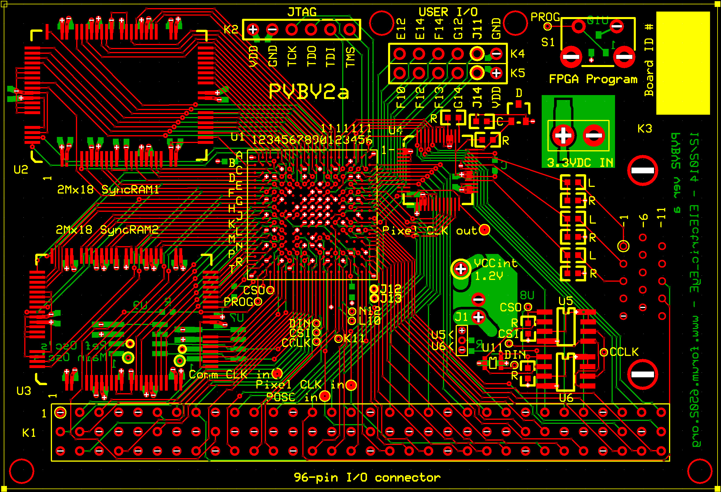

PostPosted: Mon Dec 22, 2014 8:56 pm
After 7 hrs of some relocating, things are looking much better I think! But my head hurts. Time for a brew. :)
The videoDAC is much closer to the FPGA and the RGB I/O is more or less converging on the bottom right of the FPGA, instead of looping around the I/O connector.
Also, the relocation of the 1.2V VReg for the FPGA VCCint isn't really that much further, maybe 1/4".
Thanks Mike for your critique!
Notice, there's 5 free signals at the bottom of the FPGA circled in yellow, but unnamed. 2 are GCLKs. Also, 10 more signals were able to routed through at the upper right of the FPGA, 1 of those also a GCLK. These 10 signals might go to a .1" female user I/O expansion connector.

I couldn't stop development...
Mounting holes for K1 (96-pin I/O connector), K3 (VGA connector), K4 & K5 (User I/O) connectors have been placed. The K1 96-pin connector is now perfectly centered and the board resized. The final board dimensions are 3.682"x2.5". All unassigned pads routed from the FPGA are now labelled. Some good potential is there...
There's just a few things left now:
1) Finish output stage of videoDAC.
2) Finish U5 & U6 SPI FLASH FPGA PROMs.
3) Document the system.

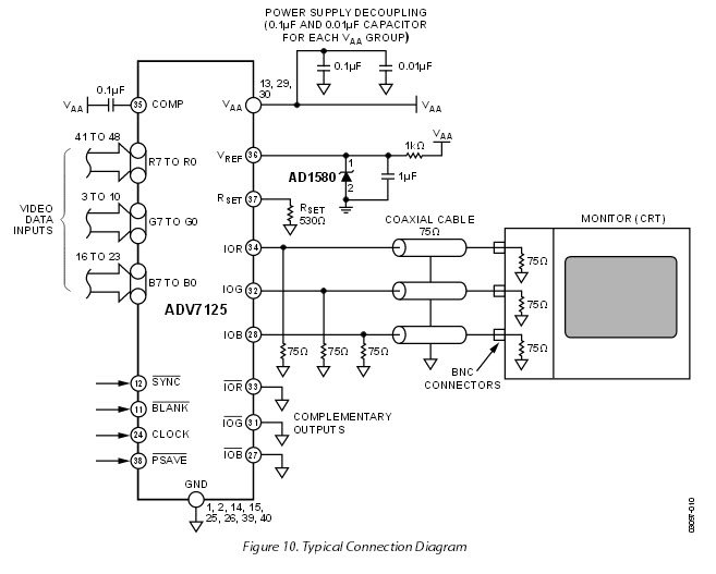

In order to try to improve the performance of PVBV2 some ideas that will be implemented:
1) The 330MHz version of the ADV7125 videoDAC will be used on the final PVBV2 output board.
2) Ground the VGA connector shielding. On the original PVB, it was not grounded, only pins 5 and 10 were grounded. :roll:
3) Use inductors on the RGB output stage from the ADV7125 to the VGA connector. I had followed the ADV7125 Datasheet for PVB, a 'typical connection' snapshot from it is below which shows the ADV7125 in action with no inductors present. Below that is a snapshot from Analog Devices CN0282 which shows the inductors, and that CN worked up to 1600x1200 @165MHz.

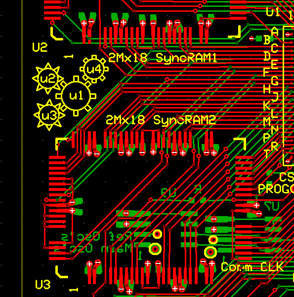

Every board needs a mark...
I was bored today, so I made some imaginary gears into my design. Happy Birthday somebody, heh.

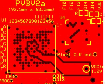

File comment: Updated 3.3v & 1.2v power planes

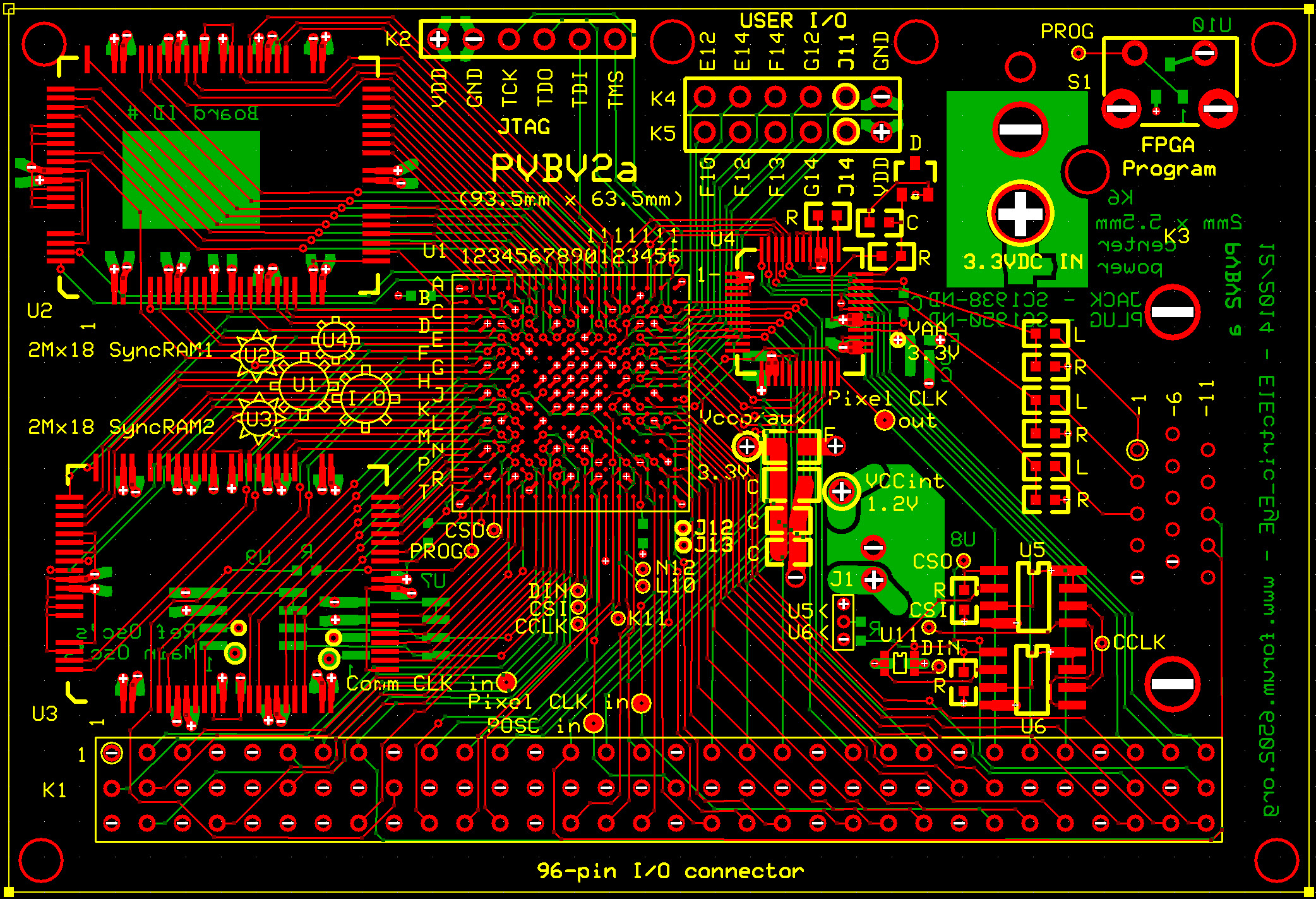

PostPosted: Sun Dec 28, 2014 6:53 pm
I believe the PVBV2a has been finalized.
All the design goals have been reached for this board layout and now I feel like $200 is a price I'm willing to pay to get this thing rolling!
I've added 2 more power planes that are filtered using a ferrite bead and a few capacitors, within the 3.3V main power plane shown at the bottom pic.
One plane is for all the FPGA VCCO/VAUX pads, I count 25. The layout provides for a 0805 ferrite bead, a 0805 cap, and 2 0603 cap's. 6 amp rating of a ferrite bead this size are more than enough, as well as 33uF for an 0803 cap. I decided on a ferrite bead with a rating of 22ohm @100MHz, based on the Analog schematic I had posted above.
The other plane is for the analog 3.3V power of the ADV7125 videoDAC. The ferrite beads and caps are all 0603 sizes as the current demand is much less.
Any critiques welcome! Thank you.

PostPosted: Sun Dec 28, 2014 9:25 pm
Posts: 8539
It appears that all parts are on the top. Is that correct? If so, I think it would be good to put the power layer on the back, so it's not between the signal layers and the ground plane. The power layer has big chainsaw cuts in it, making it unsuitable as a plane layer for any signal traces that cross the cuts. I think your ground plane is continuous though, right?
PostPosted: Sun Dec 28, 2014 11:16 pm
It appears that all parts are on the top. Is that correct? ... I think your ground plane is continuous though, right?
Correct, but I can't change layer assignments. I think it's SIG-POW-GND-SIG. I'm just going to have to go forward and hope for the best.

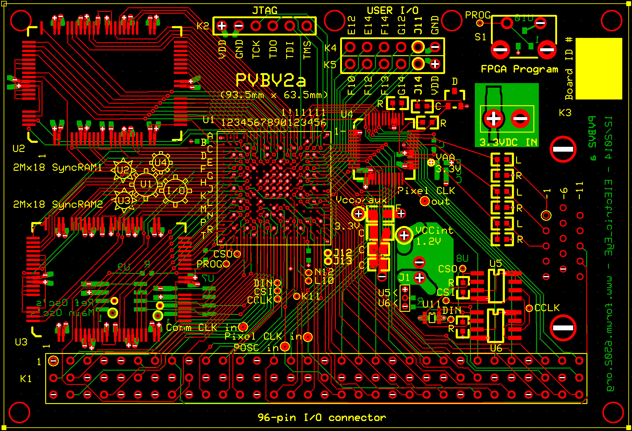

PostPosted: Mon Dec 29, 2014 8:07 pm
Garth, I interpreted your 'jagged' comment to mean diagonal so I tried to come up with a better layout:
File comment: Internal 3.3V main, 3.3V filtered for FPGA Vcco/aux and 3.3V filtered for videoDAC 3.3V VAA, and FPGA 1.2V planes.
