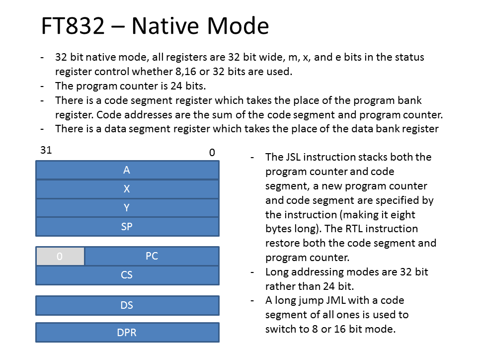

I've copied the FT816 core and am adding 32 bit support to create the FT832 core. It will be backwards compatible. As suggested by others on the board, the FT832 will have all 32 bit registers in native mode. The program bank register is turned into a code segment register, and the data bank register is turned into a data segment register. In order to switch to emulation mode from native mode a long jump JML instruction will be used that specifies both the program counter and code segment. In this case the code segment value will be $FFFFFFFF to switch to 8 bit emulation or $FFFFFFFE to switch to 16 bit emulation. The reason a jump instruction is used because the code segment needs to be zeroed on the switch, and the programs execution address forced to a known value. In native 32 bit mode the eight bit displacement instruction will be shifted left twice before put to use. This will allow more efficient use of zero page (extending it to 1kB). Also in native mode long address mode instructions are 32 bit addresses rather than 24 bit. Otherwise the instruction set remains the same. It is necessary to flip bits in the status register to get byte or 16 bit operations from native mode.
