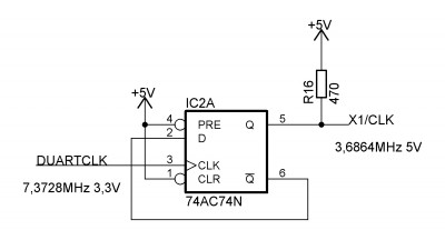

I’ve come up with a solution to ease myself with leaving two options open to use on the circuit board. Given all the information I find the flip-flop the most appealing.
As a backup option, I’ll leave room for a crystal and two capacitors.

I suppose the Flip-Flop uses a VCC=5V, so I think you better use a 74ACT74 so the 3.3V Logic Levels will be clearly recognized as high level. The AC only version are a bit tight, they need 3.15V at VCC=4.5 and for higher VCC it will be clearly more than 3.3V. The ACT version will recognize 2.0V as High Level regardless of Supply (4.5 to 5.5V). You also don't need R16.
Peter
Re: MARC-2 project
+1. CMOS already pulls up pretty much all the way to its positive power supply rail. 74ACT is also quite a bit stronger than 74HCT. The resistor is only recommended if you have to use something like 74xx TTL or 74LS.
Thanks, your right. I have the 74HCT74 here at home. If it won’t suffice, I have to search for a place where to buy a few ACT’s as a private person. I normally order from http://www.rechelt.de. They don’t have a lot of special or rare parts, but for the most parts they’re quite fast and not too expensive.
OK, I wasn’t sure about R16, it was mentioned in the datasheet, so I added it for the case it would be needed.
Marco
It appears that Reichelt doesn't stock anything in 74ABT or 74ACT. As it is expected to only drive the xCLK input of the 26C92, I don't think you need to get too excited about how hard the 74HCT74 drives its output.

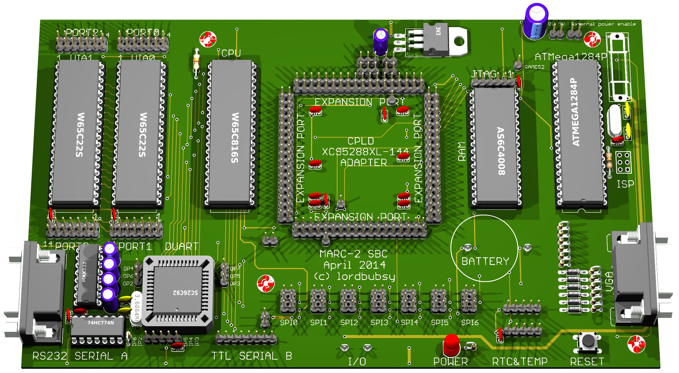

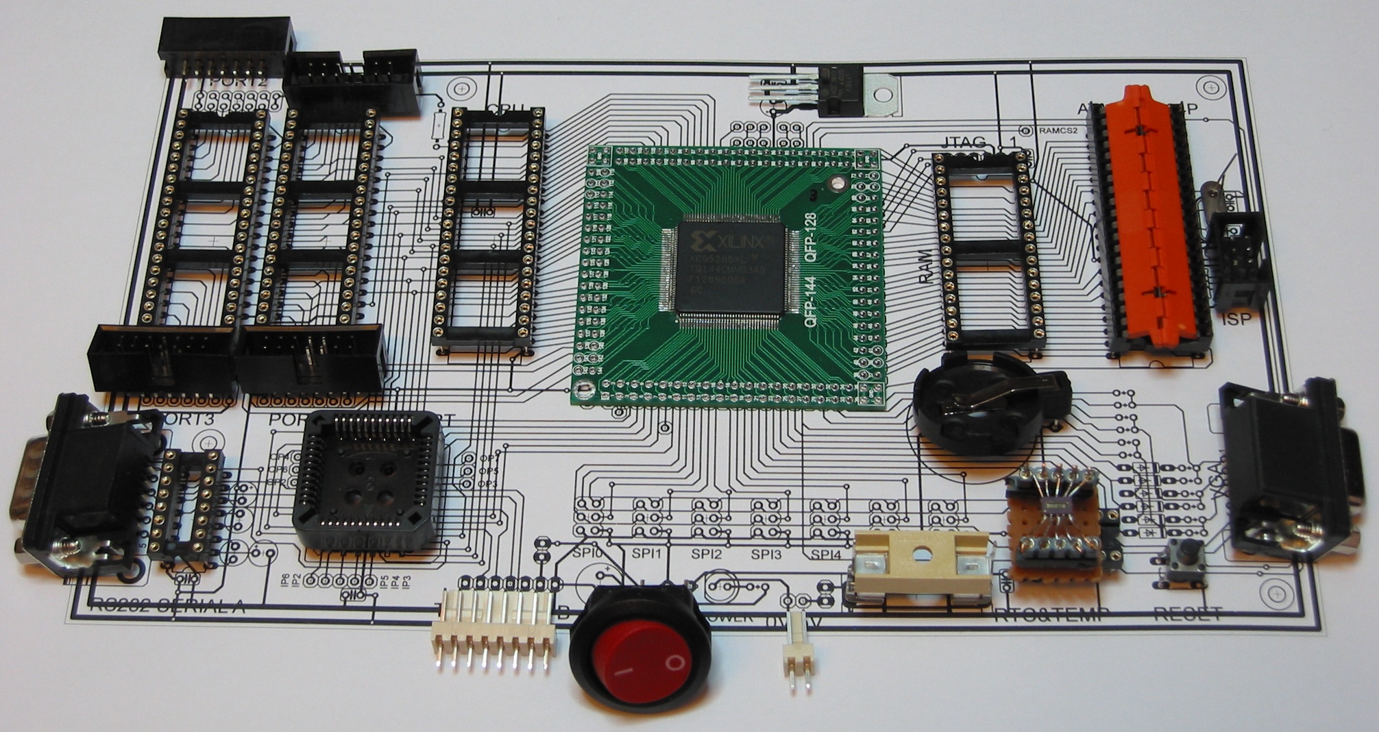

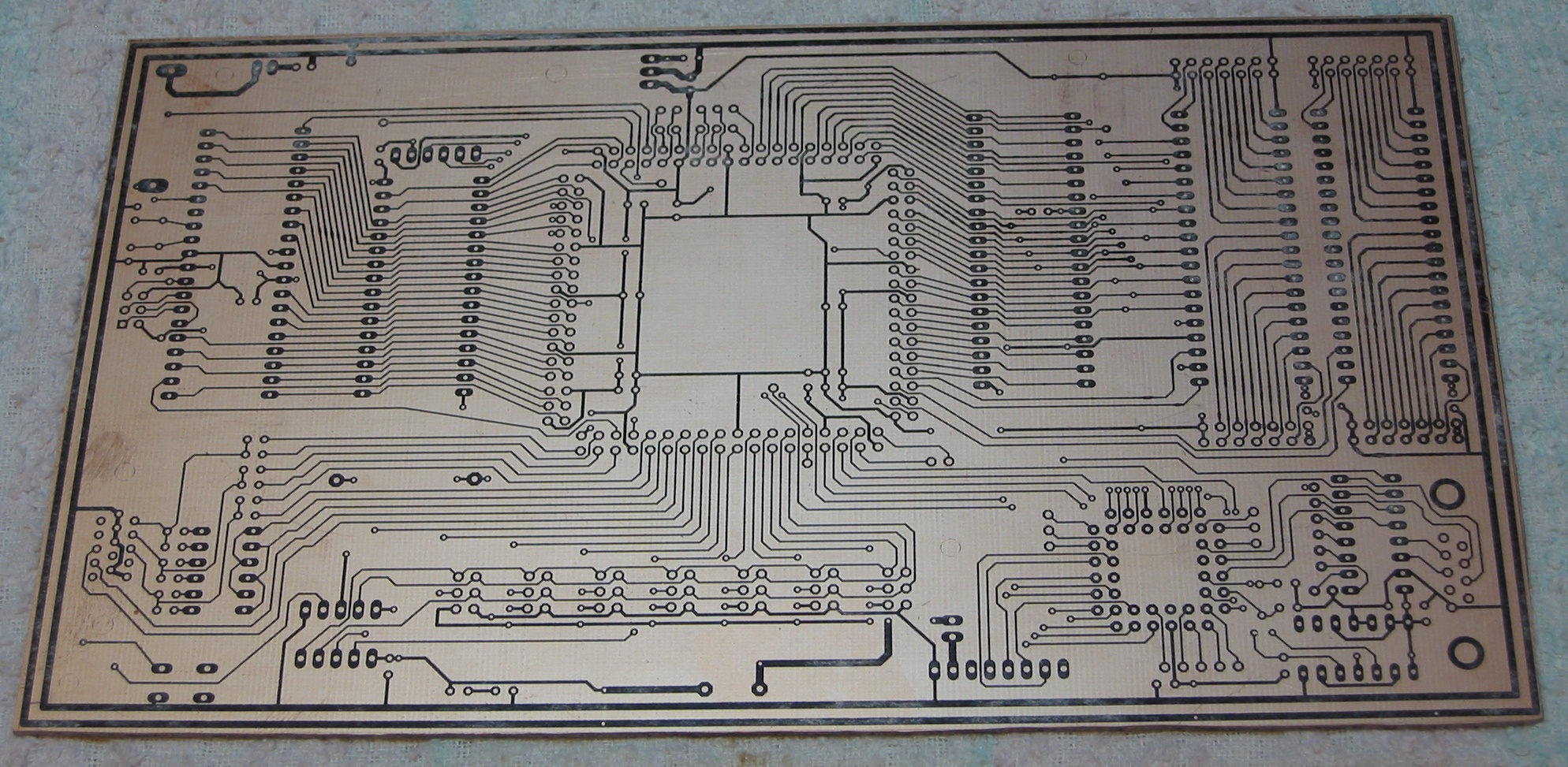

MARC-2 is taking shape.
• The system is based on the W65C816.
• It is ROM-less with 512 KiB RAM.
• All pins of the CPU and RAM are connected individually to the CPLD, a Xilinx XC95288XL 144 pin. The CPLD will also provide 65SPI and VGA.
• The ATMega1284P provides RESET, master clock and the firmware to the RAM during RESET.
• The DUART, a SC26C92, provides RS232 serial and TTL serial.
• There are two VIA’s for future expansion.
• One of the eight 65SPI interfaces is used for a Real Time Clock with environment temperature sensor, a RV-3049-C2.
Initially I’ll try to get the computer going by only using the TTL serial port which also provides the 5V power. Later on I’ll add 65SPI and VGA. The CPLD should have enough resources to do even more.
At this moment the PCB is etched and all holes are drilled. Next, I have to solder the vias by hand and check all traces.
Marco
