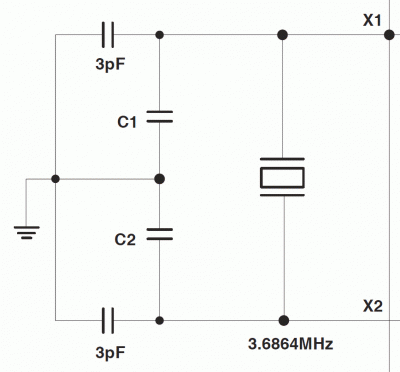

Thanks for the article.
A crystal with two 22pF caps is what I also use with my AVR projects for years without any issues.
Marco

A crystal by itself won't oscillate; but if your UART has an onboard oscillator (like many microcontrollers do) and is made to just hang a crystal off it to control the frequency, then there's nothing wrong with that. A capacitor from each side of the crystal to groung is commonly needed.

 Post subject: Re: MARC-2 project
PostPosted: Sat Apr 12, 2014 9:20 pm
Posts: 8514
Figure 7 on page 24 of the 26C92's data sheet shows the hookup for using a crystal as the frequency source.
File comment: Figure 7: 26C92 Oscillator Circuit
C1 and C2 are dependent on the crystal used. I can't vouch for the performance of this circuit, as I haven't tried it.
I used a crystal with the 26C92 when I first started using the chip.
After a few weeks the UART began screwing up rx/tx data. It took me a while to figure it out. :twisted:
As a last resort I switched to a half can osc. and my troubles were over. Could have been the crystal was defective, but it was odd that it worked fine for a while.
