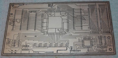

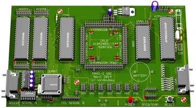

MARC-2 is taking shape.
• The system is based on the W65C816.
• It is ROM-less with 512 KiB RAM.
• All pins of the CPU and RAM are connected individually to the CPLD, a Xilinx XC95288XL 144 pin. The CPLD will also provide 65SPI and VGA.
• The ATMega1284P provides RESET, master clock and the firmware to the RAM during RESET.
• The DUART, a SC26C92, provides RS232 serial and TTL serial.
• There are two VIA’s for future expansion.
• One of the eight 65SPI interfaces is used for a Real Time Clock with environment temperature sensor, a RV-3049-C2.
Initially I’ll try to get the computer going by only using the TTL serial port which also provides the 5V power. Later on I’ll add 65SPI and VGA. The CPLD should have enough resources to do even more.
At this moment the PCB is etched and all holes are drilled. Next, I have to solder the vias by hand and check all traces.
Marco
 Post subject: Re: MARC-2 project
PostPosted: Wed Apr 23, 2014 9:36 pm
Posts: 8514
I like your illustrations. What software do you use to render them?
