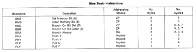

Let's see how the R65C19 differs from a 6502:
- (indirect,X) becomes (indirect)
- (indirect),Y becomes (indirect),X
- extra instructions - see below - for support of threaded interpreted languages, for arithmetic including multiplication, swap, multiple register push and pull, one-byte subroutine calls (8 available, vectored through ROM)
- 16-bit I register to support threaded interpreted code
- 16-bit W register to support multiply-accumulate
- six levels of IRQ each with their own ROM vector, also (configurable) RAM vector
- JSR and RTS stack the actual return address, and are both 1 cycle faster
- 512 bytes RAM on-chip (spread over half of page 0, all of page 1 and half of page 2)
- the stack is, possibly, somehow segmented into four parts
- optional 16k ROM on-chip
- 15-byte dual-ported buffer to allow the chip to act as a memory-mapped peripheral to a host micro
- various on-chip peripherals and extra I/O ports
- up to 44 GPIOs and/or external memory bus
- four pre-decoded chip select outputs for external memory chips
- comes in 64-pin, 68-pin or 80-pin packages
- stop mode and idle mode
- runs up to 8MHz
File comment: Additional instructions on 65C19
File comment: Nine "basic" instructions added to R65C19

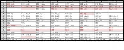

There may be some interest in the opcode map of the R65C19 and how it compares to the R65C02. Pink/Light Red Cells are opcodes which have different meaning than those of the R65C02. Cells with Red Font and a white background are the additions to the 6502 instruction set made by the 65C02. The bit-oriented instructions added by Rockwell are shown in normal black font and a white background in rows 7 and F.
From the map shown in the two attached diagrams, the R65C19 instruction set demonstrates some significant deviations from that of the R65C02/W65C02.
