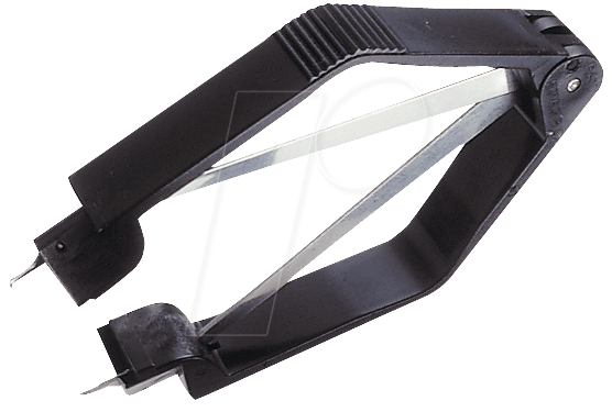

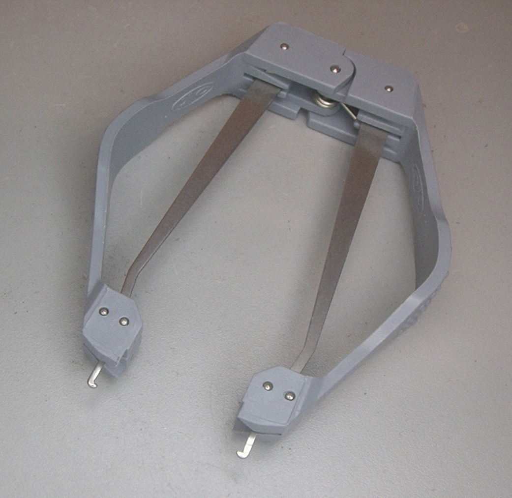

do I *need* a special tool to swap those PLCC44 IC's?
See attached picture. It's a device called PLCC chip extractor that is available through many electronics parts sources. The one I linked is the one I have—I purchased it in 1990 and it's still going strong.
PLCC Chip Extractor

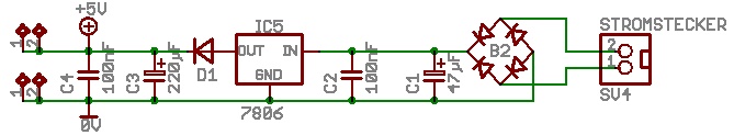

That’s not bad, for a more permanent supply I would use this schematic from a commercial product.

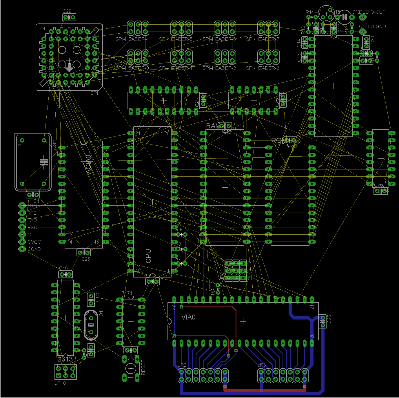

I think I’ll start with the data and address lines. Any suggestions?

What is that large IC in the top right ? Maybe you want to bring that down so that the bus wires can go straight.
Starting with data/address is a good plan, but keep in mind that you may discover that some parts need to be moved, so don't try to make it really nice and beautiful at first. Also, feel free to skip a few if they are regular anyway. So, you could do D0, D1, D4, D6, D7 at first, and fill in the rest later when the placement is finalized.
I also recommend making a ground plane on top and bottom, and start by trying to route your signals on bottom layer. Many folks advocate using a power plane, but for 2 layer boards, I recommend sticking with 2 ground planes, and some fat power traces. The reason is that your signals are going to chop up your ground plane, and if you only have one, you'll end up with a bunch of broken pieces. If you have two ground planes, and a bunch of vias connecting them, they'll work together as one solid plane.

Also, make sure you run a DRC (design rule check) on a regular basis. If you have your boards made professionally, check if you supplier has a .dru file for Eagle that checks against their exact manufacturing capabilities. By doing a DRC in early stages, you avoid having to redo a bunch of work later.

This one will be two layer homemade PCB with use of a laser printer and laminator.
That large IC is the SID :D
The limitation is that I have to make the through holes by hand. I’ll choose free areas for the vias and start traces at the bottom layer of the IC’s. (I hope that makes sense?)

If you're etching it yourself, a DRC is still a good idea. You can fill in values that you feel comfortable with, and then check that you don't have any shorts, or wires too close together.
For a professionally made board with 6 mil trace/clearance and small vias, you can do an awful lot in 2 layers. It's just a bit more work.
Edit: one of the things you can do with 6 mil is route 3 signal wires between two pins at .1" distance, assuming the pads aren't too big.

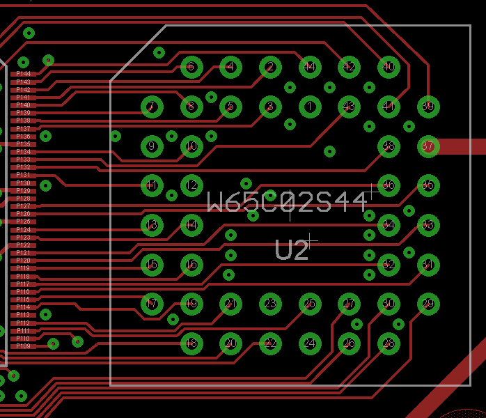

Here's an example from my 6502 sandbox board. All signals from the socket are routed on top layer. Of course, they're going into an FPGA, which allows arbitrary pin swaps, so that helps a lot. The bottom layer only has ground, bypass caps, and a fat power trace. Also note plenty of vias connecting top/bottom ground layers.
