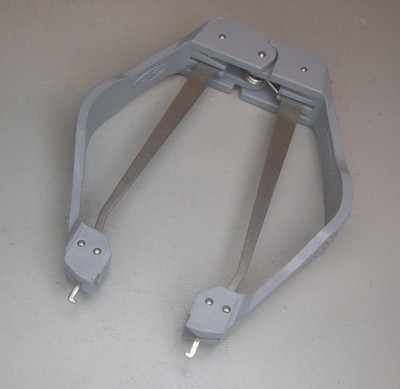

do I *need* a special tool to swap those PLCC44 IC's?
See attached picture. It's a device called PLCC chip extractor that is available through many electronics parts sources. The one I linked is the one I have—I purchased it in 1990 and it's still going strong.
File comment: PLCC Chip Extractor
