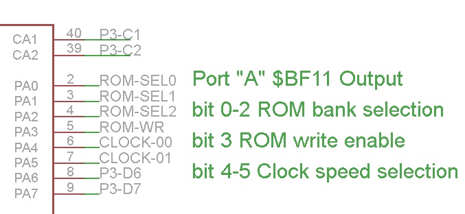

I’d like to choose one of the VIA ports as a configuration register. I want to take the port with lesser value. Which one could I use?
I'm not sure what you mean by "configuration register," but I view PA as having slightly less value than PB (because of capabilities).
I want to use that register to determine certain system settings.
At Startup I want to configure port A of VIA1 as output. The bits 0-5 are connected to an AVR. The AVR scans those bits continuously.
The AVR is also connected to the Flash memory’s A14, A15 and A16. Which selects the ROM bank.
Bit 3 enables or prohibits writing to flash. I added also a jumper as you suggested. Bit 4 and 5 determines the clock speed which is provided by the AVR. It will give the following frequencies:
00 14,7456
01  7,3728
10  3,6864
11  1,8432
They go through a 74AC74 and the system can run on those frequencies, divided by two:
00 7,3728
01 3,6864
10 1,8432
11 0,9216
According to your RS-232 primer, the 6551 could accommodate a baud rate of 115200 with a PHI2 of 7,3728 MHz.
