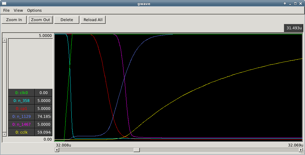

Hello everyone, long time no see )
Please help me to analyse this circuit :
And logic representation :
The problem is following: as you know, PHI1/PHI2 is lag a little over input PHI0. But 6502 documentation says PHI1/PHI2 also have a slighty extended low period, to ensure that PHI1 and PHI2 are never high at the same time.
Can someone simulate this circuit and check for PHI1/PHI2 timing diagram ?
It should be someting like that :
6502 addict
Re: Breaking 6502 apart
Hi Org
please check against this circuit, which looks more plausible: viewtopic.php?f=1&t=2412#p24074
I followed the instructions at viewtopic.php?p=13550#p13550 and was able to capture these images of a simulation of the 6502 netlist (as found in Peter Monta's github project):
The nodenames & numbers are from the visual6502 netlist.
org
Posts: 201
Joined: 22 Jun 2012
Post by org »
My friend, more enlightened in the hardware stuff said it is "asymmetric cascade inverter", which delays the rising edge, so it seems that the lower level of PHI1/PHI2 is longer than the upper.
This mean Balazs clock envelopes are slighty incorrect.

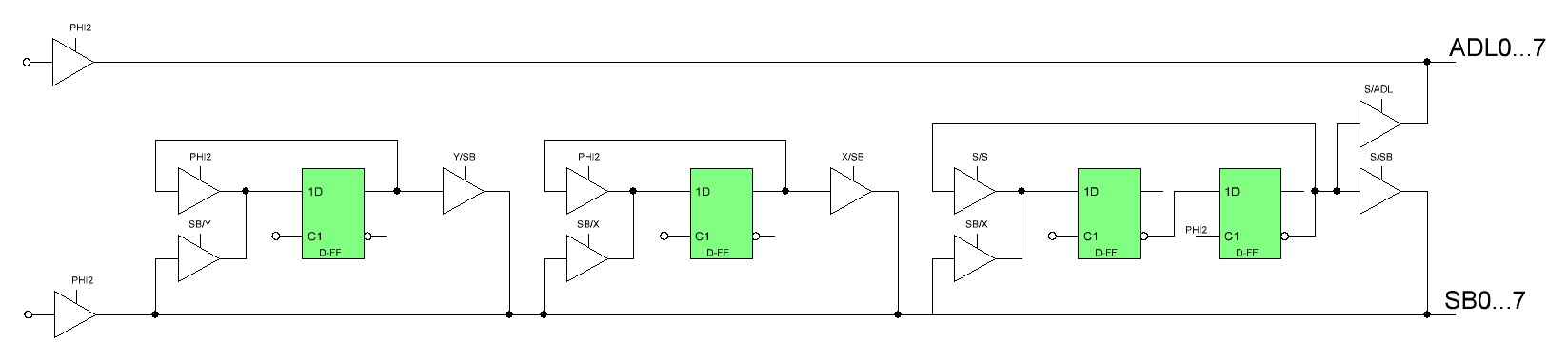

Hanson's diagram shows SB also connecting to ADH through pass gates...
org
Posts: 201
Joined: 22 Jun 2012
Post by org »
It exist :
6502 addict
Oh! I didn't see it...

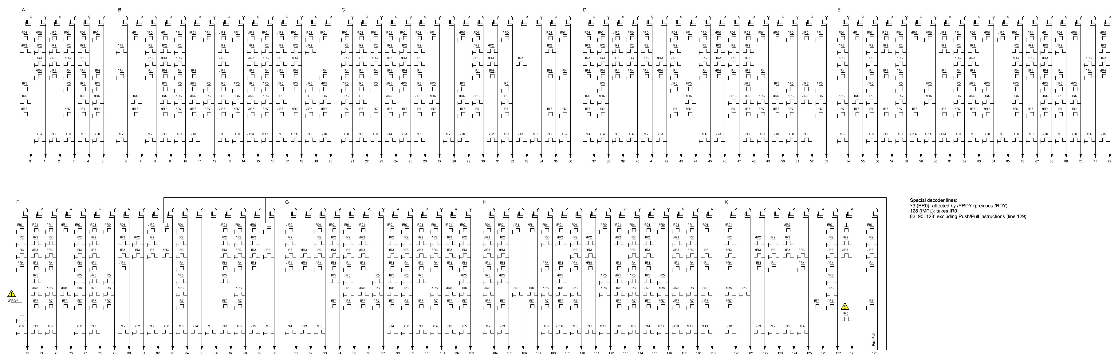

Post by org »
Nice decoder circuit.

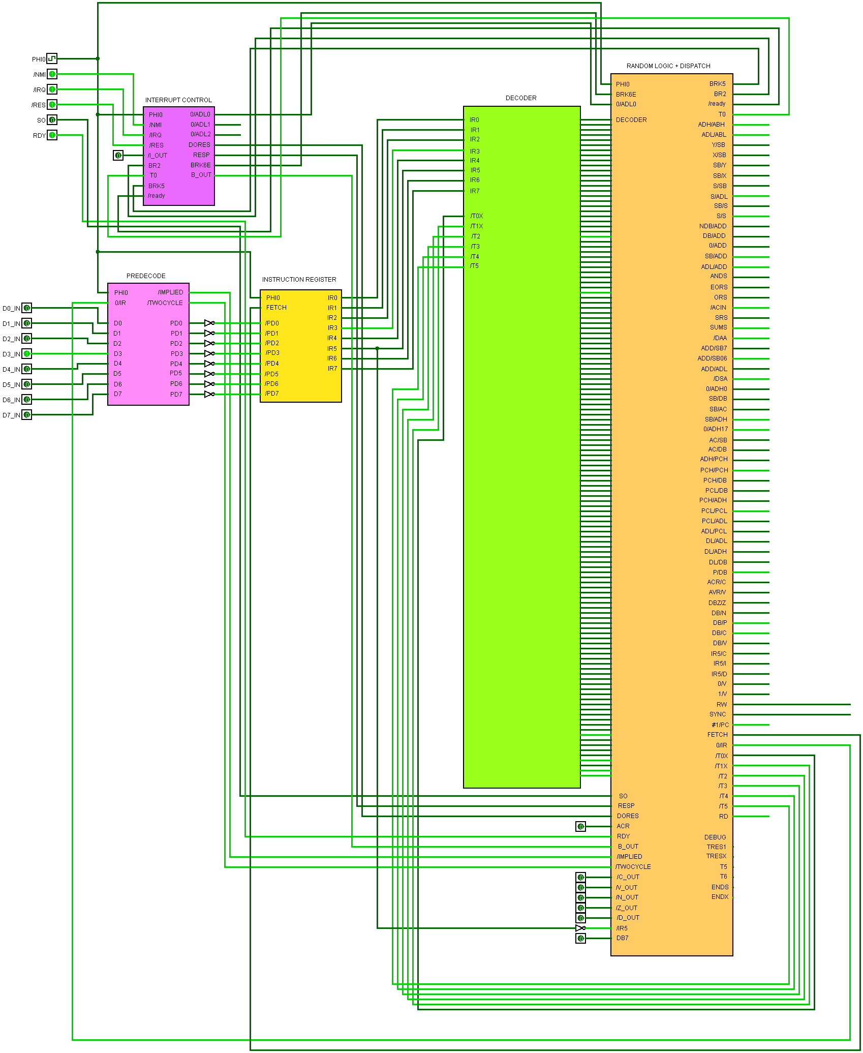

6502 addict
org
Posts: 201
Joined: 22 Jun 2012
Post by org »
Here we go !
Complete top part 6502 simulation in discrete logic elements!
https://code.google.com/p/breaks/source ... ANDOM.circ
Enjoy :mrgreen:
Sadly its impossible to simulate full 6502 in Logisim, since it doesn't support bidirectional wires and I have no clue how to implement bus-to-bus connections there.
I'm going to implement it in Verilog, check on CPLD and rewrite on C, for my emulator project.
PS. I fixed some bugs in random logic, check updated version in attach.
