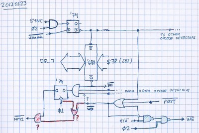

I don't want to rain on your parade, but it's unlikely that you could implement the required logic using discrete devices and achieve sufficiently fast operation to actually stop a memory or I/O access from occurring.
What you are trying to accomplish in the case of the 'C02 is something like what the '816's abort interrupt does. Despite the name, an abort interrupt doesn't actually abort the instruction. However, when asserted, the '816's ABORTB input does behave somewhat like an NMI, but pushes the address of the aborted instruction instead of PB and PC, and inhibits any changes to registers or memory, which would prevent an illegal access on memory or I/O. Even with the '816's ABORTB input it takes additional—and very fast—logic to determine if an illegal access has been attempted, key word being attempted.
There are two steps to this process: detection of illegal opcodes (BTW, how do you plan to deal with STP?) and detection of improper addresses. The first comes during the opcode fetch cycle, indicated with SYNC on the 'C02 and VDA & VPA on the '816. That's the easy part.
The second part isn't quite as simple. The '816 provides a distinct signal for that purpose: VDA—the expression VDA & !VPA indicates that the effective read/write address is on the bus. No such equivalent exists with the 'C02.
The key here is that I won't prevent illegal accesses, but only illegal writes. Since such operations are qualified (typically by ø2), I've got some time for it :mrgreen: I'm aware that some reads to peripheral devices may be dengerous (like clearing interrupts, etc) but they're usually harmless...
Can't tell for sure because I haven't build this circuit yet, but... a picture is worth a thousand words:
File comment: Illegal instruction/access protection circuit for 6502
The only specific signals here are:
  • KERNEL\ is active (low) when the current address is in kernel space -- can't really talk about user/supervisor modes on a 6502. Instructions fetched when this signal is active, have no restrictions at all.
  • PROT\ is active (low) when the current address is in protected space -- maybe I/O devices, system variables of whatever zone must be protected from direct user alterations.
Both signals may be easily derived from the address decoding logic. This circuit generates two internal signals (SEI\ and WD\, more on them later) but the rest is regular 6502 stuff.
First of all, for each fetched instruction it's decided whether it has full privileges or not -- by latching the state of KERNEL\. Clocking the flip-flop by SYNC alone won't work, because this one changes more-or-less at the same time as the address lines, and KERNEL\ derives from these -- after the delay from decoding logic. Thus, SYNC is gated thru ø2, when all addresses and decoding are expected to be stable.
Whenever an instruction in user space is fetched, the protection devices get enabled... for the illegal instructions, it may be as simple as a '688 comparator: one side of it goes to the data bus, the other is hardwired to the desired "illegal" opcode -- for instance, $78 for SEI, which would ruin preemptive multi-tasking if accidentally executed. However, as soon as this comparator is enabled, data may not be correct: that's only guaranteed a bit before the end of the cycle. That's why I put another flip-flop at the comparator's output, getting updated by ø1 -- in other words, when ø2 goes down; data will be hold a slight time after that, more with propagation delays.
The "problem" with this second FF, is that the NMI will be triggered just at the beginning of the following cycle, being acknowledged after that second instruction ends... but that's not much of an issue, because the process will be throw off anyway -- or that should do the NMI task! The AND gate before this second FF allows for several NMI sources to be latched this way; some other "illegal" opcodes (WAI, STP...) could be detected as well with more '688s in parallel, each output to its corresponding AND input.
Then, the illegal write protection is actually simpler than expected! You can see, tinted green, the typical write-validation circuit... but instead of using the first NAND as a simple inverter, it's actually used to disable writes via the internal signal WD\. This signal comes from the OR gate, and goes active when all of the following is happening:
  • The current instruction was outside kernel space
  • The address being accessed is considered protected
  • The CPU wants to write something
The first condition is indicated by the first flip-flop, possibly several cycles ago... the second one may be somewhat indefinite while the address lines are changing, but it'll definitely settle by the time ø2 goes up. The last one comes directly from CPU, and was stable even earlier.
While WD\ is asserted, no write operations into memory can take place, but the NMI must be issued. First I thought about the circuit in red, which blocks this NMI source until ø2 goes up (or ø1 goes down, actually). However, I think it isn't necessary: this WD\ could take one AND input (see dotted line) just like another illegal opcode, with the usual drawback... an extra instruction will be executed before the NMI is called, but this is rarely an issue.
Now that I think about it, this circuit prevents unauthorized writes to memory, but not to a I/O device like the 65C22... but it is possible to connect the VIA's CS2 line to WB\ for the same effect. Or maybe disabling the whole I/O decoding.
An interesting improvement to this circuit would be latching the cause of interruption: from the state of WD\, SEI\ or whatever opcode is protected. Then the NMI could check this protection device register and take appropiate measures, according to the "exception" origin :wink: This could even help with the STP instruction... yes, it certainly cannot be aborted and the computer will be halted. But after restarting, if the RESET routine looks for a 'STP interrupt' on the cause-register ASAP, it could just go straight to the NMI handler, instead of the usual (destructive) initialization. That would kill the offending process, resuming normal operation of the system after a few seconds of inactivity...
There's still some time to go, before I actually implement this -- both hardware and software. But I'm doing all this just for fun, and there's no need to put a brake to imagination... only time will tell how far can I go :wink:

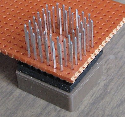

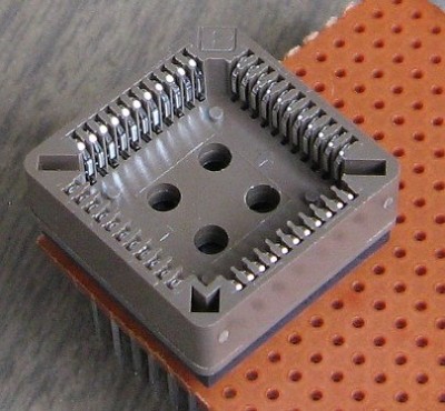

Thanks to Ed for this link for buying wire-wrap PLCC sockets:
http://uk.rs-online.com/web/c/?searchTe ... ra=oss&r=t
However, I think those pins are like the pin-header ones, of square section... it seems they won't fit a breadboard (at least, not mine)
They fit in standard prototyping board that has the holes on .100" centers-- otherwise it wouldn't really be any good for wire-wrapping. I have some here, and grabbed a tiny scrap of cheap prototyping board to take these pictures:

Hello, zuiko21, and (belated) welcome! Regarding your protection scheme for the 'C02, it's clear you have an imaginative approach to hardware design! The project you describe is one which will put your skills to the test. :)
A word of warning about SYNC. This pin is not 100% reliable as an indicator of what instruction is about to be executed. An exceptional circumstance arises when the CPU begins an interrupt sequence. SYNC will be high but the instruction being fetched will not execute. More details on that behavior are here, and (as part of a larger circuit) an XOR arrangement that detects the beginning of an interrupt sequence is here. Will the false SYNC be a potential problem for you? The interrupt sequence will try to push some stuff to stack and then jump via the interrupt vector. Your hardware must allow this (regardless of any protection associated with the instruction that was fetched and discarded).
As for opcodes such as SEI, there's an alternative to your approach of taking corrective action (via an NMI) after the deed is done. The alternative is to re-map SEI (and any other opcodes of interest) before they execute, and turn them into BRK instructions. There's a circuit for re-mapping instructions here. It leverages the power of programmable logic (as suggested by BigDumbDinosaur) but the device used is merely an EPROM. In your case you need to turn the re-mapping on and off, and that could be done with one of the unused address lines. The scheme is nice and simple but the access delay of the EPROM needs to be considered. (Unless the EPROM is a fast one, you may need to compensate with a slower CPU clock, faster RAM, or a wait state.)

PostPosted: Sat May 25, 2013 1:37 am
Posts: 8403
A "false sync" condition also occurs with the 65C816 at the start of interrupt processing. In this case, VDA & VPA is true, implying that an opcode fetch is in progress. The byte being fetched is whatever is being pointed to by PC at the start of the interrupt sequence, but it doesn't appear anywhere.
While they're great (and intended!) for wire-wrapping, I'm afraid they won't fit solderless breadboards, neither turned-pin sockets :( Pins are too thick for them!

I've noticed some errors in my circuit:
zuiko21 wrote:
First of all, for each fetched instruction it's decided whether it has full privileges or not -- by latching the state of KERNEL\. Clocking the flip-flop by SYNC alone won't work <snip>
While this part of the circuit is OK for the I/O & protected memory access section, it's not for the illegal opcode detection -- it'll keep checking all the bytes of any instruction in user space, thus things as innocent as:
CMP #'x'
will trigger the SEI warning :( Fortunately this is very easy to fix: the ENABLE\ pins on the '688s shouldn't be driven by the aforementioned flip-flop, but from a NAND gate taking SYNC & KERNEL\ as inputs.
Originally, I had the WD\ (Write Disable) signal to inhibit the WE\ (Write Enabled) signal to RAM, which should work for Intel-style interfaces too. 65xx I/O hardware shold not just have their R/W lines disabled, because bus contention would happen. And while some of them have alternative Chip Select lines for full disabling (like CS1 on a 6522 VIA, CS0 on the 6551 ACIA), some others (2651 ACIA) may not. I think it's best to just generate a generic DIS\ (Disable) signal and let the computer's glue logic to inhibit devices as convenient -- maybe just disabling the decoders, but then make sure that the PROT\ signal stays valid, or let the circuit generate it from the address bus.
Thanks for the warning! I have drawn some timing diagrams, and it seems that it won't be an issue...
Well, there is actually a suspicious case: when the opcode following the illegal instruction is yet another privileged opcode... on the first cycle of the interrupt sequence (with SYNC anomalously active) this will be on the databus, being detected by the corresponding '688 and triggering a second NMI pulse during the second cycle of the sequence :?
I don't know what the response of the CPU about this second NMI will be in such an early stage of the interrupt sequence... if it's just ingnored, great! :D If not, the worst case scenario I can think is that a second NMI is executed over the first and pending call; that second call will manage the "exception" and clear the appropiate register (indicanting the cause of interrupt). And then, just after killing the offending process and giving control back to the rest of the system, the pending NMI gets executed -- as it will find the "exception register" clear, it would likely assume that it was an user-generated NMI (the button was pressed!). Then it would be just a matter of issuing the debugger command for returning to system -- provided that a human being is at the computer :wink:
That's simple: stack space cannot be considered protected by my circuit. Otherwise, ther would be no way to call subroutines, including kernel calls!
It's a really elegant and simple solution! And could be particularly versatile in some applications.
However, as you already mentioned, it could be a speed-limiting factor, even with state-of-the-art (E)EPROMS. Plus, it really has to be integrated in the design, while my circuit could be used as an optional add-on -- it just sniffs on the busses and supply the NMI\ (usual) and DIS\ signal. The latter must be considered by the system, but could be something as simple as hooking it to an active-high Enable signal (with a pull-up). My next computer in the road-map, designed more for versatility and reliability than speed (2 MHz) uses a '138 for qualifying all signals; could use that for disabling devices.
