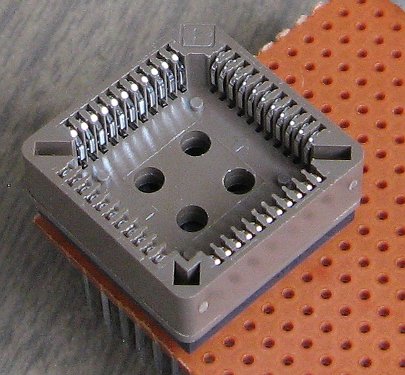

I want to test some W65C816S and W65C02S I purchased -- PLCC version, so no breadboarding possible :(
Thanks to Ed for this link for buying wire-wrap PLCC sockets:
http://uk.rs-online.com/web/c/?searchTe ... ra=oss&r=t
However, I think those pins are like the pin-header ones, of square section... it seems they won't fit a breadboard (at least, not mine)
They fit in standard prototyping board that has the holes on .100" centers-- otherwise it wouldn't really be any good for wire-wrapping. I have some here, and grabbed a tiny scrap of cheap prototyping board to take these pictures:
While they're great (and intended!) for wire-wrapping, I'm afraid they won't fit solderless breadboards, neither turned-pin sockets :( Pins are too thick for them!
