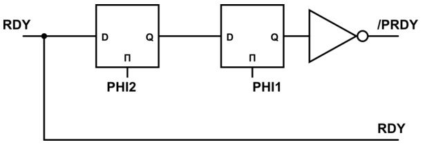

Ugh... "E" mean "edge" ))) I need to redraw it again )

"E" usually means "enable."

I used russian letter "П" as level-triggered input)
If you understand russian, I have detailed description of these circuits here : http://breaknes.com/info/6502_top

Back to the E! It's recognised as meaning Enable.

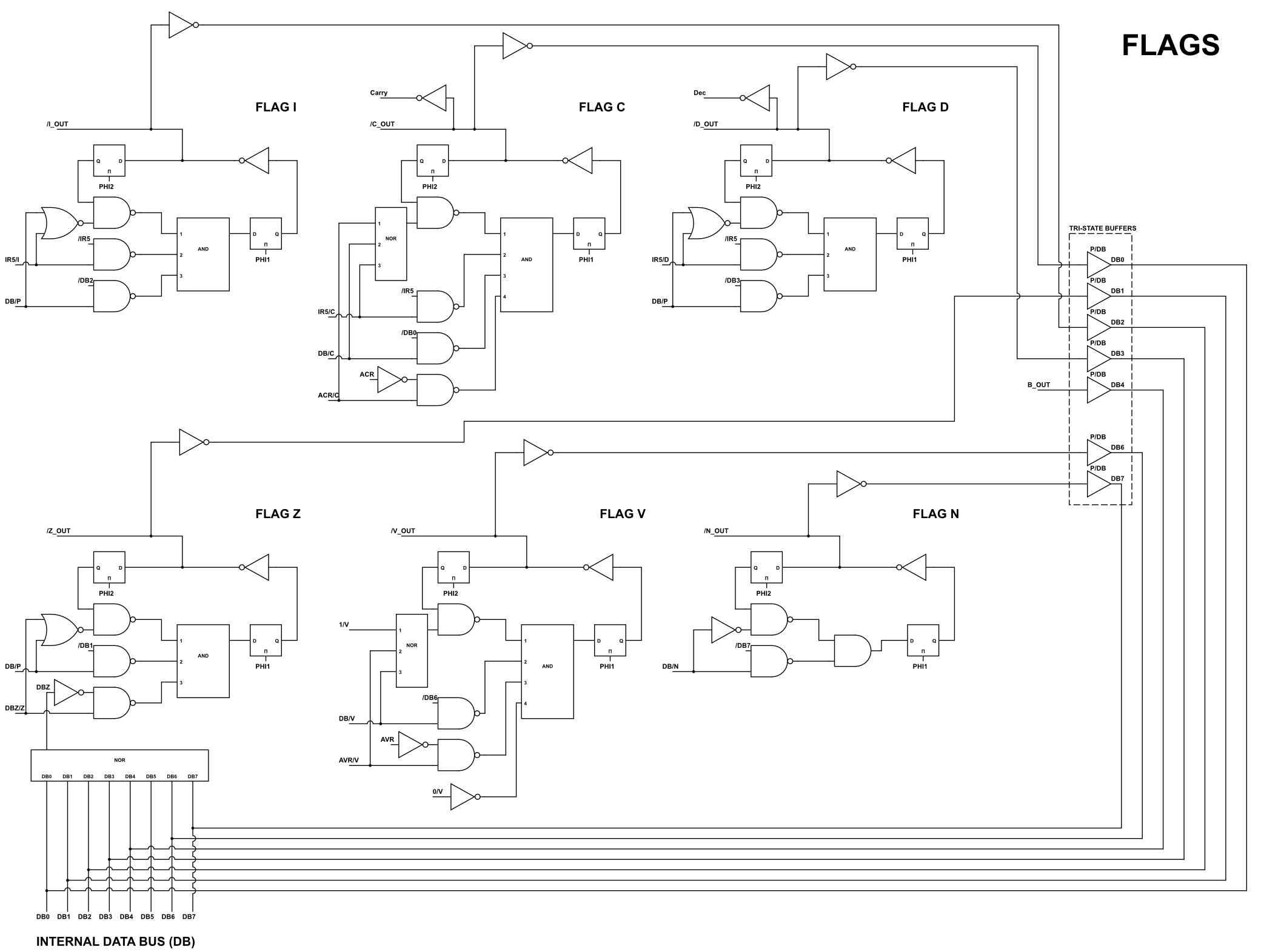

Re: Breaking 6502 apart
Post by org »
Todays speccy : flags.
This circuit is controlled by random logic, by following commands:
DB/P : load I, D, Z flags from internal data bus
IR5/I : used to handle SEI/CLI instructions
IR5/C : used to handle SEC/CLC instructions
DB/C : load C flag, from internal data bus
ACR/C : put ALU carry out to C flag
IR5/D : used to handle SED/CLD instructions
DBZ/Z : put ALU zero result to Z flag
1/V : forced whenever input pad SO is set
0/V : used to handle CLV instruction
DB/V : load V flag, from internal data bus
AVR/V : put ALU overflow out to V flag
DB/N : load N flag, from internal data bus
P/DB : enables tri-state buffer, to connect flags output with internal data bus.
B flag is located in interrupt handling circuit, on the left side of 6502.
Flags circuitry is rather simple. We have sync'ed latch, with NAND cutoff, whenever random logic issues any command to this flag (NOR gate).
Random logic commands reload latch, corresponding to new source value.
If we do not have any commands, cut-off NAND works as simple inverter, to reload output latch by old value.
Note, that flags output is in inverted logic, so it gets reinverted back again, before connecting output with internal data bus.
Phew)

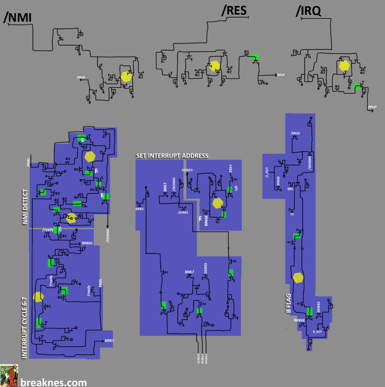

Post by org »

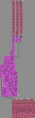

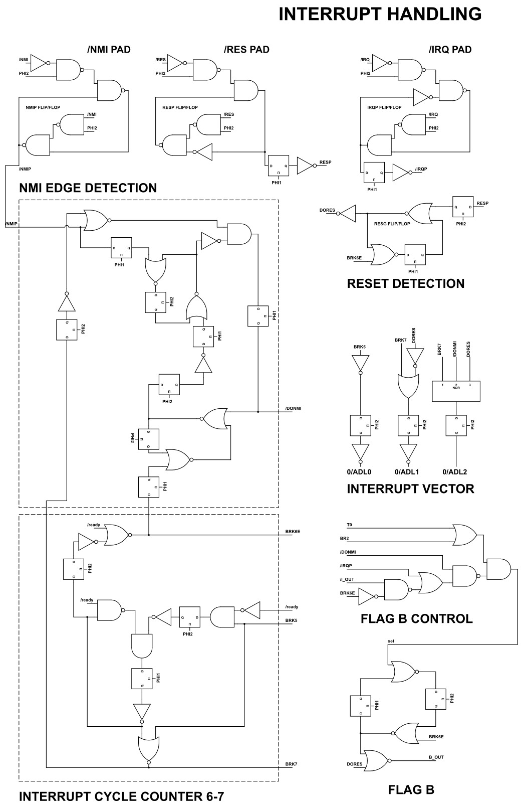

Todays speccy: interrupt handling circuits

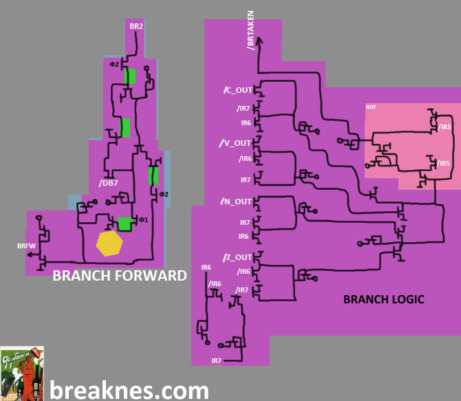

Post by org »

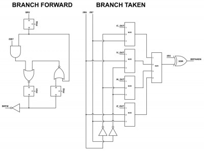

Todays speccy 2: branch logic

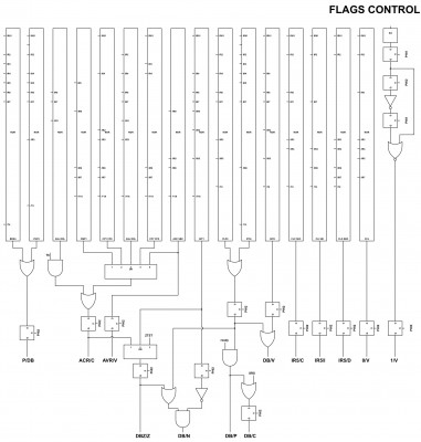

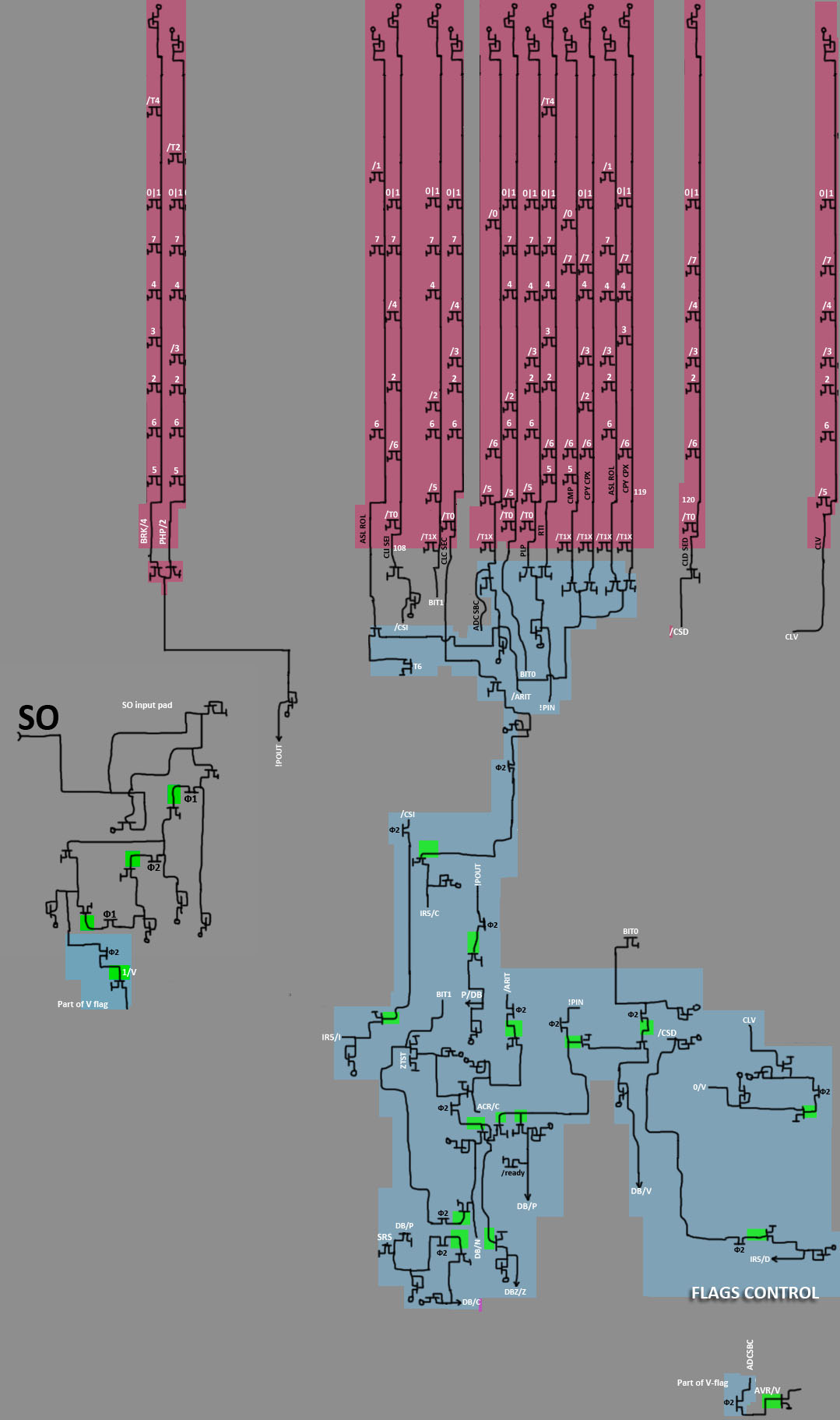

Todays speccy: flags controls (including SO pad logic)

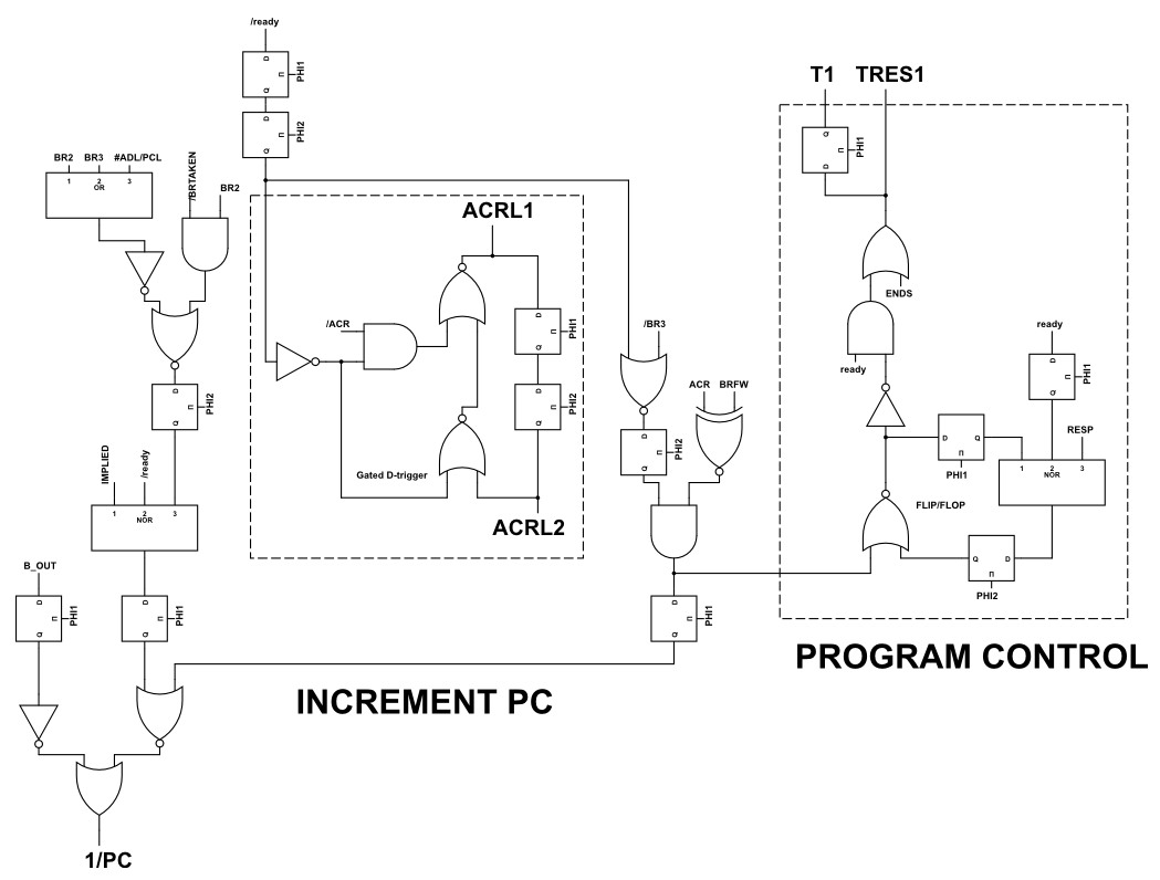

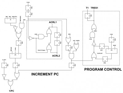

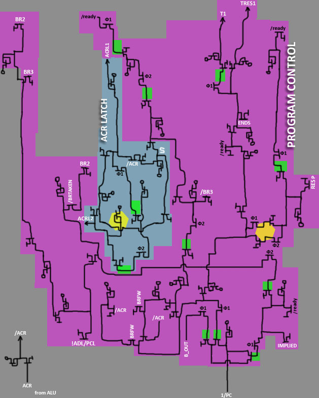

Post by org »

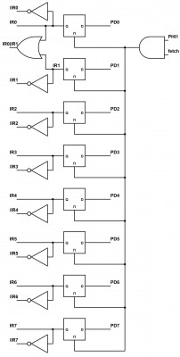

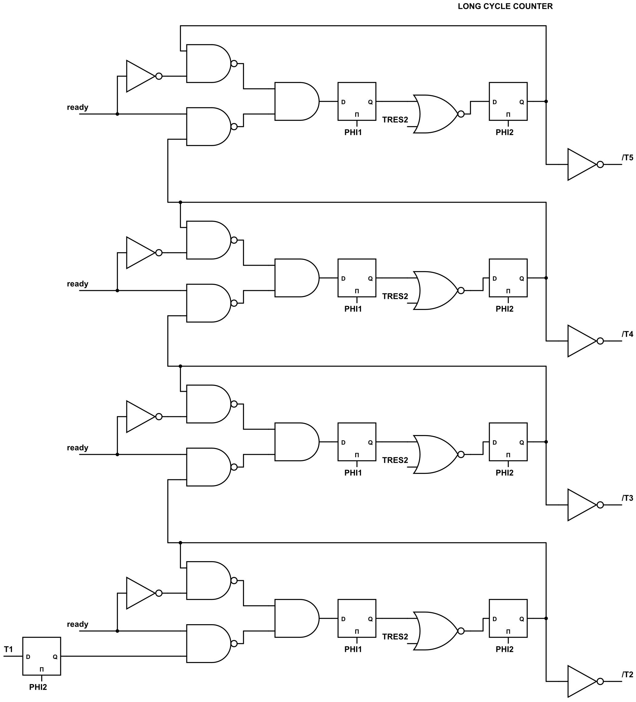

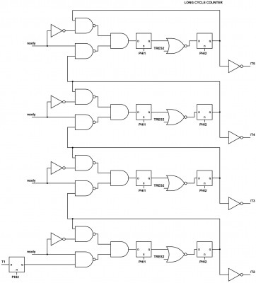

Todays speccy: program control

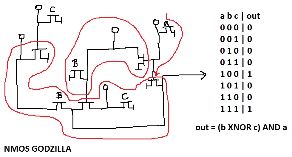

And some vintage tricks from MOS engineers :)

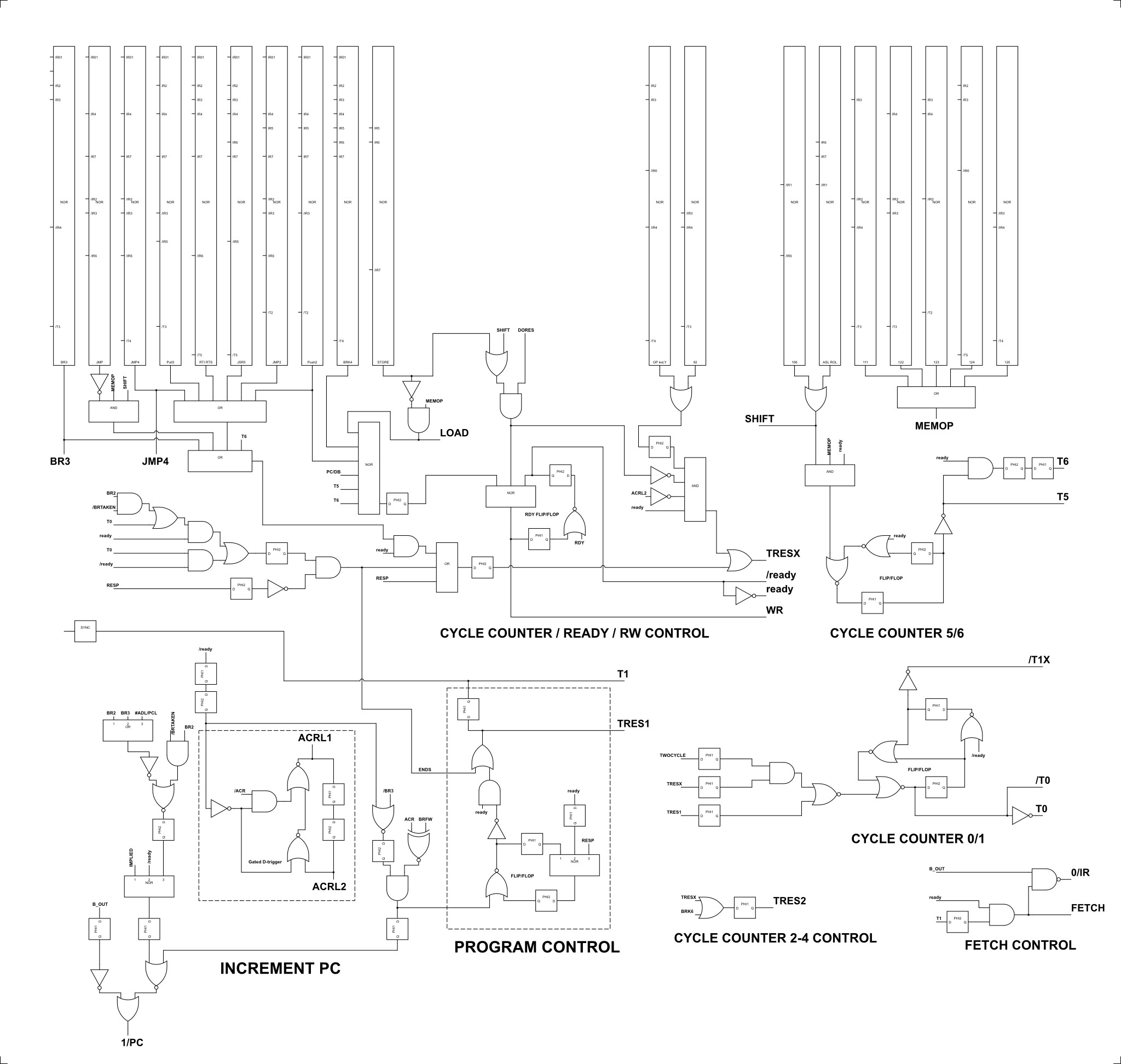

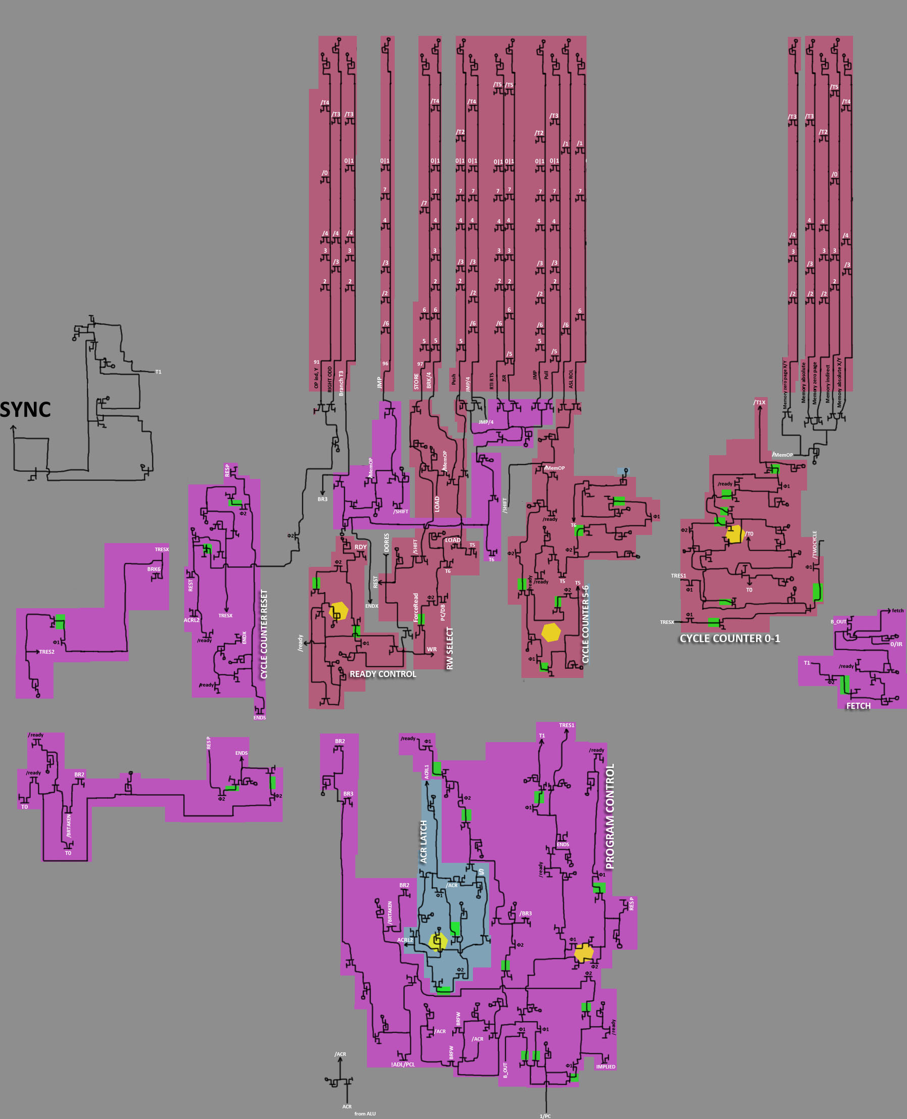

Post by org »

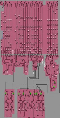

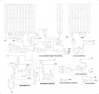

Todays speccy: complete 6502 dispatch unit.
6502 addict
That's neat!

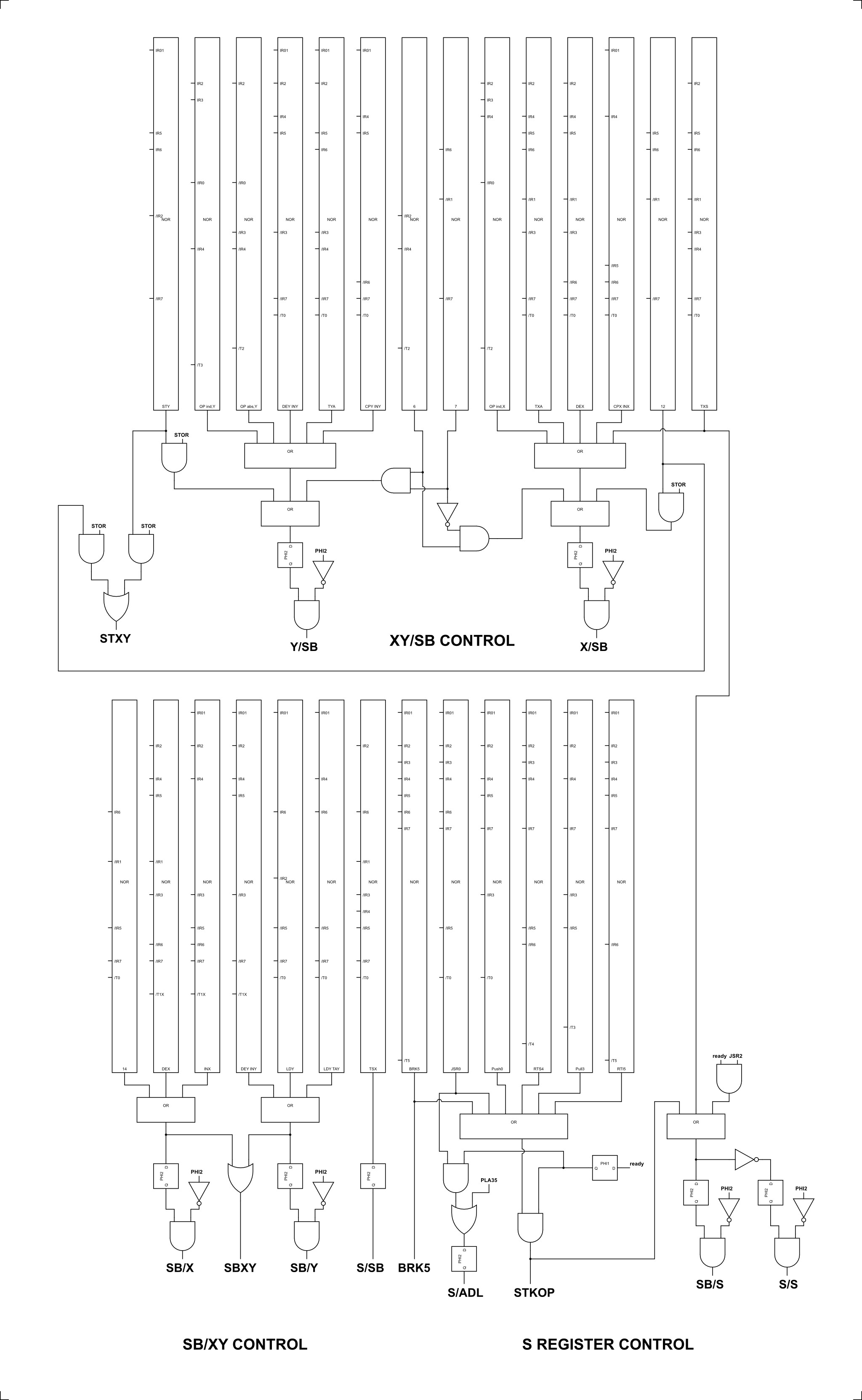

Todays speccy: X,Y,S registers control

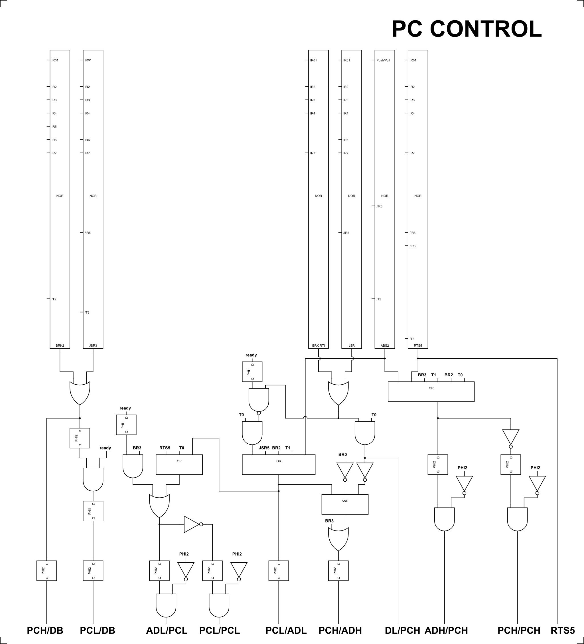

Post by org »

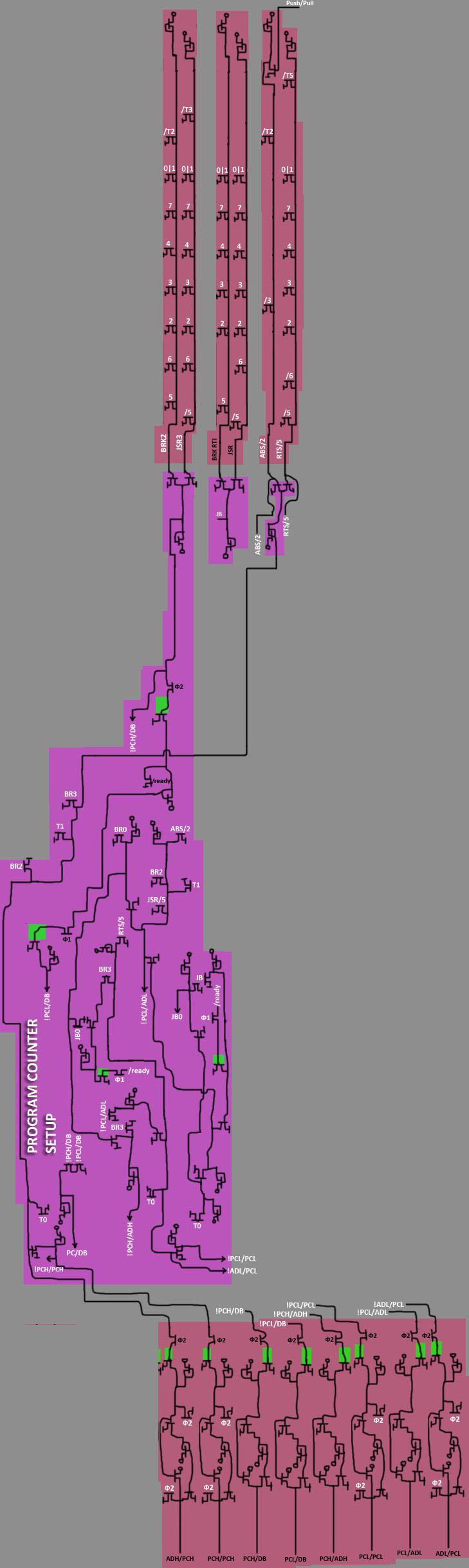

Todays speccy : Program counter control

whartung
Posts: 1004
Joined: 13 Dec 2003
Post by whartung »
What are the long rectangles at the top feeding in to the circuits at the bottom? For example, the two on the left labeled BRK2 and JSR3. And what are the IR1, IR7, etc. labels and marking on these bars?
