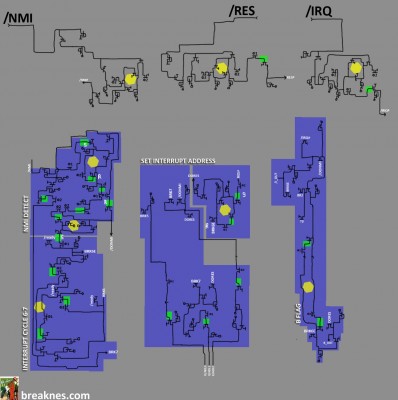

Todays speccy: interrupt handling circuits

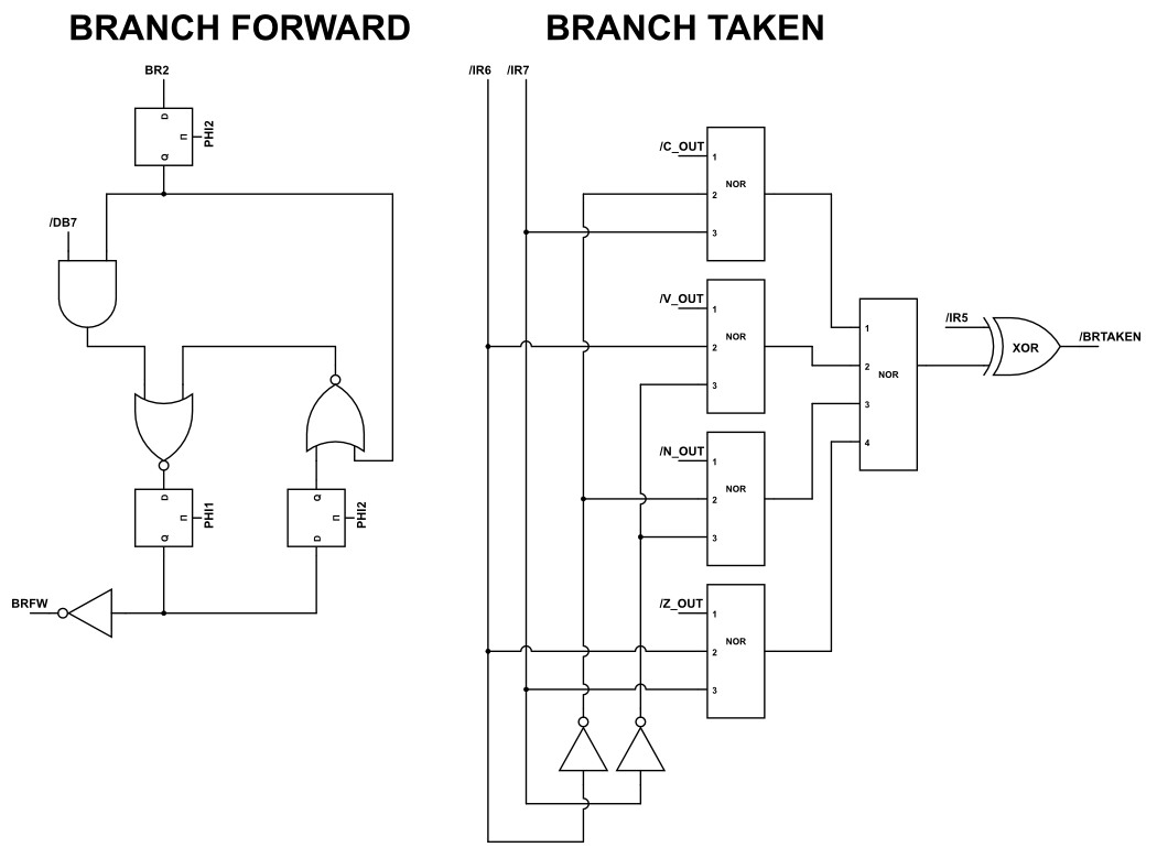

Todays speccy 2: branch logic

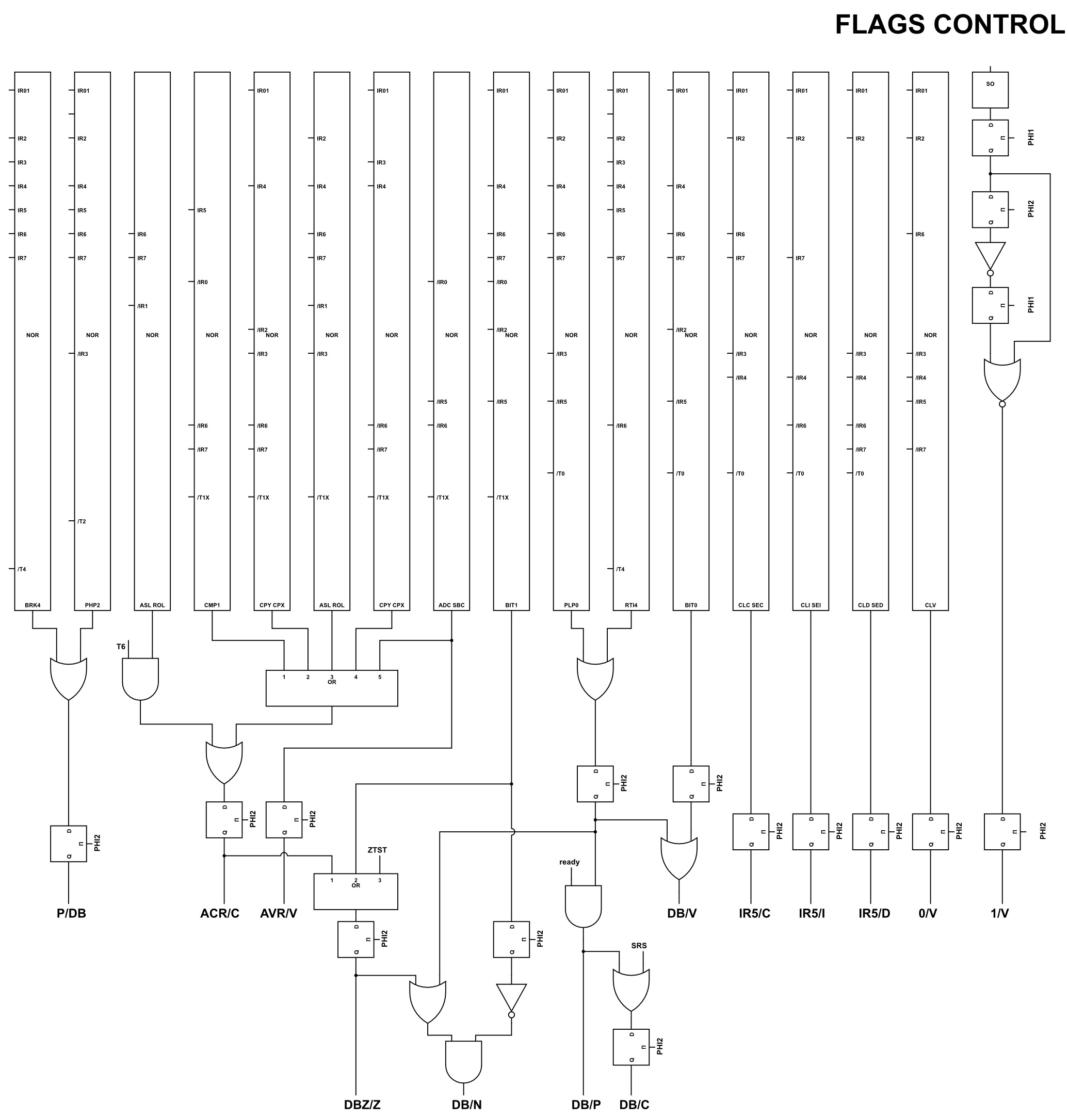

Todays speccy: flags controls (including SO pad logic)

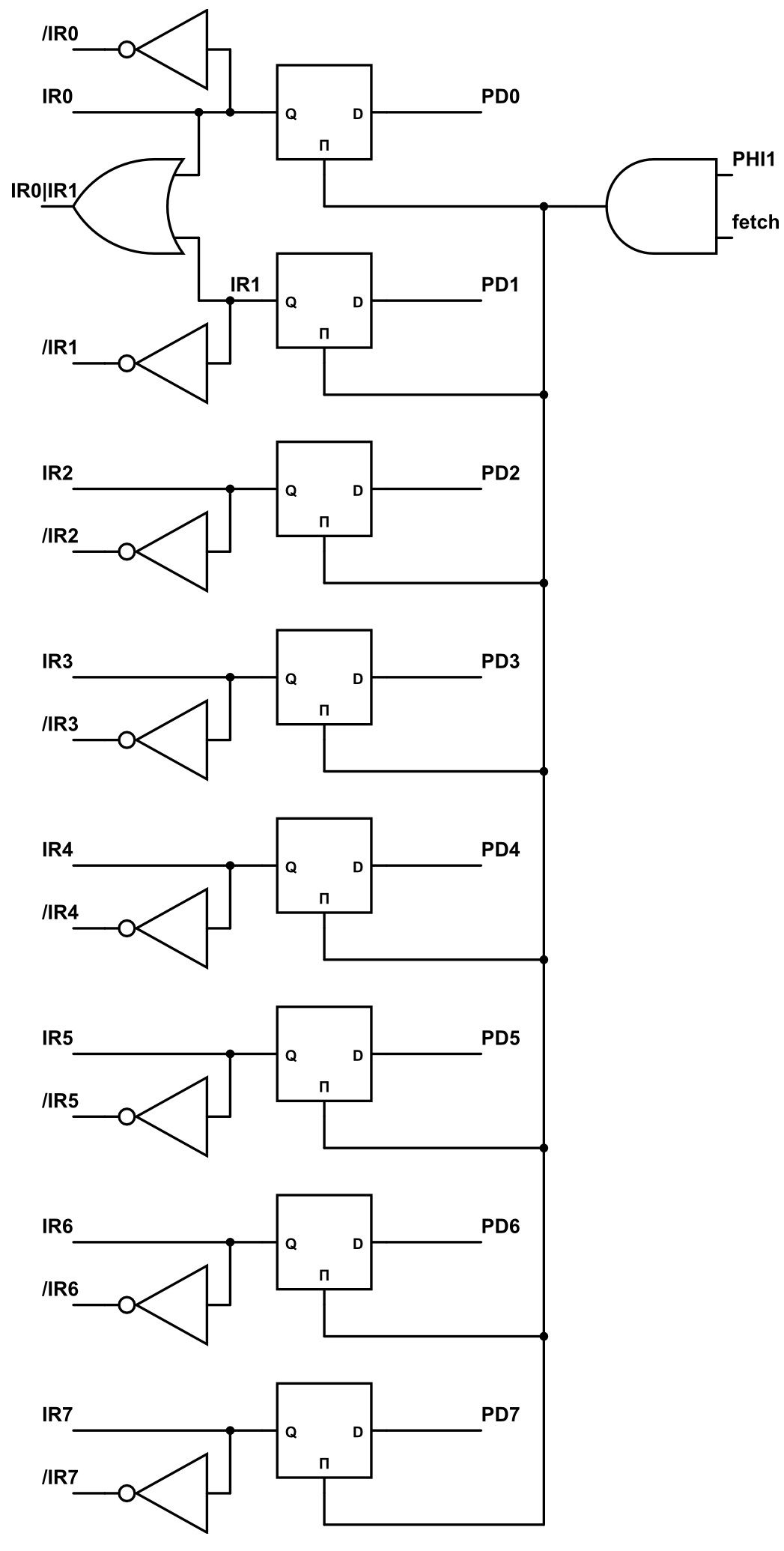

Todays speccy: complete 6502 dispatch unit.

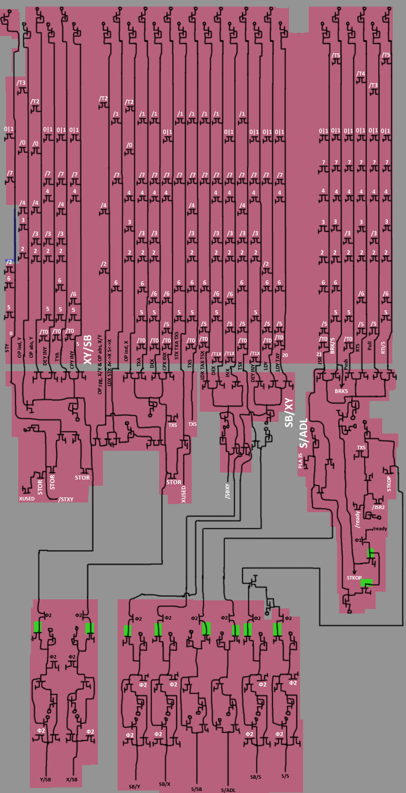

Todays speccy: X,Y,S registers control

whartung
Posts: 1004
Joined: 13 Dec 2003
Re: Breaking 6502 apart
Post by whartung »
What are the long rectangles at the top feeding in to the circuits at the bottom? For example, the two on the left labeled BRK2 and JSR3. And what are the IR1, IR7, etc. labels and marking on these bars?
