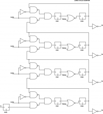

- Complete decoder labels
- Fixed names for /T0, /T1X and T1 lines
Latest version here : http://breaknes.com/files/6502/6502.jpg

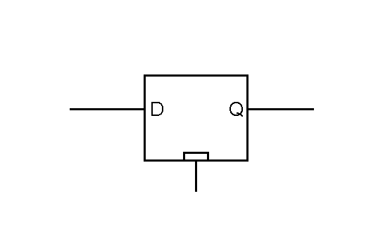

One small point - for a transparent latch, I've seen a symbol used where the clock input is marked with a half- square, instead of a triangle. The triangle means it's an edge-triggered flop.

Those D-triggers are implemented as floating gate transistors. And its level-triggered of course. Is there any better way to represent it as logic block ?
Like this, then? Up until now I've just used "LE" to label such an input, but a symbol would be preferable.

That's exactly what I've seen before, thanks Jeff. I couldn't find it though. What I did find was the idea of using a plain input called "E" instead of a triangle-marked input.
Posts: 3526
Re: Breaking 6502 apart
Ditto on both points! -- I did a search and found the "E" suggestion but not the symbol. So, I drew one myself. Glad you like it! :D

Fixed) I found "custom element" in circuitlab and made "E" input.
