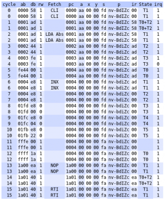

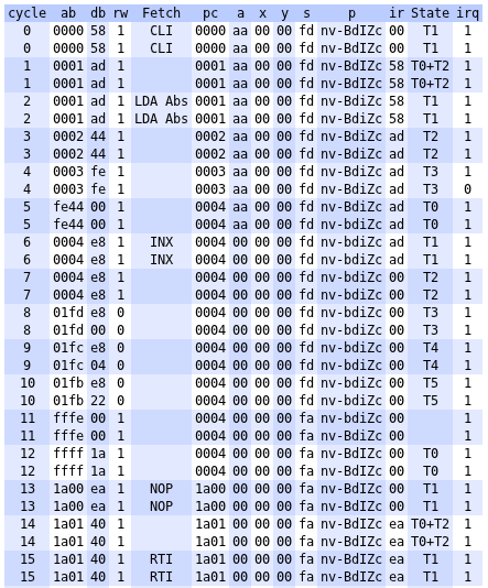

Hi,
Does anyone know if there is any latency (even half a cycle) in pulling nIRQ high when a timer interrupt is acknowledged (either by reading T1C-L/T2C-L or by writing T1C-H/T2C-H)?
I'm trying to do a very accurate simulation, specifically to handle a case similar to Garth's "ghost interrupts", in which an IRQ is taken the cycle after a read from T1C-L, even though this read would have acknowledged the IRQ, and it seems to me that the only way this can make sense is if there's some kind of latency.
Supposing T1C-L is at $FE44, here are a couple of Visual6502 simulations of an IRQ being generated while reading from $FE44:
  • In this first case, the interrupt is acknowledged at the last possible moment that would stop the interrupt from being taken.
  • In this second case, the interrupt is acknowledged at the first possible moment that would allow the interrupt to be taken anyway.
If the second case represents more or less what has been observed in the past, this must mean that a cycle passed between T1C-L being read and nIRQ going high. Has anyone ever measured this with a logic analyser, or have any documentation to this effect (I can't see anything in the 6522 datasheet)? Or if not, does my interpretation seem sound there, and is this a reasonable assumption to make? I'm not 100% sure exactly when the read from $FE44 is done, but my best guess is last half of T3?
Anyone here more hardware-inclined than me who can make sense of this?

 Post subject: Re: 6522 - exact timing
PostPosted: Mon Mar 17, 2014 1:55 pm
Posts: 10949
RichTW wrote:
... [In the NMOS 6502,] as long as nIRQ is low during the first half of T0, the interrupt sequence will begin, and this is the only place the CPU checks whether an interrupt should be taken or not. Its level during any other 6502 timing state appears to be irrelevant.
Just for the record, I think that branches behave differently - there's a discussion at viewtopic.php?t=1634
Also note that the tabulation in visual6502 has been corrected since some of the prior experiments. We now see that the usual case is that an interrupt input must be low at the start of a T0, normally, or low at the start of a T3, for branches. By "low at the start of" a cycle, I mean "low during the end of the previous cycle".
