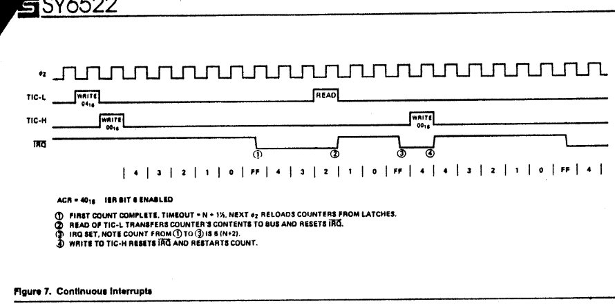

I found an SY6522 ap. note, AN-5 from Synertek from March of 1982, with this diagram:

Ah, that's a great find, thank you for posting that! So according to that, there's absolutely not a delay in pulling nIRQ high after a read from T1C-L, which is a shame as it means I have to come up with another theory as to how these "ghost interrupts" occur :( I noticed in the full datasheet for the SY6522 that the IRQ\ output is open drain, so it surprises me that the rising edge occurs so quickly, given what you've previously said about how this works. The VIA in the case I'm trying to understand was an R6522AP, but this is more-or-less identical as far as I can tell.
It just means it releases it that quickly.  How quickly it actually comes up will depend on the time constant formed by the pull-up resistor and line capacitance.
