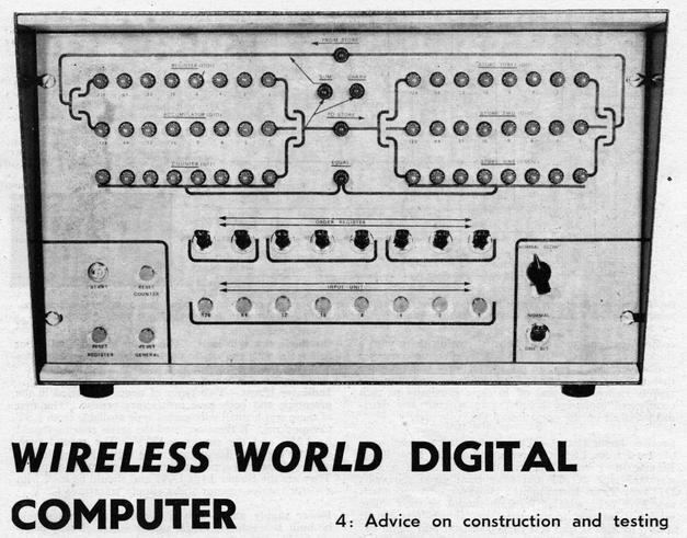

Back in 1967 Wireless World published a series of articles by Brian Crank on the design, construction and programming of a bit-serial digital computer, built for a project cost of approx £50, mostly using reject germanium transistors.
The articles were re-published as a short book, and Dave Wade has put a scan on his website.
File comment: Front panel photo

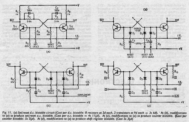

and storage elements:
File comment: Sequential circuits including a toggle flop

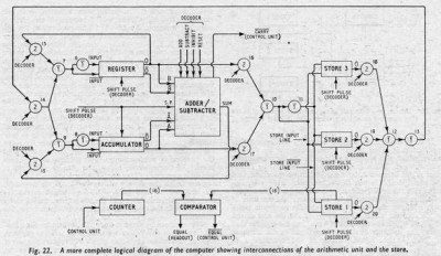

Here's the overall block design of the computer:
File comment: Block diagram of the computer

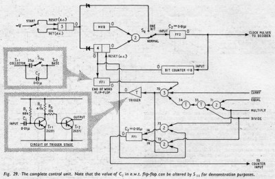

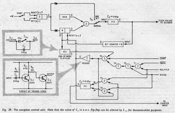

Now we can design the control logic:
File comment: Control Unit
and
File comment: Complete Control Unit

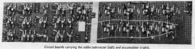

The implementation is on large circuit boards:
File comment: Two (of several) circuit boards

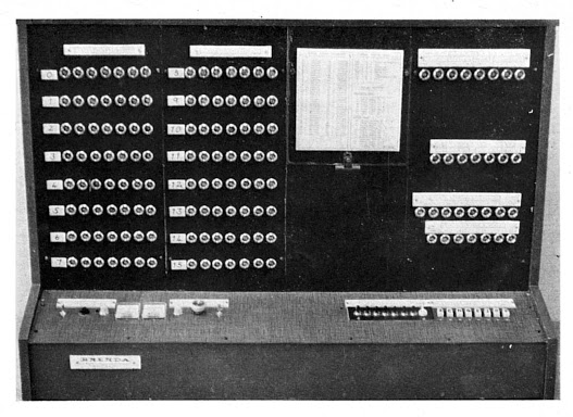

I now have both Alan Wilkinson's 1968 book, and Hector Parr's memoir. I posted some low-res photos on G+ which can now be seen here.
Note that Alan recommends using silicon rather than leaky germanium transistors, and using an input diode in the latter case. (Whereas Brian uses a positive base bias.) Note also that Alan is not building a computer, but something more like an ALU - as he says, he's calling it a Computer Model. All the combinatorial logic is made of 3-input NOR gates, although he uses what we'd now recognise as a NAND logic symbol. Unused inputs can simply be left unconnected.
So, I have a new story now: Alan was first, publishing in 1965 a design for his Small Computer Model in the magazine of the Association of Teachers of Mathematics. Brian would have picked up from that and written his articles in 1967. Hector also picked up from the book, and built first his DENICE and then his BRENDA computers - the first at Darlington Grammar and the second at Barnard Castle School.
I found some postings about BRENDA on usenet/google groups, by John Gilliver:
But the first computer, as
opposed to programmable calculator or similar, I used was BRENDA, the
Barnardian Electronic Numerical Demonstration Apparatus; it was a
computer by Mr. Parr's definition, which was that the sequence in which
it obeyed instructions could be varied - i. e. it had a conditional
jump instruction. It had a memory of 16 - not K, 16; 7 bits, too - very
odd, Mr. Parr's own design. Shape and size of the boot of a Hillman Imp
- for the simple reason that that's where he built it. (Quite a
character: as well as mathsmatering and computerbuilding, he built -
professionally, one was even exported to Canada! - electronic organs for
churches.)
Programming in 16 memory locations makes you write very compact code!
LEDs? BRENDA had filament bulbs! And 16 toggle switches? BRENDA was a
serial processor (quite weird - ones complement rather than the more
common twos complement), so you entered things one bit at a time.
(The BaRnardian Electronic Demonstration Apparatus was a computer that
looked like everybody's idea of a computer then: a bank of glowing
bulbs. It was the shape and size of the boot [trunk] of a Hillman Imp
[small car of the time], because that's where Mr. Parr my maths master
built it. In discrete components, not an IC in sight. Despite that, it
was a true computer, and I started learning coding on it: I can still
remember the instruction set. I wish I had a picture of it.)
