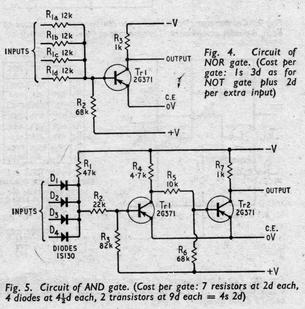

The explanation proceeds bottom-up, starting from logic gates:
and storage elements:

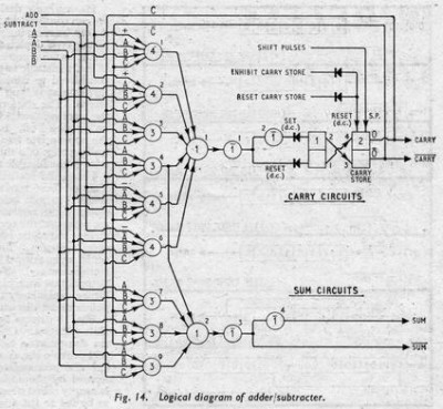

Then we can leave circuit design and proceed to logic design, for example a subtractor:

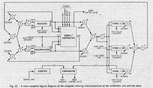

And up a level to block design:

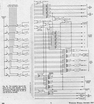

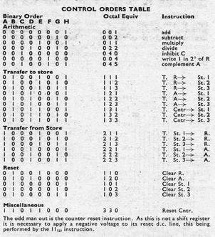

Here's the overall block design of the computer: We need to define the instruction set (or control orders, as they were then called): and then design the decoder at logic level: Now we can design the control logic: and Final part in next post...

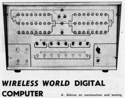

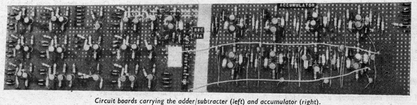

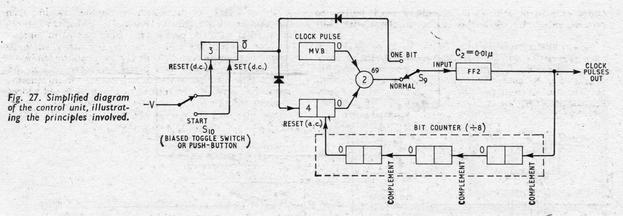

There's just one picture in the article showing the control sequencing: There are a few short example programs: The implementation is on large circuit boards: This computer design was used in education, here at Sandhurst (a military school) See also http://www.fano.co.uk/history/WWcomp.html and http://www.6502.org/users/dieter/mt15/mt15.htm
(On a personal note, I'm really pleased to have these articles, as it was a formative experience for me to find a book on computer design in the school library in the late 70s, which as far as I can remember was based on exactly this project.)

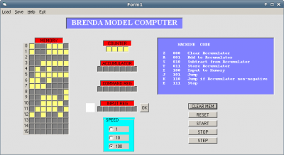

Hector wrote a simulator for Brenda, and I'm pleased to attach it here with his permission. It's written for Windows but runs happily in WINE on linux.
There are only 16 memory locations, and minimal operations, but Hector has supplied a demonstration program to multiply two numbers.

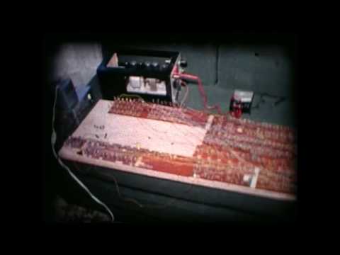

Back to Brian Crank's 1967 computer as published in Wireless World (and as seen at the top of the thread), he's recently made available an 8mm movie of the machine before it was cased up - with blinking lights!
Thanks Brian for sharing!
