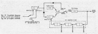

There's just one picture in the article showing the control sequencing:

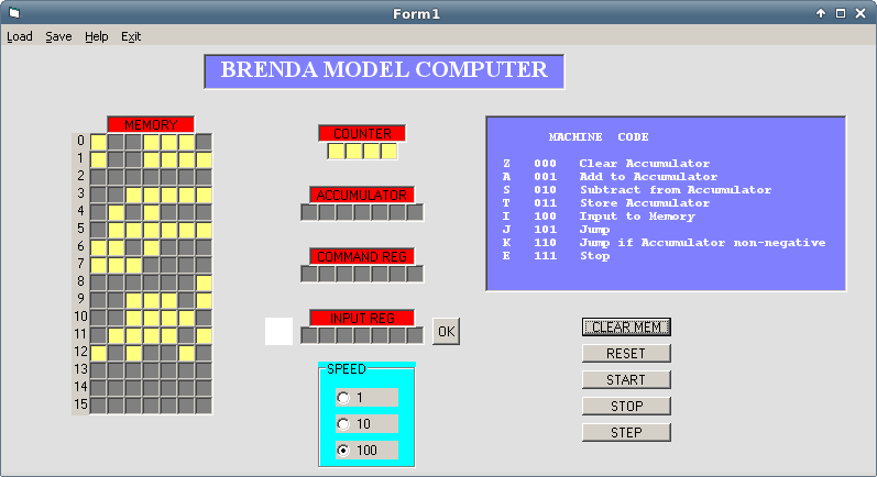

Hector wrote a simulator for Brenda, and I'm pleased to attach it here with his permission. It's written for Windows but runs happily in WINE on linux.
There are only 16 memory locations, and minimal operations, but Hector has supplied a demonstration program to multiply two numbers.
Brenda.zip
(572.14 KiB) Downloaded 349 times
