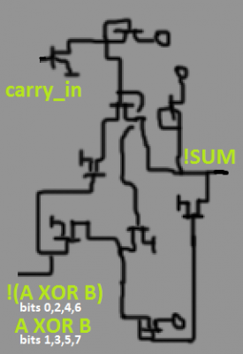

Todays speccy: complete ALU transistor schematics
Enjoy! :D

Todays speccy: ALU logic (missing BCD correction).

// trans-level implementation of summator see in ALU_sum.png
