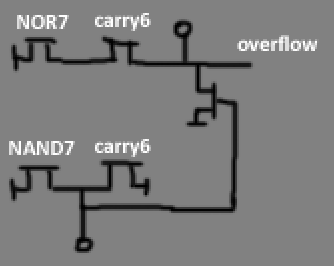

Todays speccy: ALU logic (missing BCD correction).
// A/B INPUT
if ( NDB_ADD ) BI = ~DB;
if ( DB_ADD ) BI = DB;
if ( ADL_ADD ) BI = ADL;
if ( SB_ADD ) AI = SB;
if ( 0_ADD ) AI = 0;
// LOGIC (based on NAND/NOR)
NOR = ~(AI | BI);
NAND = ~(AI & BI);
if ( ORS ) ADD = NOR;
if ( ANDS ) ADD = NAND;
if ( SRS ) ADD = NAND >> 1;        // next bit feed previous result
if ( EORS ) {
    nEOR[0,2,4,6] = ~ (~NOR & NAND)
    EOR[1,3,5,7] = ~ (~NAND | NOR)
    ADD[0,2,4,6] = nEOR[0,2,4,6]
    ADD[1,3,5,7] = ~EOR[1,3,5,7]
// ARITHMETIC
// BCD correction run-flow : DAA -> ALU -> ADD -> DSA -> SB -> AC.
// DECIMAL ADDER ADJUST (detect decimal carry and halfcarry)
// input carry driver I_ADDC comes in inverted form
// carry chain
carry_out = I_ADDC;
// bits 0,2,4,6
carry_in = carry_out;
carry_out = ~(NAND[0,2,3,6] & carry_in) & ~NOR[0,2,4,6];
SUM[0,2,4,6] = ~(nEOR[0,2,4,6] & ~carry_in) & (nEOR[0,2,4,6] | ~carry_in);
// bits 1,3,5,7
carry_out = ~(~NOR[1,3,5,7] & carry_in) & NAND[1,3,5,7];
SUM[1,3,5,7] = ~(EOR[1,3,5,7] & ~carry_in) & (EOR[1,3,5,7] | ~carry_in);
// trans-level implementation of summator see in ALU_sum.png
// overflow test
carry6_out = carry_in;
if ( PHI2 ) AVR_Latch = ~(NOR7 & carry6_out) & (NAND7 | carry6_out);
AVR = AVR_Latch;
if ( SUMS) ADD = SUM;
// High-level implementation :
// s = AI + BI + ~I_ADDC;
// SUM = ~ ( s & 0xFF );
// carry_out = s >> 8;
// ADDER HOLD (register holds data in inverted logic)
if ( ADD_ADL ) ADL = ~ADD;
if ( ADD_SB06 ) SB = (SB & 0x80) | (~ADD & 0x7F);
if ( ADD_SB7 ) SB = (SB & 0x7F) | (~ADD & 0x80);
// DECIMAL SBUS ADJUST (affects SBus lines)
// ACCUMULATOR
if ( SB_DB ) DB = SB;
if ( SB_AC ) AC = SB;
if ( AC_SB ) SB = AC;
if ( AC_DB ) DB = AC;
if ( 0_ADH0 ) ADH &= ~0x01;
if ( 0_ADH17 ) ADH &= 0x01;
DSA is actually "DECIMAL SBUS ADJUST", not "DECIMAL SUBTRACT ADJUST".
DSA is applied before loading accumulator (AC), after BCD correction.
EDIT: important condition:
if ( PHI2 )
    NDB_ADD = DB_ADD = ADL_ADD = 0_ADD = 0;
    SB_AC = AC_SB = AC_DB = 0;
    ADH = 0;

Previous post need some corrections... I'm writing test program ATM, errors will be fixed later.
EDIT: fixed ALU SUM errors and wrote test program:
#include <stdio.h>
int nand (int a, int b, int bit )
    int bit_a = (a >> bit) & 1;
    int bit_b = (b >> bit) & 1;
    return (~ (bit_a & bit_b)) & 1;
int nor (int a, int b, int bit )
    return (~ (bit_a | bit_b)) & 1;
int noteor (int a, int b, int bit )
    return ~ (~nor(a,b,bit) & nand(a,b,bit));
int eor (int a, int b, int bit )
    return ~ (~nand(a,b,bit) | nor(a,b,bit));
int alusum ( int a, int b, int carry_in, int *carry, int numbits )
    int bit;
    int carry_out = ~carry_in;
    int sum = 0, s;
    for (bit=0; bit<numbits; bit++)
        if ( bit & 1 ) {
            carry_in = carry_out & 1;
            carry_out = ~(~nor(a,b,bit) & carry_in) & nand(a,b,bit);
            s = ~(eor(a,b,bit) & ~carry_in) & (eor(a,b,bit) | ~carry_in);
        else {
            carry_out = ~(nand(a,b,bit) & carry_in) & ~nor(a,b,bit);
            s = ~(noteor(a,b,bit) & ~carry_in) & (noteor(a,b,bit) | ~carry_in);
        //printf ( "%i: %i %i %i %i %i\n", bit, (a >> bit) & 1, (b >> bit) & 1, s & 1, carry_in & 1, carry_out & 1);
        sum |= (s & 1) << bit;
    *carry = ~carry_out & 1;
    return ~sum & ((1 << numbits) - 1);
void logic_test ( int a, int b )
    int bit;
    for (bit=0; bit<8; bit++)
        printf ( "NAND=%i ", nand(a, b, bit) );
        printf ( "NOR=%i ", nor(a, b, bit) );
        printf ( "EOR=%i \n", eor(a, b, bit) );
        printf ( "!EOR=%i \n", noteor(a, b, bit) );
main ()
    int a, b, sum, carry;
    //logic_test ( 0x35, 0x53 );
    printf ( "6502 ALU test.\n" );
    printf ( " A  B  S C\n" );
    for ( a=0; a<256; a++ )
        for (b=0; b<256; b++)
            sum = alusum ( a, b, 0, &carry, 8 );
            printf ( "%02X %02X %02X %01X\n", a, b, sum, carry );
Now everything is correct.
6502 ALU test.
 A  B  S C
03 F9 FC 0
03 FA FD 0
03 FB FE 0
03 FC FF 0
03 FD 00 1
03 FE 01 1
03 FF 02 1
04 00 04 0
04 01 05 0
BCD correction is next.
