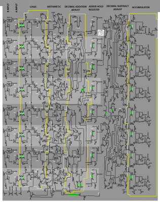

Todays speccy: complete ALU transistor schematics
Enjoy! :D

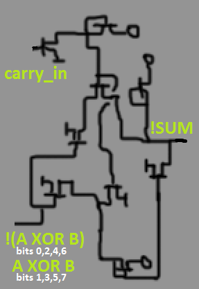

Todays speccy: ALU logic (missing BCD correction).

// ARITHMETIC
// BCD correction run-flow : DAA -> ALU -> ADD -> DSA -> SB -> AC.
// DECIMAL ADDER ADJUST (detect decimal carry and halfcarry)
// input carry driver I_ADDC comes in inverted form
// carry chain
carry_out = I_ADDC;
// bits 0,2,4,6
carry_in = carry_out;
carry_out = ~(NAND[0,2,3,6] & carry_in) & ~NOR[0,2,4,6];
SUM[0,2,4,6] = ~(nEOR[0,2,4,6] & ~carry_in) & (nEOR[0,2,4,6] | ~carry_in);
// bits 1,3,5,7
carry_out = ~(~NOR[1,3,5,7] & carry_in) & NAND[1,3,5,7];
SUM[1,3,5,7] = ~(EOR[1,3,5,7] & ~carry_in) & (EOR[1,3,5,7] | ~carry_in);
// trans-level implementation of summator see in ALU_sum.png

PostPosted: Mon Aug 06, 2012 7:55 pm
Posts: 10980
For the equations, you could check the patent which is linked from this post
viewtopic.php?p=8859#p8859
You might find some of the info on the visual6502 wiki useful too
http://visual6502.org/wiki/index.php?ti ... ecimalMode

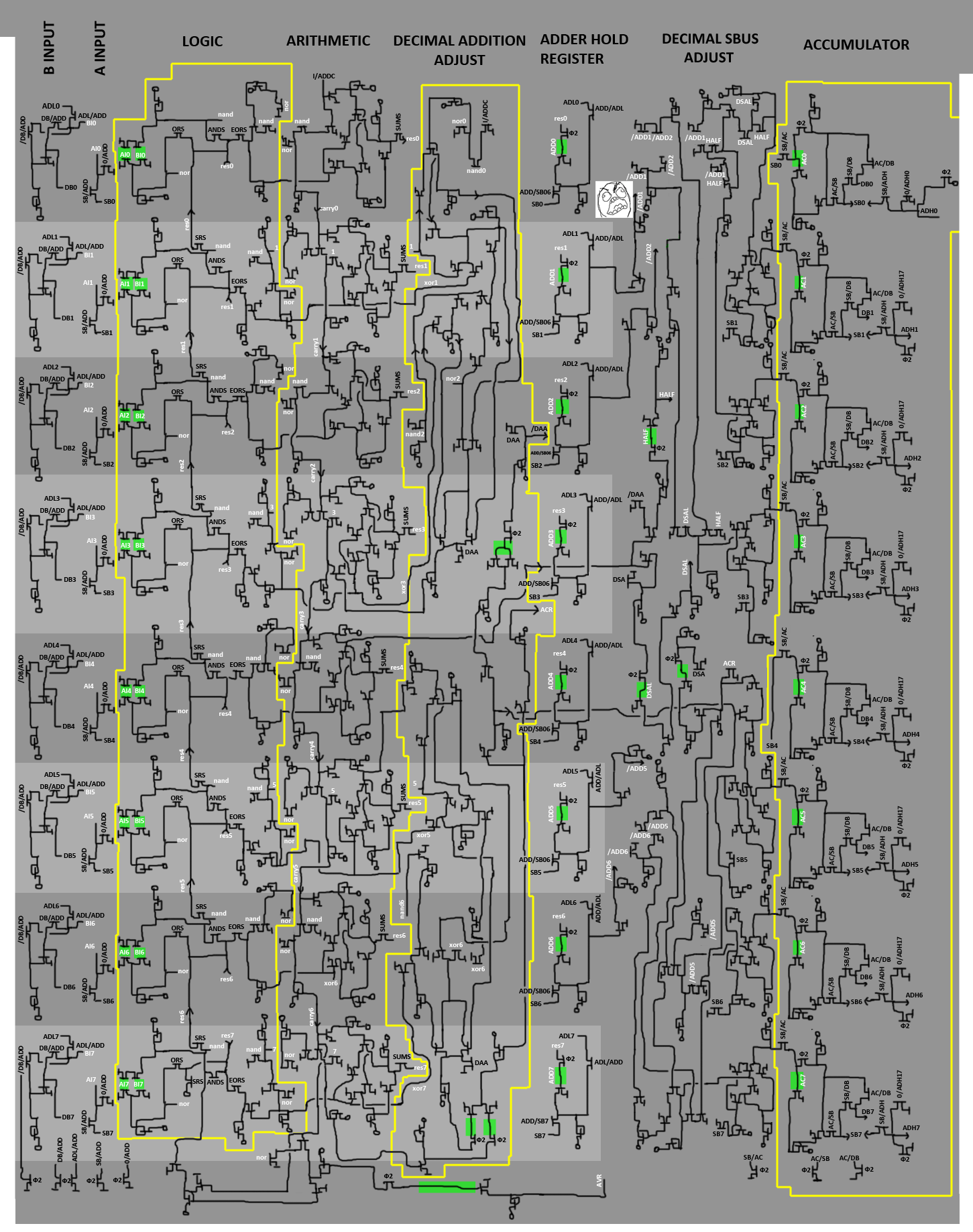

A bit cleaned ALU.
I'm ready to write its C simulator. Stay tuned ;)
