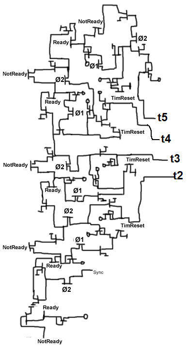

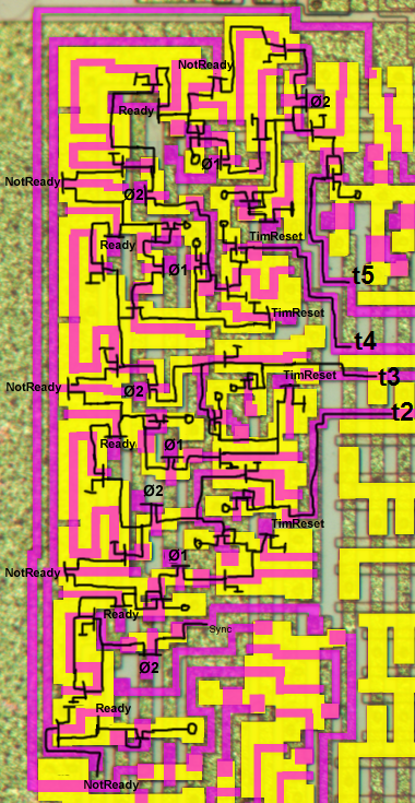

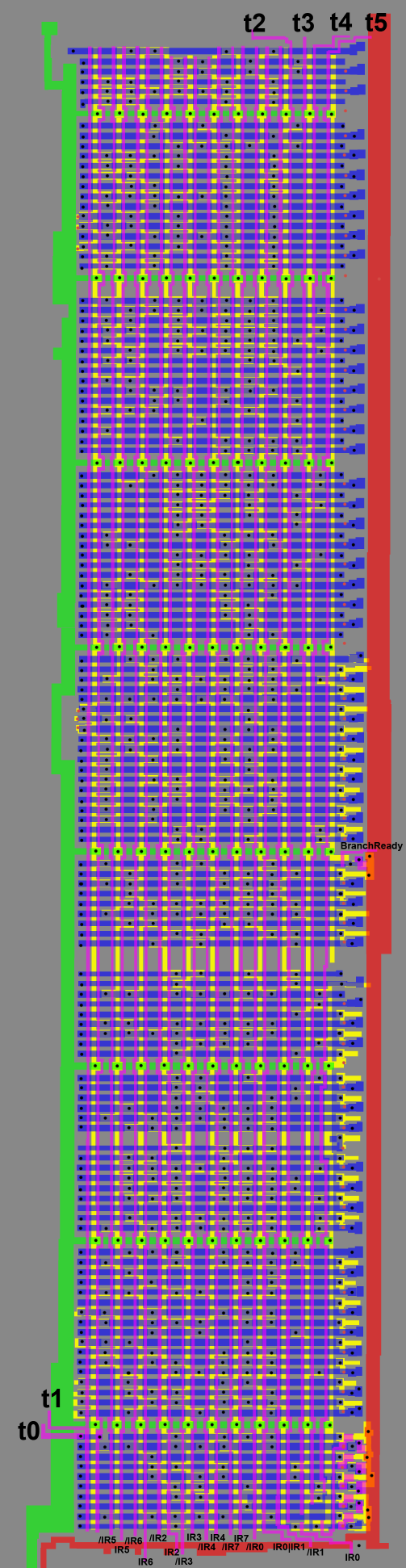

Todays speccy : Timing control.
Image Image
TimReset control goes from "random logic" and its purpose to set all T-outputs high.
Low level T-ouput fires PLA line.
6502 addict

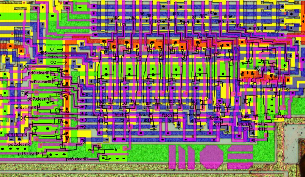

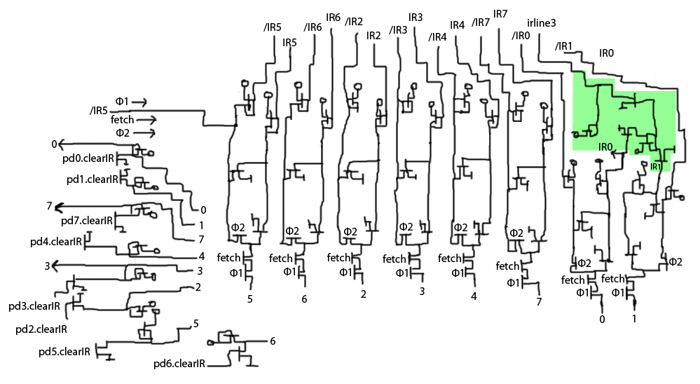

Todays speccy: Instruction Register (IR)
irline3 = IR0 | IR1.
6502 addict
PostPosted: Sun Jun 24, 2012 6:00 pm
Posts: 201
Can someone explain why phi2 is integrated into flip-flop ? :)

PostPosted: Mon Jun 25, 2012 8:07 am
phi2 is there to break the feedback. Otherwise, you have two inverters reinforcing one another in a feedback loop, and it's a difficult circuit design to ensure that the input (during phi1) can write a new value.

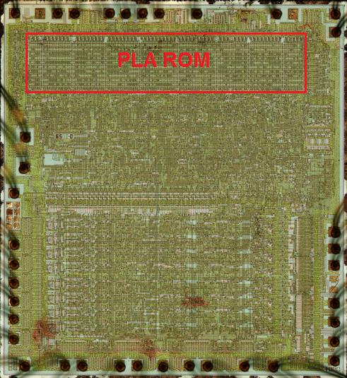

Todays speccy : instruction decoder (PLA)
I will not draw transistor-level schematics, because its trivial.

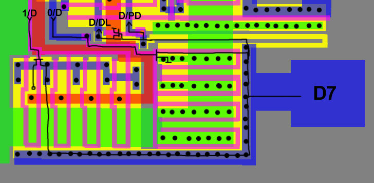

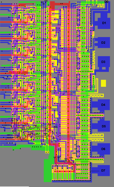

Todays speccy : Data bus + data latch
Complete picture:
Data pin:
Data latch:
(not yet recognized where actually is "latch" :))
Data latch and data pin are regular structures and multiple x8 )
6502 addict
PostPosted: Thu Jun 28, 2012 6:05 pm
To find a (dynamic) latch, look for a transistor gate which is floating when a clock is low. In this case, from the D/DL annotation on the right, go left through the pulldown of the inverter, then left again through the Phi2 transistor, and you've arrived at the latch. You actually have two transistor gates but the two transistors are in parallel and have the same electrical function as each other - it's a single transistor.
The parasitic capacitance of a transistor gate is the largest type of stray capacitance on a chip of this type, and is used as the storage node of the latch.
Hope this helps
PostPosted: Fri Jun 29, 2012 6:07 am
Posts: 201
Do you know, how long this sort of capacitor memory can hold the charge ?
Let say, CPU is in "read mode" (phi2 is high). Will data latch keep its charge during CPU "write mode" (when phi1 is high) ?
6502 addict
PostPosted: Fri Jun 29, 2012 6:25 am
That's related to the question of how slow a clock can you reliably run an NMOS 6502. I don't know the answer. But a DRAM of that era likes to be refreshed every 2ms, so I'd use that as an order of magnitude estimate: the capacitor structure is the same, although the sensing of charge is different. I think this is consistent with being able to run down to kHz but not slower.
Certainly there is no hard cutoff: the charge will leak, and the rate of leakage is a function of temperature and variations of each transistor. Eventually the voltage is too low for the pulldown to be effective: the logic gate's output rises high enough for the next gate to pull down.
Edit: DRAM refresh period (but I'm still not sure if it was 2ms or 8ms)
Edit: This datasheet is for NMOS 6500 series and says 50kHz is the minimum clock frequency (top of page 5) - revision date 11/85.
