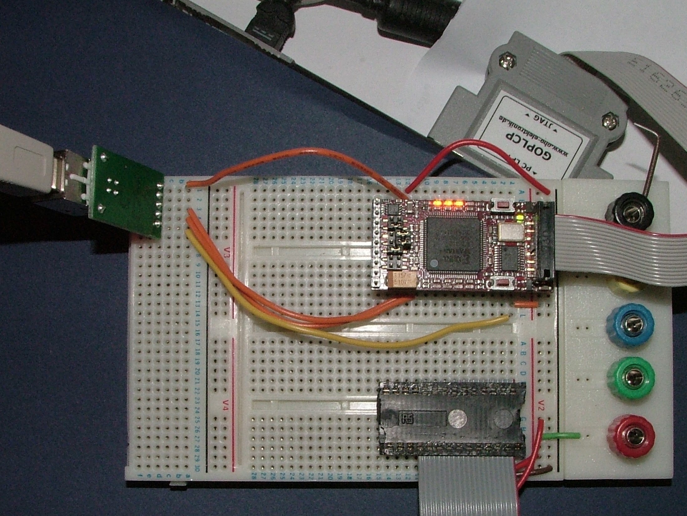

65Org16 working on FPGA!
I'm delighted to announce that 65Org16 today ran a first test program on FPGA.
Here's the program (*):
        ;; for minimal proof-of-life with uart+led with 65Org16 in GOP24
        ;; python3 ../../cpu65Org16/tools/asm65Org16.py tinytestrom.as
;; place the bootstrap so the reset vector lands at FFFFFFFC
bootstrap=0xFFFFFFEE
UartS1=0xFFFEFFF8
UartR1=0xFFFEFFF9
UserLeds=0xFFFD0000
bootstrap:
        LDX #0xFFFF
        TXS  ;; initialise stack pointer
        CLC
loop:
        LDA UartR1
        EOR #0xF
        STA UserLeds
        BCC loop
; this is arranged to be placed in the reset vector, by careful initial .Org
        DATA # LOW(bootstrap)  ;reset vector
        DATA # HIGH(bootstrap)
I need to tidy up the verilog and put it on github. I suspect I need also to add RAM - with only ROM there's not much point writing a program loader.
Presently I have an i2c peripheral for I/O and a bank of 8 LEDs too. There's no flow control on the i2c so I'm not sure yet how much work there is in making it into a usable interface to the host. Also, the i2c verilog I'm using isn't freely redistributable.
Got a picture - not much to see, just 4 wires connecting the OHO module to the i2c to USB adaptor, two for data and two for power.
breadboard with OHO FPGA module and I2C interface
(*) There was an earlier test program which just wrote the data straight to the LEDs, but I wasn't convinced it was doing anything - was it just my previous bitstream without the CPU which just connected the i2c to the LEDs? So I added an ADC. But that blew the carry, so I changed to EOR. Then I finally realised I hadn't adjusted the branch offset. This hand-adjustment of ROM contents isn't ideal.
Edit: fixup missing photo link

Re: 65Org16 working on FPGA!
Congratulations, Ed! I think some of us out here are suffering a slight case of project envy!
Cheers! I have to say it took two solid days of procrastination from downloading the i2c module to writing some verilog to put it on the FPGA. But doing that did break my mental block.
Also, I must point out that 65Org16 is conceived as being a least-effort solution to the problem of a 32-bit address space. The core is essentially a patch to Arlet's, and I haven't done much work. Should I be ashamed to say that I was beginning to doubt the correctness of his core when I finally realised that I hadn't patched the new branch offset?!
