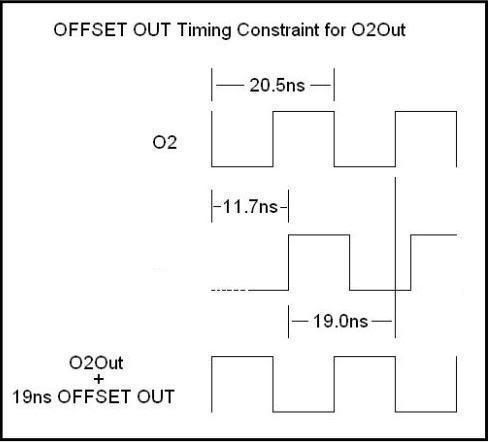

I was abit premature in my declaration of success 7 hrs ago. I later realized I had a timing constraint error because my 5.5ns "estimated" delay is shorter than the internal delay (as spec'd by ISE), from O2 to pad, of 11.7ns. Although the circuit still worked the best I had so far, it was locking up after some time (<1min)...

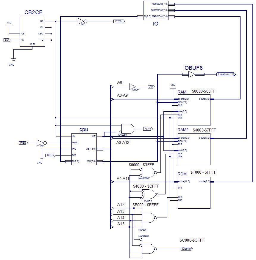

After looking over some of my old schematics from the PWA project, I decided to qualify WE from Arlet's 6502 core with O2/2. In addition, instead of an arbitrary 5.5ns, I calculated the actual time I needed to put O2Out in sync with O2, although the display likes an inverted version of O2.
The 6502SoC has been running now for over an hour with no problems @24MHz using this constraint with the schematic below:
NET "O2" TNM_NET = O2;
TIMESPEC TS_O2 = PERIOD "O2" 20.5 ns HIGH 50% INPUT_JITTER 100 ps;
NET "O2Out" OFFSET = OUT 19.0 ns AFTER "O2" RISING;
As I am not a timing diag kind of person, I realized in the middle of posting this, that the diagram below is incorrect. The 2 waveforms below O2 are divided by 2 in the schematic. As usual with me, I happen across my successes sometimes by accident. This "accident" will give me insight to pushing for 48MHz, because for sh*ts and giggles I just now tried to run the 6502SoC @48MHz, and it cleared the display. Although repeatability was not there yet, it did more now than previous attempts @48MHz... I'm zeroing in!
Updated schematic:
