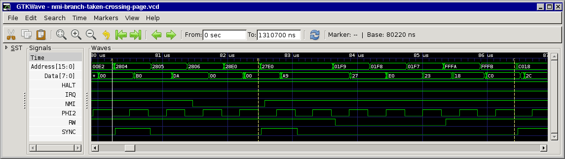

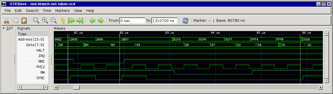

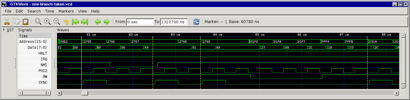

I hooked up my logic analyzer to check what was going on. First a screenshot of the expected behaviour (using a 2-cycle not-taken branch):
At ~81us the CPU fetches the BCS opcode and NMI goes low. At the end of this cycle the CPU recorded the first-low-cycle of NMI. In the next cycle the CPU fetches the offset, NMI is still low and the CPU records the second-low-cycle so interrupt execution can start. Then, in the next cycle, the 7-cycle interrupt execution starts.
Now the screenshot of the 3-cycle branch leading to the execution of another instruction:
At ~81us CPU fetches BCS opcode, in the next cycle the offset, also NMI goes low, then the CPU executes the branch, and now the NMI should be serviced. But the CPU fetches the next opcode ("A9" / "LDA #"), and the data ("01"), and after that starts with the 7-cycle interrupt sequence.

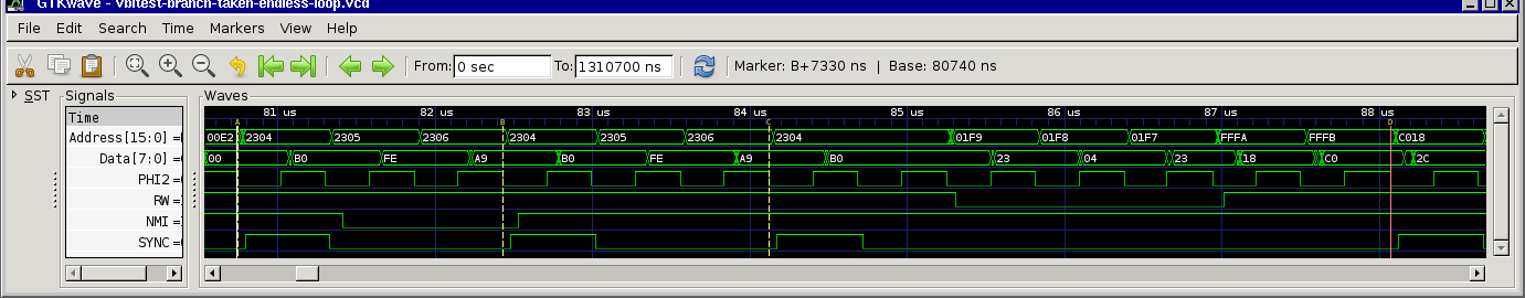

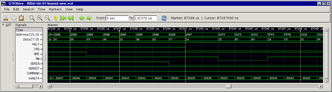

Here's another screenshot from my real-world code (sampled at Atari clock speed at the falling edge of PHI2 - ignore the timestamps at the top, they are a dummy 1us per sample). First there's a BNE backwards, followed by a "BIT $D20E" executed instead of the NMI handler:

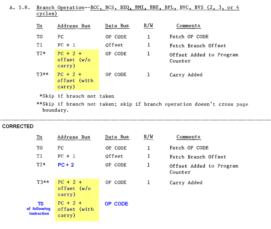

I did some research, but the only thing I found was a little thing in the MOS hardware manual: On page A-13 in the description of the branch instruction the (dummy) opcode fetches in states T2 and T3 didn't have word "discarded" with them (as the other dummy reads have), and the T0 cycle afterwards wasn't mentioned. But this could also be some simple typos and don't have to mean anything.

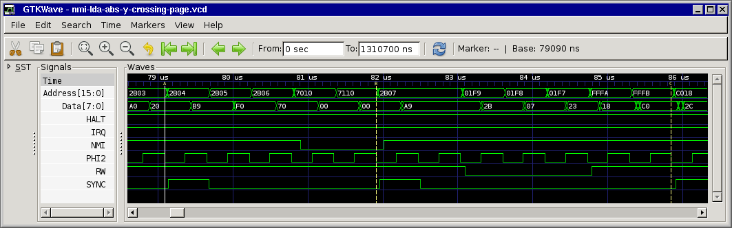

leeeeee wrote:
As interrupts are checked in the last cycle of an instruction perhaps an instruction that may need an additional cycle because of the posibility of crossing a page boundary only checks interrupts on the additional cycle. If the cycle isn't needed the check doesn't happen.
Have other instructions that can take an extra cycle been tested?
LDA ABS,Y both to the same page and crossing a page are fine. Maybe it's something specific to the branch commands or that the branches may require 2, 3 or 4 cycles...
LDA $70F0,Y not crossing a page (Y=0):
LDA $70F0,Y crossing a page (Y=$20):

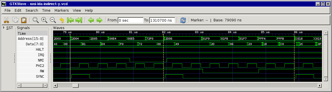

LDA (ZP),Y is fine, too.
not crossing a page:
crossing a page:

HiassofT wrote:
the MOS hardware manual: On page A-13 in the description of the branch instruction [...] this could also be some simple typos
I believe there is a rather serious typo, at least in the Jan 1976 edition (which AFAIK is the only edition).
I believe the original table shows the yellow-shaded notations one cycle too soon. For example the original version shows PC+2+offset appearing on the address bus in T2, which is unrealistically early. Remember the offset doesn't even reach the CPU until the very end of T1. Their comment for T2, "Offset added to Program Counter," refers to an internal operation which takes an entire cycle to complete. The same is true for their comment for T3, "Carry added." But the shaded notations show the addition results appearing simultaneously as the addition begins. Finally, T3 is shown with PC+2+offset+carry -- which is the fully-baked address of the next instruction. We expect that address in T0 of the next instruction, not in T3.
For clarity, here are 3 separate charts for the 3 branch possibilities. And you're right; certain bytes (not always opcodes) do get discarded:
Branch not taken:
    T0 PC
    T1 PC+1 (discarded)
    T0 PC+2 ; TO is opcode fetch of the following instruction
Branch taken:
    T0 PC
    T1 PC+1
    T2 PC+2 (discarded)
    T0 PC+2 + offset without carry ***
Branch taken, with Page Crossing:
    T0 PC
    T1 PC+1
    T2 PC+2 (discarded)
    T3 PC+2 + offset without carry (discarded) *** (a 'C02 cpu outputs PC+2 again for this cycle)
    T0 PC+2 + offset with carry

PostPosted: Sat Sep 04, 2010 2:07 am
Joined: Thu Sep 02, 2010 12:34 am
Posts: 36
Location: Salzburg, Austria
Hi Jeff!
I believe there is a rather serious typo, at least in the Jan 1976 edition (which AFAIK is the only edition). For clarity, here are 3 separate charts showing cycle and address-bus info for the 3 branch possibilities. And you're right; certain bytes (not always opcodes) do get discarded:
Note that the cycles marked *** are almost identical, but one is a T0 state (opcode fetch) and the other is not. And this is when our interrupt may get deferred!
Agreed, this is also how I understood the (brief) docs. Still I don't understand why the interrupt is deferred... At first we thought that the CPU kind of "chained" the next instruction to the branch, but since SYNC is set for the next instruction this means it must be something internal in the CPU, maybe something that's not easily measurable from the outside...
I'm not surprised that the optional extra cycle from an indexed data fetch doesn't provoke the symptom. That may alter timing, but (unlike our branch) doesn't create uncertainty about the address of the next opcode.
I think this might be the clue to the solution. Maybe :-)
Still, it's rather a puzzle you've uncovered. It would seem to imply that an interrupt would never be recognized if the code stream cosisted of nothing but branches-taken-without-pagecrossing! (A single branch-to-self instruction could execute this way, for example.) Would the interrupt be deferred forever ?!
AtariAge user drac030 had the same idea yesterday, so I checked it:
The branch-to-self is executed a second time, then the NMI handler starts. Of course afterwards the CPU is busy branching to the same location again and again, but it doesn't have any impact on interrupt processing.
So, I still guess, it must be the combination of the T2->T0 transition of a branch instruction occurring at the same moment as interrupt servicing would (normally) start.

I ran across this issue when I did a worst-case cycle analysis of my highspeed SIO code (serial transmission from/to peripherals at ~126kBit/sec).
The Atari SIO protocol is quite simple, the computer sends a command frame (eg "drive 1: read sector 1") to a device, then the peripheral device sends the data frame back (plus some acks and checksums etc.). The critical part here is being able to receive all bytes from the peripheral within time (Pokey really is a beast when it comes to serial I/O - if you are really, really brave have a look at the Pokey serial and IRQ timing details thread over at AtariAge where I documented my findings).
My code does polled I/O and only uses the vertical blank NMI triggered every 1/50 (or 1/60) second for timeout handling and incrementing the clock-tick (which might be used by programs).
According to my calculations I still had one cycle left in the worst case in the vertical blank NMI code, but if I added a single cycle to my code (for example changing a BEQ to a BNE), I ran into very rare transmission problems (using worse case testing, average case was never a problem). I had a single byte missed every 10-60 minutes. Not a big deal, my code worked fine, but I'm a very curious guy :-)
I managed to narrow the parameters (i.e. the exact starting time of a transmission) down so that the error usually occurred within 20-60 seconds, and set timeout so that my miniLA could capture the interesting cycles in it's 120k pretrigger buffer (triggered by the timeout which I managed to set to 1/50 sec - short enough for the logic analyzer's buffer).
BTW: the worst-case scenario looks like this: at first I have a loop that checks if a byte was received:
        LDA #IMRECV
?GETBY2 BIT IRQST
        BPL ?ERRBRK     ; break key pressed?
        BNE ?GETBY2
It's quite obvious that the longest time this code can take (after receiving a byte) is when the received byte (signalled in IRQST) occurs immediately after the check of IRQST. Of course, what makes testing quite hard, is that you don't know when a byte will be received since you are not on the sending side.
Then, the code has to read the received byte, reset the IRQ and enable the IRQ (in Pokey) again, so it will signal the reception of a new byte. Standard stuff, so far.
Of course, if an NMI (for timeouts etc.) kicks in during this time, the code will be delayed by some time. Still nothing special, you can calculate the maximum time the NMI handler will take.
But: the special thing on Atari computers is that the Antic stops the CPU at various times (for doing DRAM refresh and for fetching display data). Display is not an issue here, but DRAM refresh which occurs at cycles 25, 29, 33, ... 59 of each scanline (there are 114 cycles per scanline).
And this refresh stuff, combined with the "interrupt bug" was the crucial point: the "BIT IRQST" could be execued later than I thought (due to the BNE pointing to it, and the interrupt "bug" shifting it), so the last cycle of the critical path (enabling reception/signalling) landed on another refresh cycle, thus was delayed by another cycle and so the allegedly 1-cycle-longer code was 2 cycles longer.
It took my quite a while to figure this out and at first I couldn't really believe what I saw in the logic analyzer captures and thought it must have been a failure in my logic analyzer or that I interpreted the data wrong. After some testing and research I was sure it wasn't me going mad or my logic analyzer dying, but some weird 6502 anomaly...

After reading your analysis and looking at the logic graphs, I have to wonder if this characteristic was carried over the the 65C02 and 65816. As you say, it appears to be harmless, but does have some perceptible effect on interrupt latency.
The 65816 doesn't seem to be affected (according to the tests of bob1200xl), but the question about the 65C02 still remains unanswered.
Maybe I should build an extra POC unit and send it to you for testing (no logic analyzer here).
I had another idea: I have an Atari 800 (which uses the original 6502) at my parent's home, and just remembered that I bought a 65(C?)02 some 20 years ago for a SBC I wanted to create (but never finished it). I'll be visiting my parents next weekend, so I can check if this really is a 2MHz 65C02 and if yes take it all home, put the 65C02 into the Atari and run some tests.
This would save you the time of building a unit and shipping it over to Europe.
so long,

nichtsnutz wrote:
the detailed description of this 6502 behaviour here is very interesting but it is not new.
See the fpga64 project at http://www.syntiac.com/fpga64.html
and search for "Fixed IRQ/NMI timing of the branch instructions".
Peter has written an absolutely cycle exact 6510 for the chameleon project.There are also some other quirks concerning an IRQ interrupting and NMI or so,I have not try out those things myself.
Thanks for the link! I knew about the fpga64 project before, but not that they also ran into this "interrupt bug".
I did some searching with google and discovered that some NES guys also ran into this issue in June:
http://nesdev.parodius.com/bbs/viewtopic.php?t=6510
I think we should maybe add a section to the (excellent, BTW) "Investigating Interrupts" document when we finished the 65C02 tests. Garth, what do you think about it?
P.S: I do not want to make the hard work of Hias bad,just to point this thing out.
No problem, actually I couldn't really believe that a bug in such a widely used CPU hadn't been noticed before for all this time.
I was thinking it would be appropriate, but didn't want to put much time into it. At least one of my cartoons there is terribly outdated now (maybe that just adds to the humor?), and I never did finish getting information on some processors' interrupt-sequence lengths for the end. Maybe I could just add a link to this discussion, as the topic goes beyond the basics that the article was intended to address to help beginners get going with interrups.
