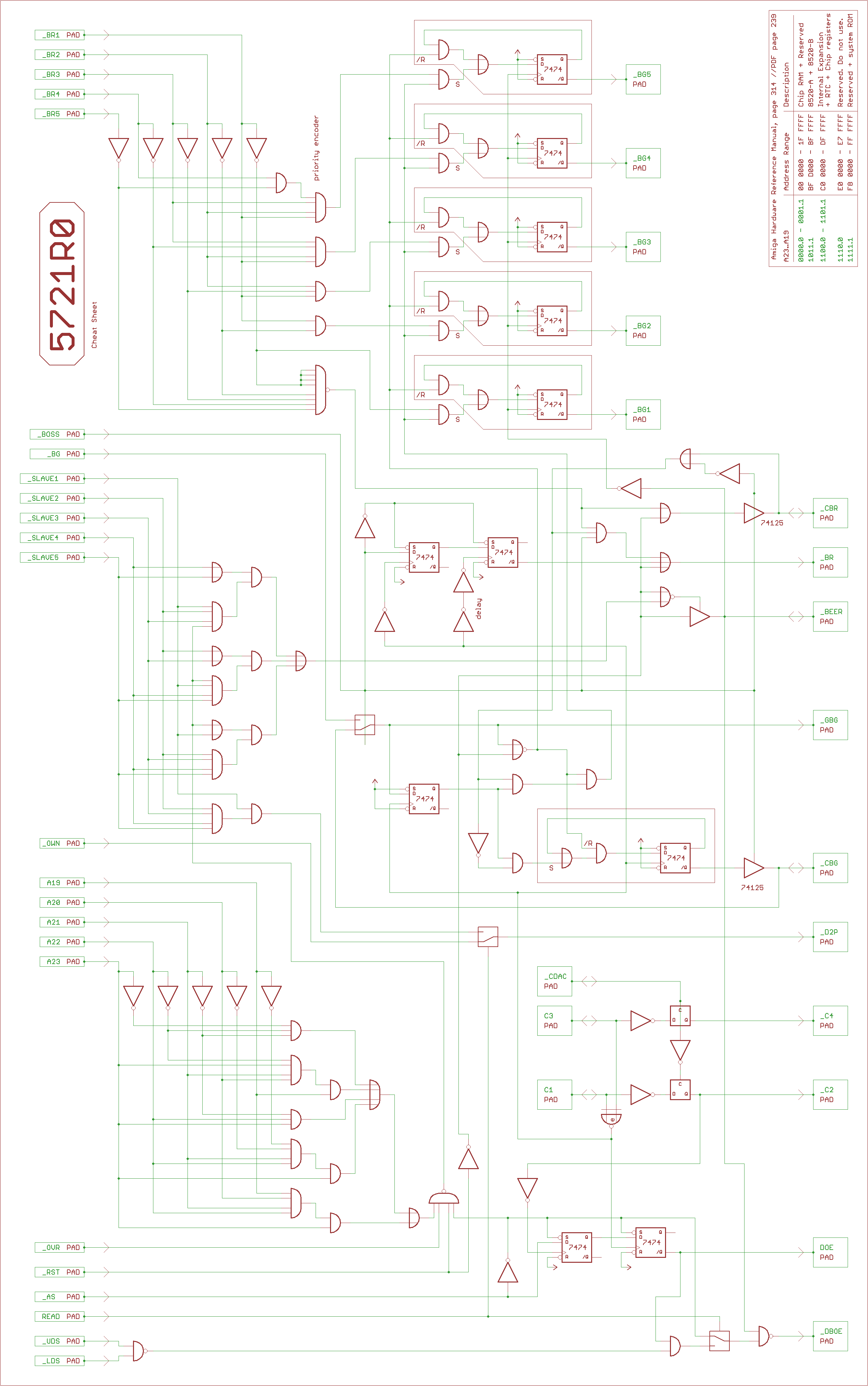

5721R0 Cheat Sheet:
Schematics in *.png and Eagle 6.4 file format:
5721r0_schematics_png_eagle6_4.zip [2.8 MiB]
Downloaded 8 times

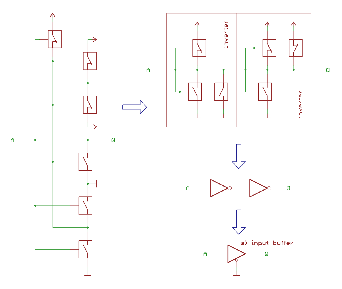

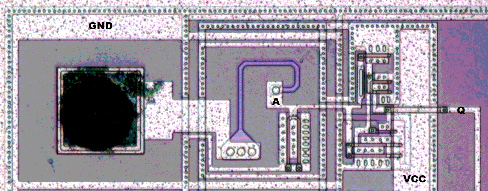

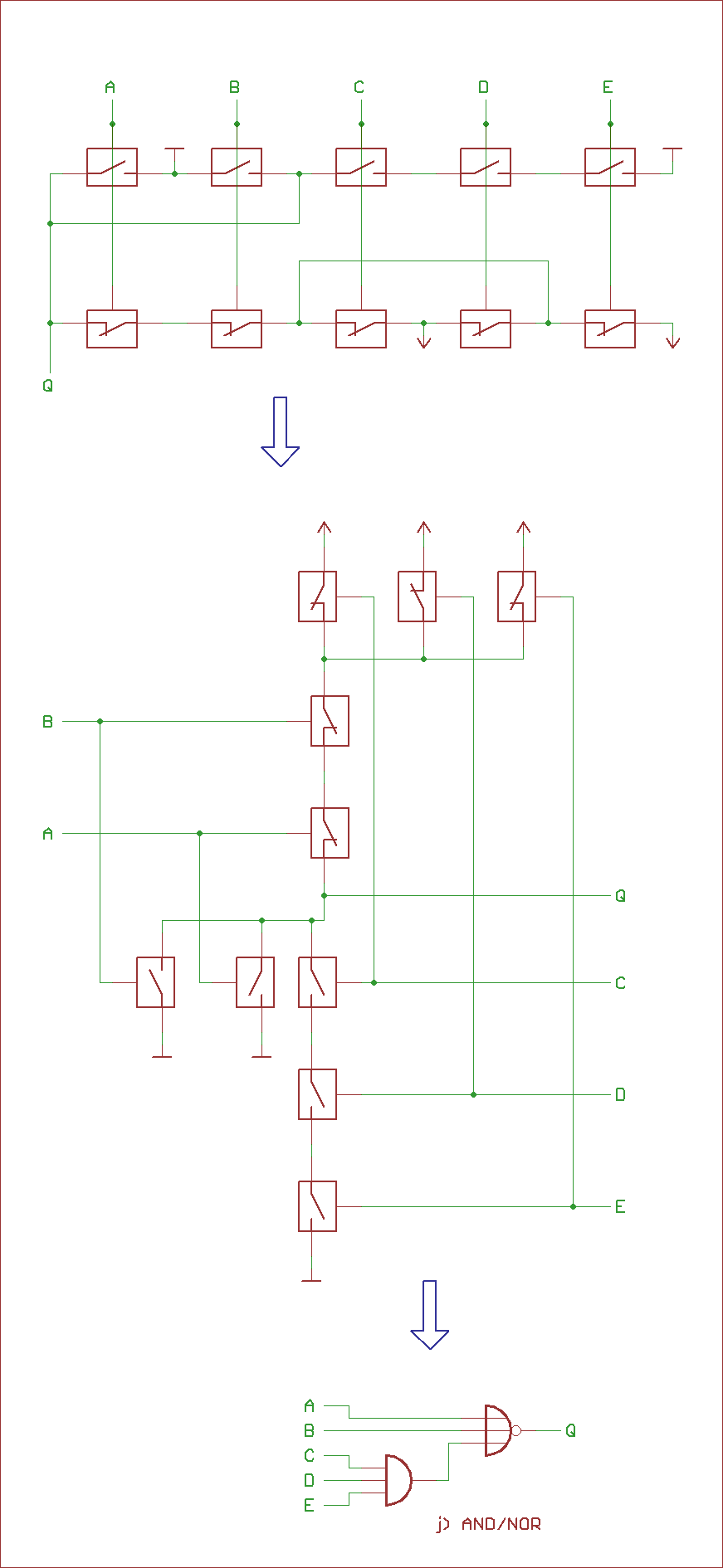

PostPosted: Thu Aug 01, 2024 9:28 am
Posts: 1431

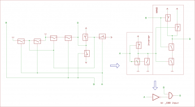

PostPosted: Thu Aug 01, 2024 9:29 am
Posts: 1431

PostPosted: Thu Aug 01, 2024 9:39 am
Posts: 1431
