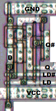

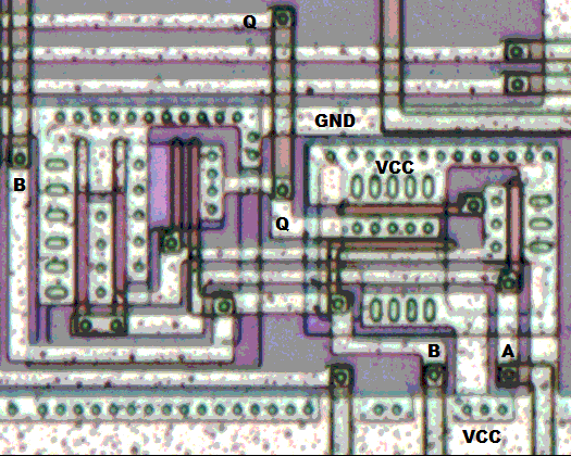

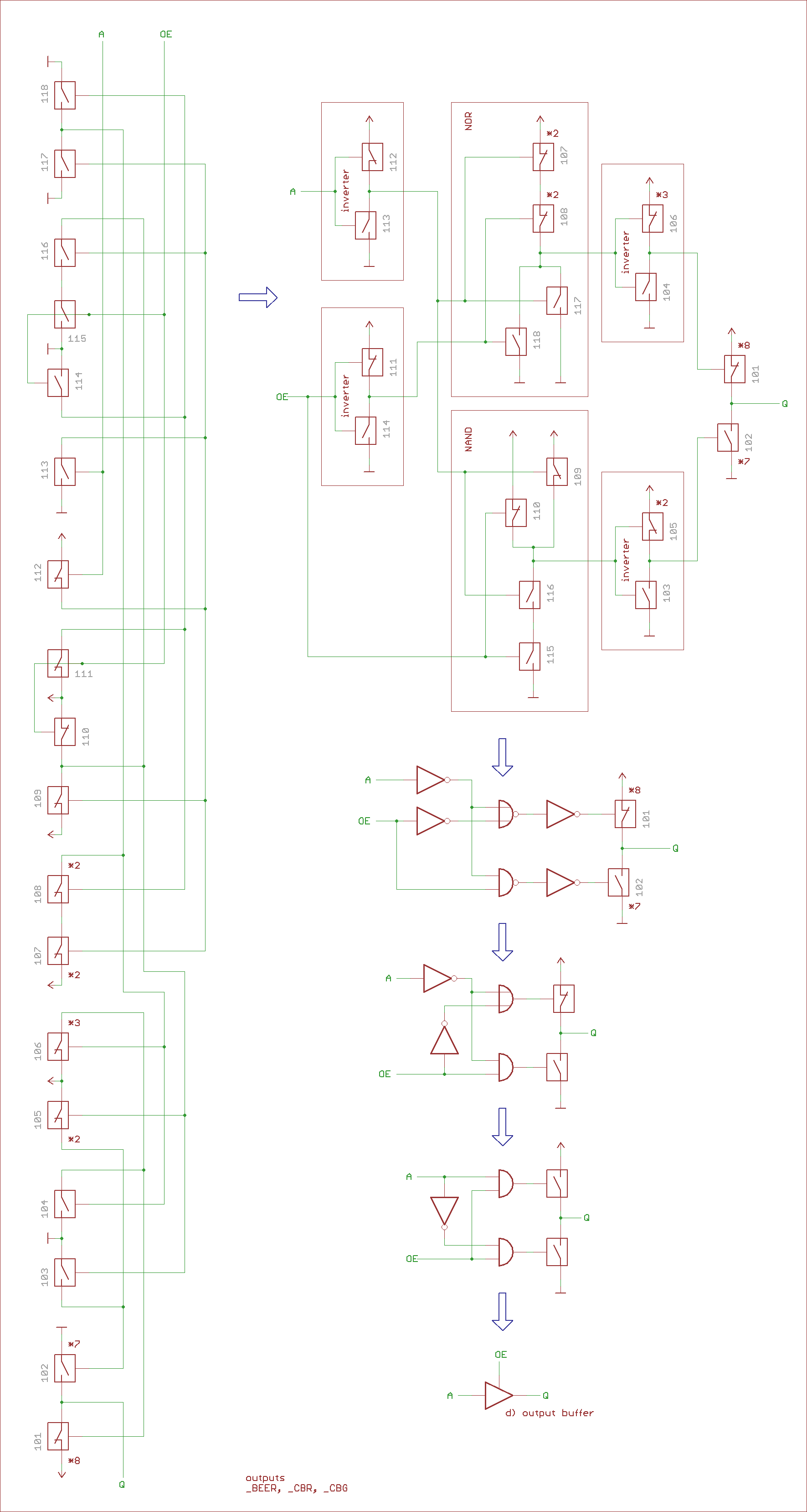

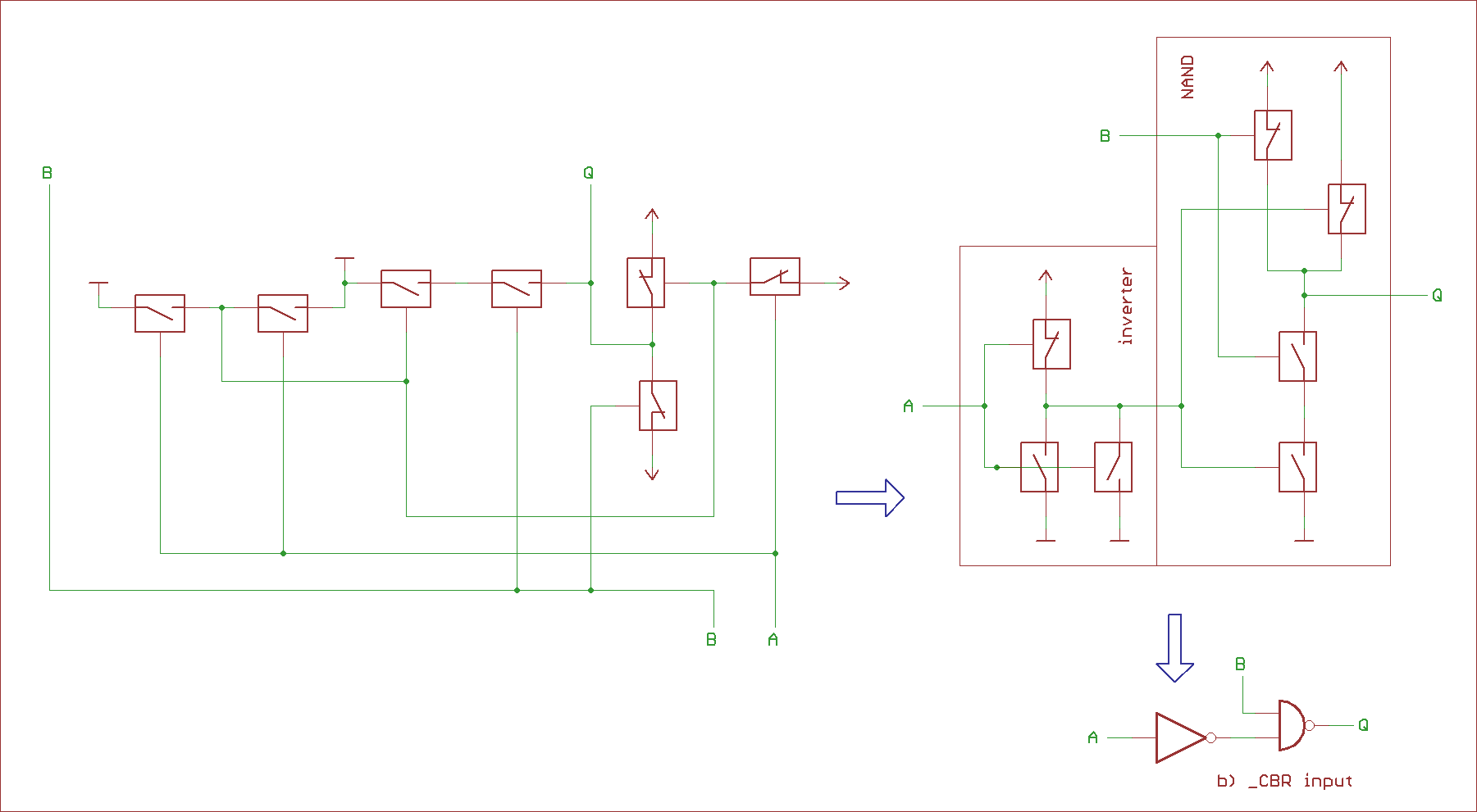

The basics for dissecting CMOS chips already were covered
in the 5719R4 dissection.
CAD at MOS\CSG noticably had improved since the 5719R4.

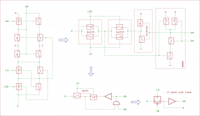

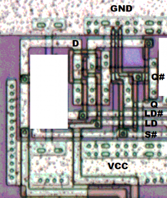

In the 5721R0:
Standard cells are rotated in 90° steps.
Layout for the latches now is incredibly compact.

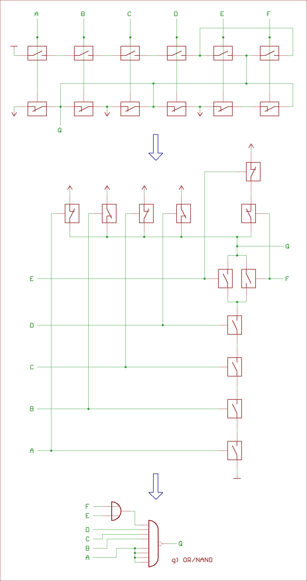

Also, we now have CMOS combination gates, like AND\NOR and OR\NAND.
As a reference for further CMOS chip dissections,
I'm putting a catalog of the standard cells I had found in the 5721R0 here:
