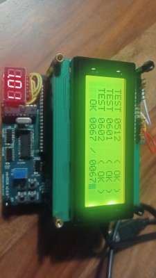

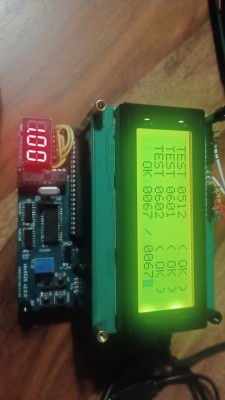

In the meantime, I had to resolder a handful of ICs on U2/B4. I might have been a bit over-excited as this was the last board, and I make a lot of mistakes there. But... in the end... brace yourselves for a nice photoshoot!
This is a real OLD 6526 passing all tests on my SBC.
Same for a NEW 6526. Of course, nothing can be seen here. If you want to revisit the differences between OLD and NEW CIAs,

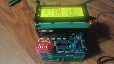

Now, for the real fun.
U1 in OLD MODE
U1 in NEW MODE
U2 in OLD MODE
U2 in NEW MODE
The failed test on both U1 and U2 in NEW MODE, is the TOD interrupt test. There's a few cycles difference I can't yet explain. However, this is only evident when I am ticking TOD programmatically, so, instead of 60 times per second (or 50) I can do it at will. When I am counting real time, 4 cycles is not going to matter.
This does not prove my design to be cycle exact. I am only testing for regular situations, and I am not aiming at edge cases. The VICE Test suite will take care of that.
