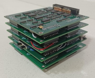

Please meet the last member to join the family:
TOD is done and, after my initial tests, it mostly works, with only a couple of issues that can be easily be fixed :)
This is the full stack.
That is all. The 74HCT6526 is now complete. Yes, still buggy, but complete. Let's see what our issues are.

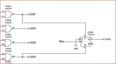

- On powerup (or reset) TOD should not be counting, but it is. A write to the tenths register starts the count, a write to the hours register stops the count. On my design, TOD is and-gated with a signal I've called COUNT.
The idea was... when /RES goes high, that became a clock pulse for the flipflop that generates COUNT. With its Data pin tied to GND... on reset, COUNT should be 0. Right? Nope. Wrong. As I'm forcing a write to all registers on reset, /LOADT and /LOADH are active, so both /SET and /RESET inputs to the DFF are asserted simultaneously. When the /RES, /LOADT and /LOADH finally goes high, COUNT is always 1.
This will be fixed by taking /Q as COUNT, and swaping /LOADT and /LOADH on the flipflop.
The design was, after all, correct. The data input to the FF was floating so... Fix this, and COUNT is working now as expected.
