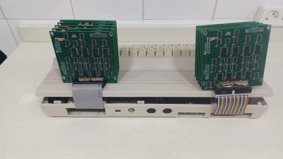

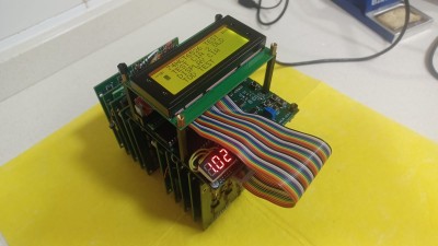

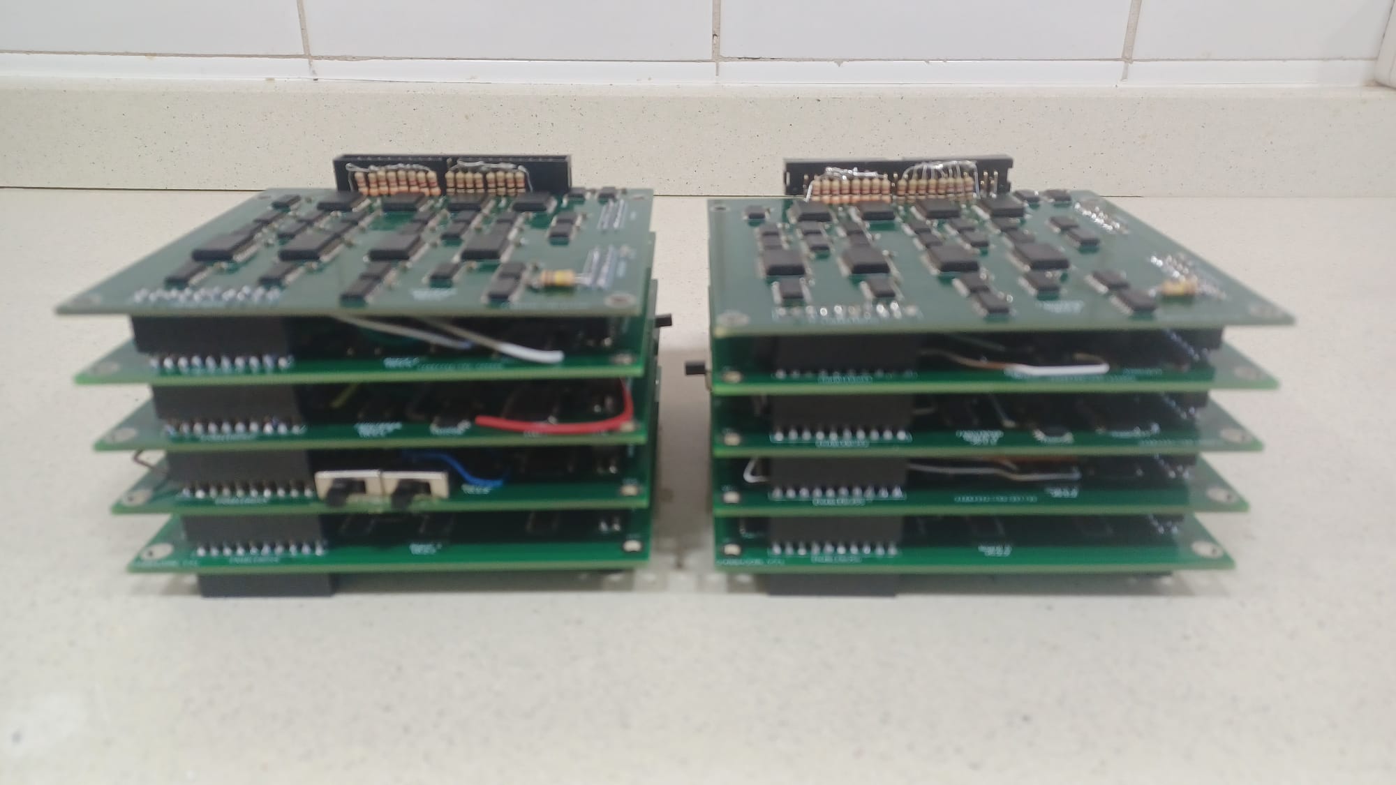

Hi everyone!
With the new year almost here, it's time for my End-of-Year update.
Not much has changed since my last post. As usual, I've gotten lost in a few other completely unrelated projects. Now, with the holidays here and an awful flu season, no more work will be done here until next year.
So... where are we?
Both units are now completed. Unit 1 is passing all my tests except for the SDR send, which is driving me crazy. After tinning and retinning the stack connectors, it now feels solid with no connectivity issues. Unit 2 has some issues with its TOD, most likely caused by bad soldering. It will need some work, heat, and love, but it will work, same as TOD1. Interestingly, SDR also fails. I have proof it did work at some point; otherwise, I would doubt it myself! Again, nothing unsolvable, I hope. Getting all of this working is my next step.

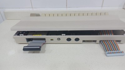

Meanwhile... I've been preparing my C64 to receive the two 74HCT6526s:
As pretty much everything works, except for TOD2, I gave it a try and powered up the computer with both 74HCT6526s connected. I was hoping for it to work OK, but... nope. It fails to boot. I get the familiar light blue border + dark blue background screen, but that's it. This means the C64 partially works. The CPU is able to run code, initialize video, but then it seems to crash. Again, I didn't spend any time at all looking into the problem, as it was just a quick try.
The second step then, after getting both 74HCT6526s to work OK, is to get them working with the C64.
And then... testing, testing, and more testing.

Well. No. All past-me's were wrong. I now have two full units, which go by the names of U1 and U2. U1 indeed works as expected, but U2 didn't. No matter what I tried, TOD was counting after reset. I was starting to think that asserting both /SET and /RESET was not a very good idea, as any slight delay in the signals could mess with the outcome. I tried replacing the 74HC74 and, not so surpringly, I got different behaviours with different brands. Bad design!
I inserted a new DFF (I had a spare on board) to delay the /LOADH signal to the flip flop by 1 cycle so, in the event of both /LOADT and /LOADH being active at the same time (Which, btw, only happens during reset) /LOADH would be one cycle late, keeping TOD stopped, as expected.
And yes, now, the design is correct, and works as expected. Always. Yay!
In the meantime, I had to resolder a handful of ICs on U2/B4. I might have been a bit over-excited as this was the last board, and I make a lot of mistakes there. But... in the end... brace yourselves for a nice photoshoot!
