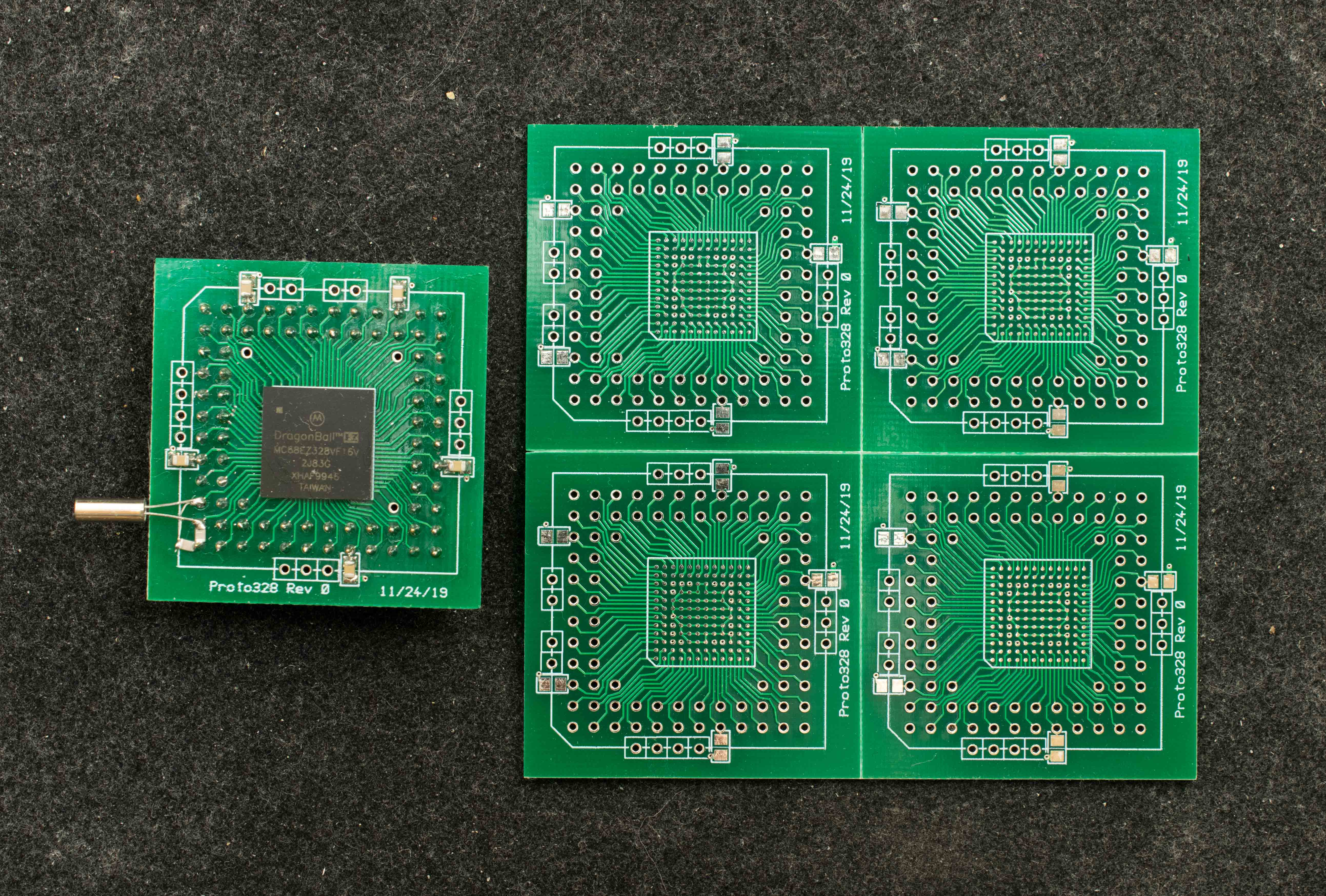

I've accidentally acquired large number of 144-pin BGA and tried to work with it on and off. The latest attempt had vias in some BGA pads. I built a 2-layer prototype, made the board thin, filled the vias with solder and tried to solder it with hot air, but wasn't very successful. Only 1 out of 4 worked. I may try again with a hot skillet.

Your goal should be:
1) ultra clean BGA pads, no solder
2) plenty of flux applied to the clean BGA pads
3) use a hotplate to heat the bottom of the circuit board evenly and maybe a little hot air on the BGA to help. You should see the BGA slump abit and maybe even self center if your lucky!
Best of luck bro! I'm a novice myself
