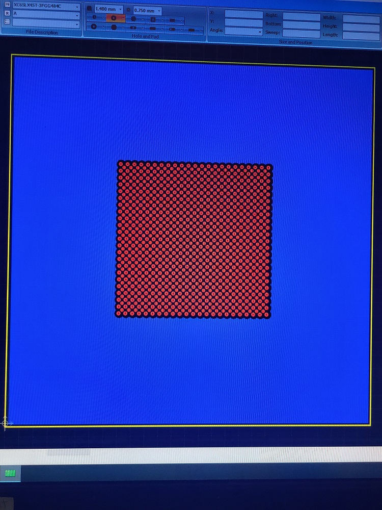

Hello friends, I have decided to return to electronics. Of course my focus is on AMD/Xilinx FPGA and 6502 based programming/softcore CPU. I see a few things which give me encouragement! Spartan 6 has lifespan into 2030+ and my preferred board manufacturer ExpressPCB still exists... These are my 2 common denominators for this chapter. Please do not try to convince me of better things. I need to be focused.
I have an itch to continue my 16-bit 1080p video project. It never had page flipping as I was using 1x 2Mx18 SyncRAMs and the amount of usable pins from a Spartan 6 144-pin TQFP package was not enough to accommodate 2x RAMs. Hence the need for large pin count BGA type FPGA, which I've failed at before documented here. Somewhere.
This project will start off surmounting a problem of my understanding of the board manufacturer software ability to place soldermask over a via, which are typically located in between 4 BGA pads. This has been a problem for their software in the past and the reason I had given up. I was not prepared to pay thousands for a software program to create a gerber file and also switch board manufacturers. Too much money already invested in 'the process'. Again please refrain from trying to convince me of other companies, either software or board manufacturer.
This will be approximately a 54mm x 54mm adapter board with a 484 Spartan 6 XC6SLX45T FPGA in the center. All signal header pins will be as close as possible to the FPGA. It will be a 6 layer board with the 3 voltage regulators, JTAG header and FPGA SPI FLASH and crystal oscillator all on board.
The goal here is to mount and program a 484pin BGA Spartan 6 on a board I can mount to a breadboard (push in) or for wire-wrap for testing different modules, instead of mounting alot of expensive IC's on 1 PCB board. This time I will take a modular approach.
Hello again to this great community and all comments welcome!
File comment: Max vias and BGA pads

Yesterday I was able to place individual polygons over the vias on the soldermask level and after receiving a response from ExpressPCB, this is indeed the way to do it, although it seems abit clunky to me. It seems more natural to just have an option for vias to be masked or not. Oh well, problem solved.
I am debating whether to send in a 2 layer test board ($88) to make sure the process on the top level is 100%, also get the Spartan 6...

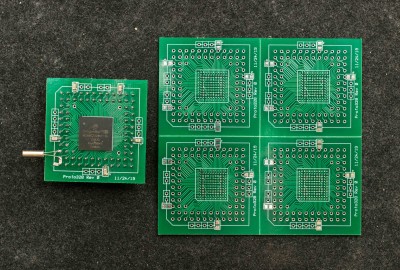

I've accidentally acquired large number of 144-pin BGA and tried to work with it on and off. The latest attempt had vias in some BGA pads. I built a 2-layer prototype, made the board thin, filled the vias with solder and tried to solder it with hot air, but wasn't very successful. Only 1 out of 4 worked. I may try again with a hot skillet.
Hi plasmo, I feel your pain. I have tried a 256-pin BGA with similar success. I too have had exposed vias in between the BGA pads, i.e. no soldermask. This is probably THE biggest mistake you are making and that I had made. Also, no vias for BGA pads. This topic has come up before here. The hole will wick the solderball right off the IC.
Your goal should be:
1) ultra clean BGA pads, no solder
2) plenty of flux applied to the clean BGA pads
3) use a hotplate to heat the bottom of the circuit board evenly and maybe a little hot air on the BGA to help. You should see the BGA slump abit and maybe even self center if your lucky!
Best of luck bro! I'm a novice myself
