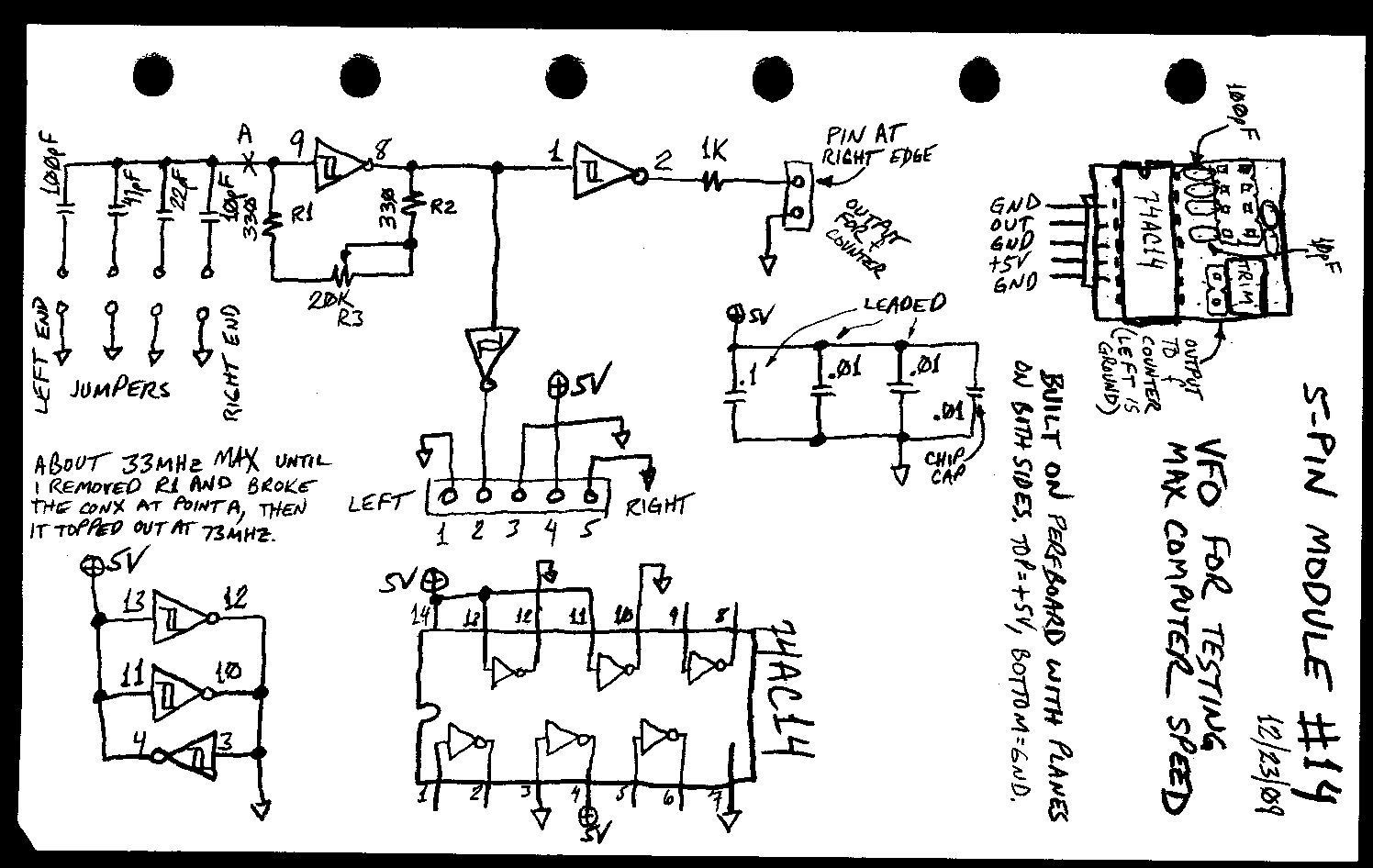

You can also make a variable-frequency oscillator (VFO) (or get one as a piece of workbench equipment).  I have bench VFOs for up to 300MHz but not one suitable for a square-wave TTL (or 5V CMOS) levels beyond a couple of MHz, so I've made a couple.  I made the second one (shown below) for an upcoming project where I wanted a maximum frequency higher than I could get with the first one which is of similar design.
This is a page from my 3x5 ring binder which is a quick-reference guide for all my workbench-computer-related stuff:
I initially had a little pin header for jumpers to select additional input capacitance for lower frequency ranges as shown in the upper-left corner of the drawing, but even with none of the jumpers installed, the tiny bit of capacitance between the top pins and ground was holding the maximum frequency down, so I cut the connection at point A (marked with the "X", near pin 9), and also shorted out R1, bringing the max up to 73MHz.  After dividing it by two with a flip-flop, that makes for 36.5MHz which is at least 50% faster than I expect to get from a home-made 6502/816 project.  There are 6502's that will do 200MHz, but they're part of a custom microcontroller that's for a specific use, and have memory and I/O onboard the same IC.  Even if they were made a standard product, you wouldn't be able to get fast enough logic and memory for it or build suitably for running that fast.
The idea for using the VFO is to increase the frequency until the computer starts having problems, measure the frequency, back down a little bit, and then buy a standard crystal oscillator can for the result, whether that turns out to be 16MHz, 14MHz, or whatever.
The reason for connecting the unused sections of the hex Schmitt inverter to the power and ground planes as shown above is to effectively reduce the power-lead inductance for better behavior at high speeds, since 74xx DIPs' pinouts were set to be at the corners decades ago before designers could foresee rise times reaching such speeds that the lead inductance would be a problem.

One thing that strikes me - is shorting the outputs wise? Definitely do the inputs, but with CMOS logic the outputs should be driven hard enough to be a non-issue, and I'd rather not deal with the possibility of accidentally activating the device's clamp diodes.
Since it's an inverter, and CMOS gates basically pull the output all the way to one rail or the other anyway, I figure you're kind of giving it an extra power or ground connection through the output if you connect the input and output to opposite rails. The clamp diodes will only conduct if you take a pin outside the power supply range; and actually that will happen less if you reduce the ground bounce by providing these extra power and ground connections.
