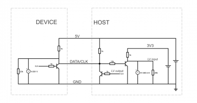

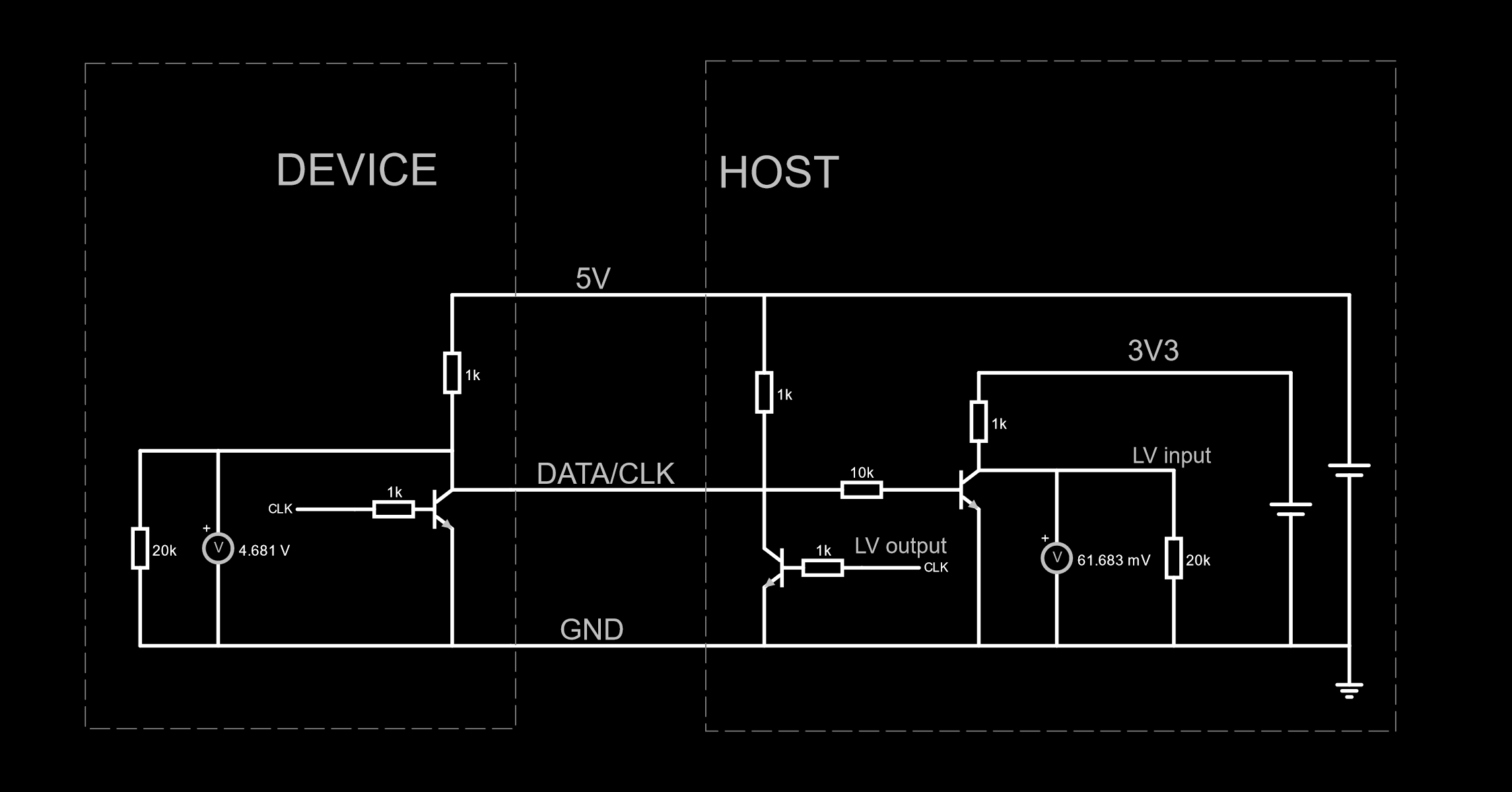

It's an open-drain interface so you're meant to pull it to your power rail with resistors. Are you seeing the keyboard pulling up to 5V itself? I'd imagine this is harmless, and it'd be fine for you to connect that down to your 3V3 rail with diodes, clamping it at that level - the keyboard's end should be very high impedance so not much current should flow through the diodes.
Edit: It sounds like keyboards may well have their own pull-ups, e.g. about 2K. It is possible that the keyboard also requires the line to reach close to 5V at the bottom of that pull-up resistor. So the diode solution might not be good, you might need more active level conversion, either an open-drain level converting IC or a couple of transistor-inverters, one for each direction, like this: https://www.falstad.com/circuit/circuit ... geCCnlUJAA
In that example the left portion represents what's in the device, and the right is what's in your host; and I've rigged it so that the device and host both periodically pull the signal line low, so you can see that they then both see a good voltage swing at their inputs when the other device does this to the signal line. You can try removing the device's pull-up resistor and see that the circuit works fine whether it has one or not.

Yes, I'm not sure how much you can rely on the keyboard being 3V3-tolerant but YMMV. Note I edited my post to include a link to a possible circuit in falstad, using two transistors per signal line, that allows connection to a 3V3 host but still gives good voltage swing at the device regardless of its own pull-up capability.
Ouch! Oh, man, do I hate that color scheme! :roll: I find black on white to be a big improvement:
And what's shown below is, in most circumstances, an improvement to the circuit itself.
