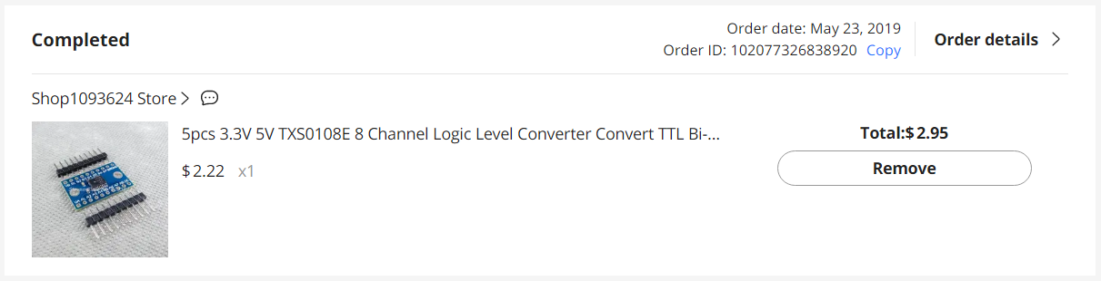

There are some nice 8-channel TXS0108E 'modules' available, too.
