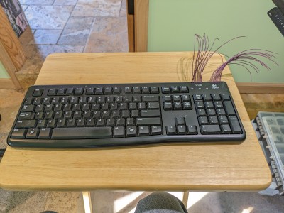

Keyboard hacked:
To avoid using USB and any associated CPUs, and to get lower keypress latencies and better overall control of the keyboard access, I’ve bypassed the KB120 onboard controller and connected wires directly to the keyboard contact matrix. This matrix is formed out of two clear plastic sheets that are each made into a kind of circuit board with silvery traces, but can’t be soldered at any temperature significantly above room temperature. I used the original controller board just to get the connector fingers. Unfortunately these are covered in black, evidently carbon-rich gunk that is hard to get off. After a lot of scraping and using Q-Tips with 91% isopropyl alcohol, I was able to solder hookup wire to the original pads and put them into the crimping system that the keyboard came with. Here is the result, with the keyboard all put back together:
File comment: Keyboard KB120 hacked to get direct connections to the contact matrix
So far, my spot checks on the matrix connections with a ohm meter indicates this was successful, and I should be able to make a controller/scanner circuit to detect and record keypresses to send to the CPU later.

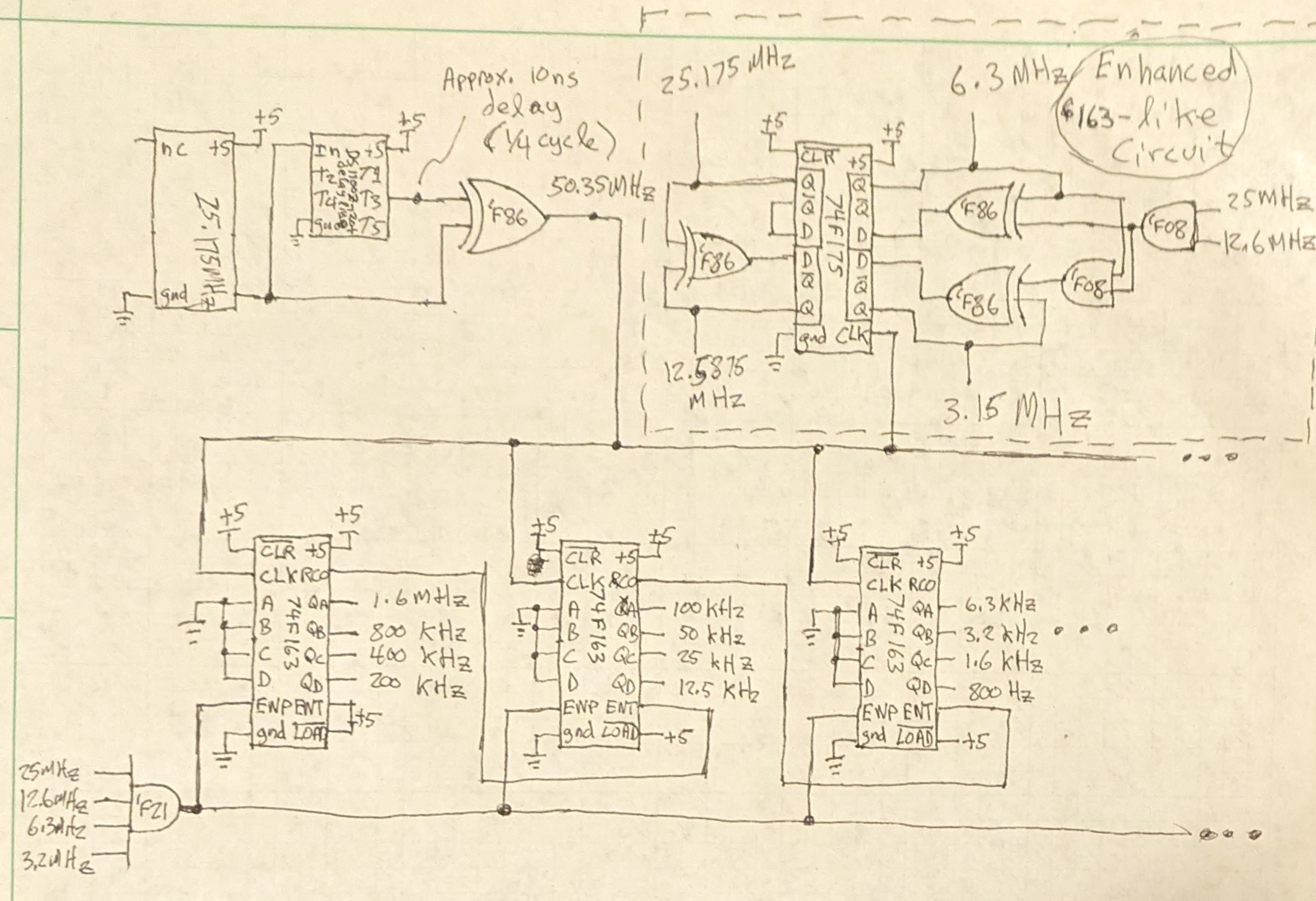

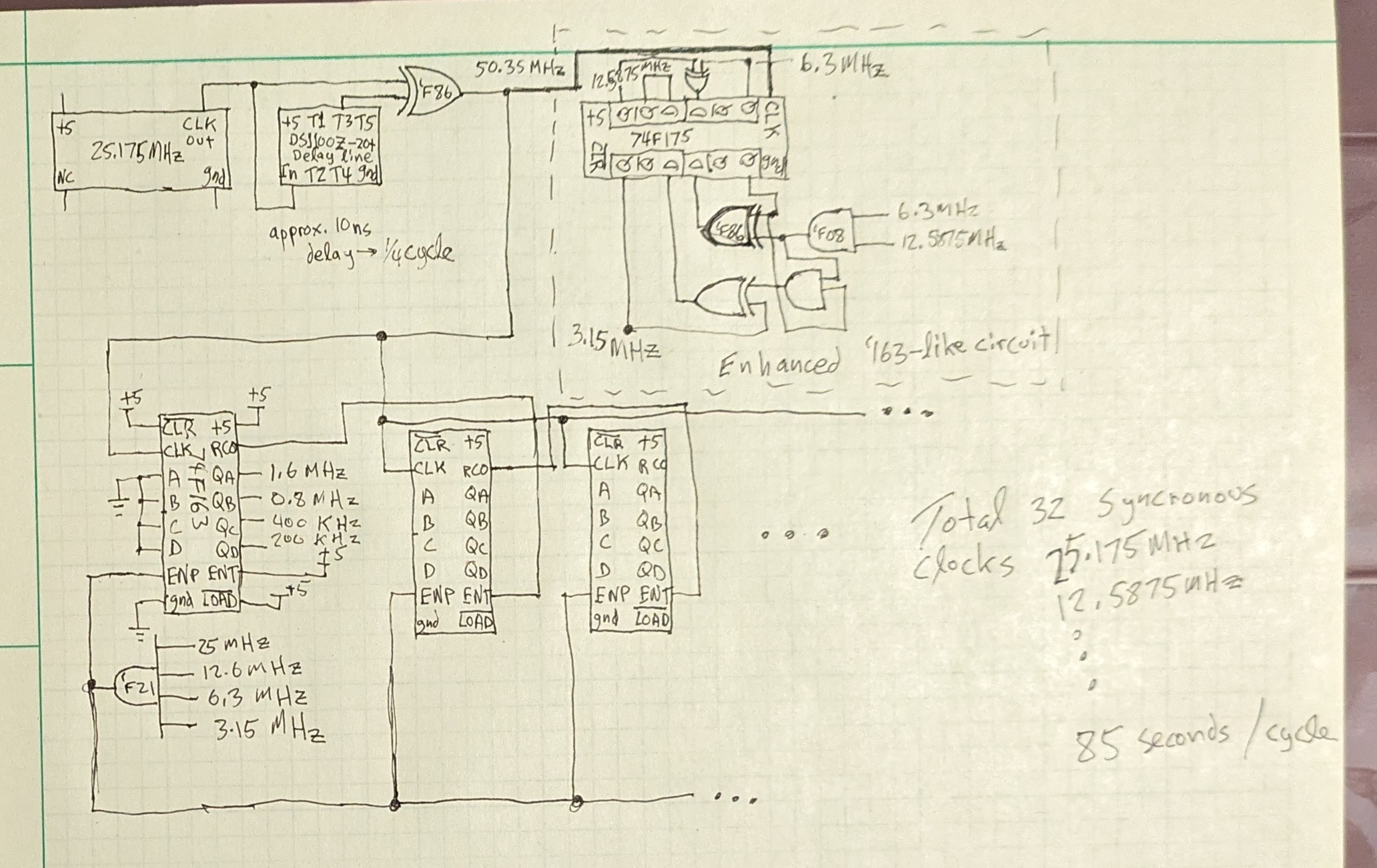

Improved clock module
So to get 25.175 MHz and all divisions by two from that to line up, it helps to have a 50.35 MHz clock to drive these. I have not seen this specific frequency of oscillator module for sale, so I decided to make my own by making a frequency-doubling circuit for my 25.175 MHz clock signal. There are a large number of ways to do this, including some fast analog filtering and rectification bridges, but the simplest seems to be to add a delay line chip to get a ¼ cycle delay and XOR gate inputting the original and delayed clock signal. Initially I just used three 74F04 inverters in series for an appropriate delay, and it worked, but this is really fragile in several ways, and not reliably repeated on a second build or tolerant of parts swaps or temperature changes etc. So I’ve put to use the Maxim DS1100Z-20+ silicon delay line module, that has five taps at multiples of 4ns delay. I use tap 3, nominally 12ns, since that seemed to give a slightly better 50MHz signal with the limited visualizations I could do on my cheap scope. I suppose I could have put in an automated duty cycle optimization circuit based on averaging the clock signal over a long (1000’s of cycles) time window, and comparing to an ideal voltage, but I just want to move on for now.
In addition, I wanted to improve so that all my highest frequency signals have symmetric inverted variants. So I designed my own “enhanced” `163 counter-like circuit using 74F175 quad flip flops and various supporting gates. The flip-flops output symmetric inverted/non-inverted pairs.
Also, since I am clocking all my counters at a *much* higher 50MHz, I went with the fast `163 circuit design, separating the high-frequency part of the carry look-ahead to the ENP pins on the counters all connected together, and the propagation-delay low-frequency chain on RCO-ENT-RCO-ENT-... Here is the overall schematic (LRC appropriate – no computers used!):
File comment: LRC improved clock module schematic
Overall this works great, and I have 32 synchronous power-of-two clock signals going from 25.175 MHz down to a cycle time of around 85 seconds. I believe this will help make for a simpler design and timing analysis process, and hopefully more reliable designs at the end. Here is the prototyped module in action:

Nice update, that keyboard must have been frustrating - I don't like soldering things that don't want to be soldered!
The counter solution is good too, it sounds like you're building a solid foundation there. I like the 175 with its inverted outputs and common clock. I think you mislabelled some of the frequencies in that part of your schematic though, especially the top half of the chip!
D'Oh! I did mislabel those frequencies, and the schematic was a bit too messy, so I've made a (hopefully) better version:
File comment: LRC improved clock module schematic, take 2
On the keyboard mod messiness, someone posted a nice little custom board that replaces the original and has the pads/fingers on the edge to make contact with the keyboard matrix sheets. I did not want to go that far for now and just did the more hacky thing.
