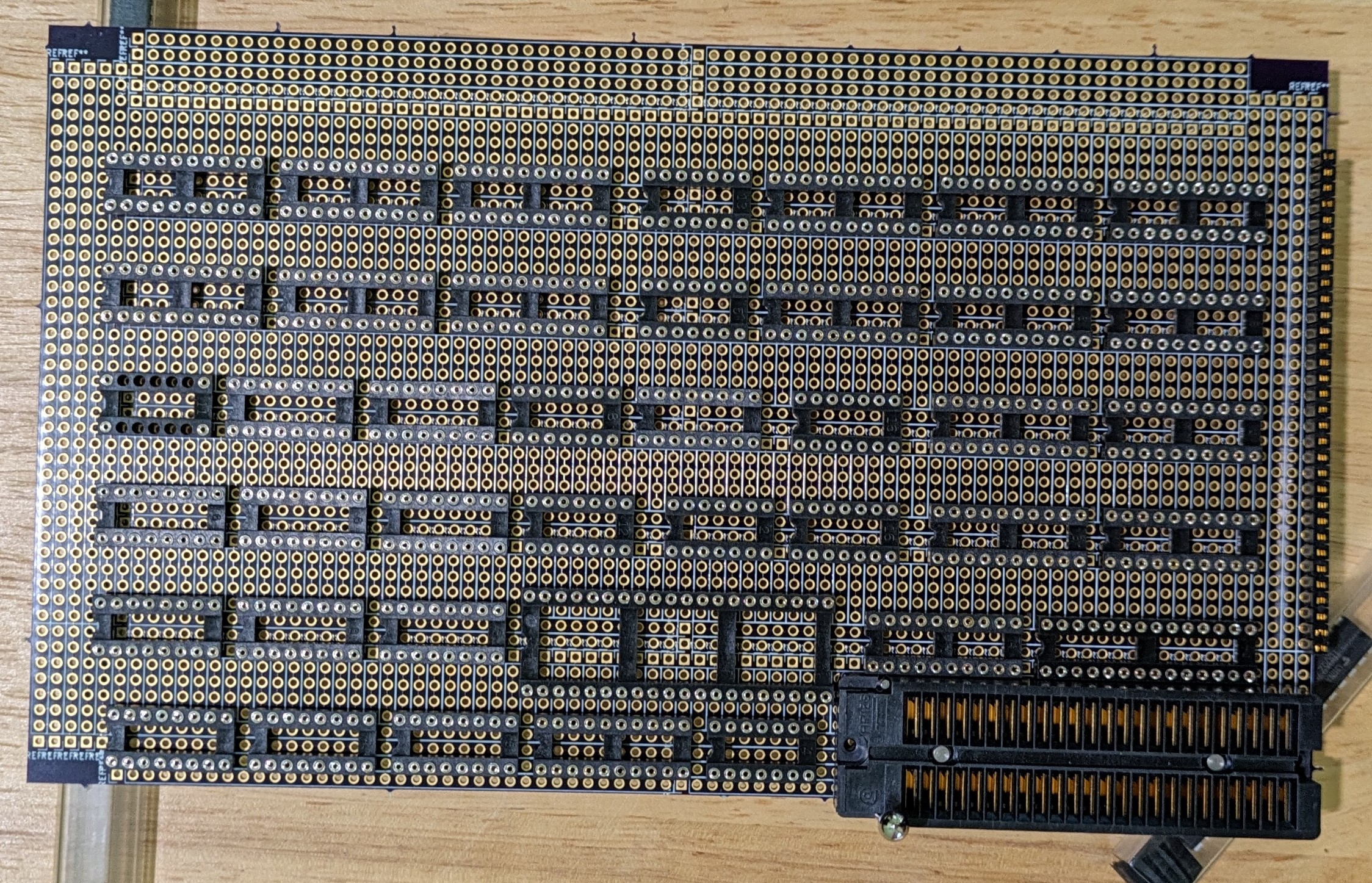

Planning soldered breadboard
Since the proliferation of solderless breadboards was getting out of hand and started to be very finicky to keep going, I’ve decided to make a soldered version of the CPU+video modules, plus some generic memory-mapped I/O parts of the font editor module. My self-designed generic breadboards support only three rows of chips if you don’t cut traces, but I realized that by cutting some traces like you would with stripboards, I could pack six rows of chips onto the breadboard. The tricky thing is to optimize/arrange the layout of the chips and trace cuts to support all the wire connections needed. Here is a diagram I started working on to do this:
File comment: Soldered locker-room-challenge initial board layout puzzle
The red lines are where the trace cuts (or edge of the board) would go. Note that I’ve put space between chips that can act as wire fanout enhancers for high-fanout lines like some important clock lines. Anyway, this is an interesting puzzle to work out. Here is what the layout looks like when I put sockets, unsoldered for now, into the breadboard to see how things would work out of what issues might arise:
File comment: LRC actual breadboard testing initial layout
The ZIF socket for the NVRAM is a real beast, pushing things away and causing layout grief. It is also very high profile, as is the NVRAM on its adapter board, so any module stacked on top of these will need a cutout in that corner.

I hadn’t really been thinking about fanouts being an issue, as generally a decent logic family like 74F has something like 30+ fanout if you stick with the same family. However, as I was planning my soldered LCU (Locked Room Challenge) SBC, and adding lots of bytes of latched+buffered memory-mapped I/O, I started to worry about fanout with respect to the W65C02S CPU. Looking at the data sheet I was horrified to see that the CPU can only be expected to drive 1.6 mA (the Iol max rating), which is able to output to less than three 74F inputs! Yikes! I’ve seem some mention on the forums that this part of the WDC data sheet is extremely conservative, but I don’t want to design into dicey territory. So I’m planning to latch the address and data lines on CPU write, and from there write to a bunch of output latches. I will actually reuse the three 74F374 latches I am currently using for the CPU-to-video-ram write, and have that be used for both memory-mapped output generally as well as video ram writing.
In any case, this has caused me to rethink my design to make other improvements I’ve been thinking about. Back to my first module, the power-of-two clocks bank, I’ve found it messy and potentially limiting to have my higher frequency clocks asynchronous from each other (25 12.6 and 6.3 MHz don’t line up with each other). Solution below.
Sounds like a non-trivial alteration. :|
Would you bother with all this extra work if the fanout issue were magically solved? Because I suspect it easily can be, if you'll just swap out most or all of those creepy 74F series chips!
The inputs of CMOS families such as AC, AHC, LV and others (including the related "T" variants) have essentially zero DC loading, making fanout unlimited in that regard. At some point (>10 inputs driven?) you do begin to need to pay attention to the AC consideration of input capacitance, but that issue is a great deal less limiting than the DC constraint.
The 74F Series is a bit of a dinosaur, IMO. Its speed is the only thing it has going for it. The power consumption is high, and it supplies only TTL output levels. In some cases TTL output levels are more or less OK, but when driving WDC CPU inputs they're asking for trouble. 74F input levels are also TTL, which means noise immunity is inferior to the CMOS families I mentioned (other than the T variants, of course). More on logic levels and WDC here.
74AHC/AHCT is probably the most forgiving option to work with. 74AC/ACT might be a bit faster, but its outputs -- like those on WDC CPU's -- have aggressively fast rise and fall times. (And 74F probably isn't much better, although I admit I haven't checked.)
Thanks Jeff for the heads up on W65C02S input levels not being quite TTL compatible! Nice write-up that I will dig into.
I did spend a bit of time settling on 74F, and some of the main pluses are speed and availability of a wide variety of parts, plus easier prototyping with through-hole pins available. For example, you can get 74F21 (dual 4-input AND)
or 74F175 (quad flip flop) but thereare no 74AHCT equivalents available. I'd be super happy to have something like the super fast CMOS families if I could get enough diversity of parts and through-hole pins and no weird level translations talking to the W65C02S running at 5v. I didn't want the hassle of figuring out which 74 series to use for which function, and instead just keep everything in the same family for the most part. Eventually, when I either get out of "locked room challenge" mode or get to a point where I can bootstrap myself to a certain level, I might switch to CPLDs for the speed and reduction of chip count.
Through-hole pins are a big win on rapid prototyping for me -- it is a tedious, long, and error-prone process for me to solder the teeny little SMDs to adapter boards.
Also, I'm already using `374s to latch the CPU address and data on video RAM write -- I'm just going to expand the use of those same three chips to capture all writes and go from there to both video RAM and to the bank of memory-mapped output latches, and even put those onto the expansion bus pins. So mainly a bit of control logic changes, in some cases making things a bit simpler, in some cases a bit more complex. The only downside is a bit of increased latency in writing to the memory-mapped output latches, but I don't think that matters for any practical purpose I can think of now.

Alright, Mark... I do understand and sympathize with your position. And I didn't mean to come across as though I expected you to re-engineer the whole project all at once.
But some piecemeal changes may bear consideration, particularly in regard to signals that need to get input by the CPU. Much as you may prefer to avoid mixing logic families, you *are* in effect doing so as long as your recipe includes both 74F series and that WDC CPU. :!:
One solution would be to swap out the WDC CPU and put in a non-WDC 'C02 such as Rockwell, as the latter has inputs that do respond reliably to the TTL levels output by 74LS, ALS, F etc.
The alternative solution is to use a CMOS logic family such as HC, HCT, AC, ACT, AHC, AHCT etc for any chip whose output needs to feed an input on the WDC.
And it really isn't that much hassle to get up to speed on the various families. Where simple logic chips such as gates and flipflops are concerned (as opposed to memory and LSI), we can summarize the issue of voltage levels as follows (and I'll assume all the chips are powered by 5V, as in your project): There are just three basic categories. For reliable operation, ...
    - HC, AC, AHC etc require a full voltage swing at their inputs. They provide a full voltage swing at their outputs.
    - HCT, ACT, AHCT etc can accept the smaller TTL voltage swing at their inputs. They provide a full voltage swing at their outputs.
    - LS, ALS, F etc can accept the smaller TTL voltage swing at their inputs. They provide only the smaller TTL voltage swing at their outputs.
A WDC 'C02 has the characteristics of the first category. A Rockwell or other non-WDC 'C02 has the characteristics of the second category.
Thanks Jeff, indeed the main chips outside the NVRAM that output to the W65C02S are `373s in the updated design I'm working on, and it looks like 74AHCT373 is similar in speed to the 74F373. So I think I will order some of those for that specific purpose. In general though 74AHCT seems slower and has less through-hole parts available than 74F, so I'll stick with the F's for the rest for now. I'm not inputting a lot of control signals into the CPU, but there is phi2 and reset in my case. Reset is not a big deal, but phi2 I really want to keep synced with all my other clocks, and unfortunately I don't see a 74AHCT175 available, and the 74HCT175 is way too slow. There is a 74ABT octal flip flop that seems interesting, but it doesn't have the symmetric inverted/non-inverted outputs. Also, my clock lines go all over the place, so if I change those outputs to a lower Iol family, that forces me to move away from 74F just about everywhere. Is there some super low-latency (say < 2ns) way to level shift the phi2 input to the CPU while running at 12.5875 MHz while keeping the CPU at 5v? Something like SN74LVC1T45, if I'm reading the data sheet correctly, can do the translation in around 7ns max, but that is too slow for my purposes. Hmm, looking around I see 74ABT74, but some of the specs like max input rise rate seem scary...I'll need to keep looking.
[Edit: Okay, looks like I can use a 74AHCT74 flip flop running in parallel with the 74F175 for the high frequency counting for the 25.175 MHz and 12.5875 MHz clocks, and the propagation delays are maybe within 2ns of each other, but it will require the one extra chip.]
