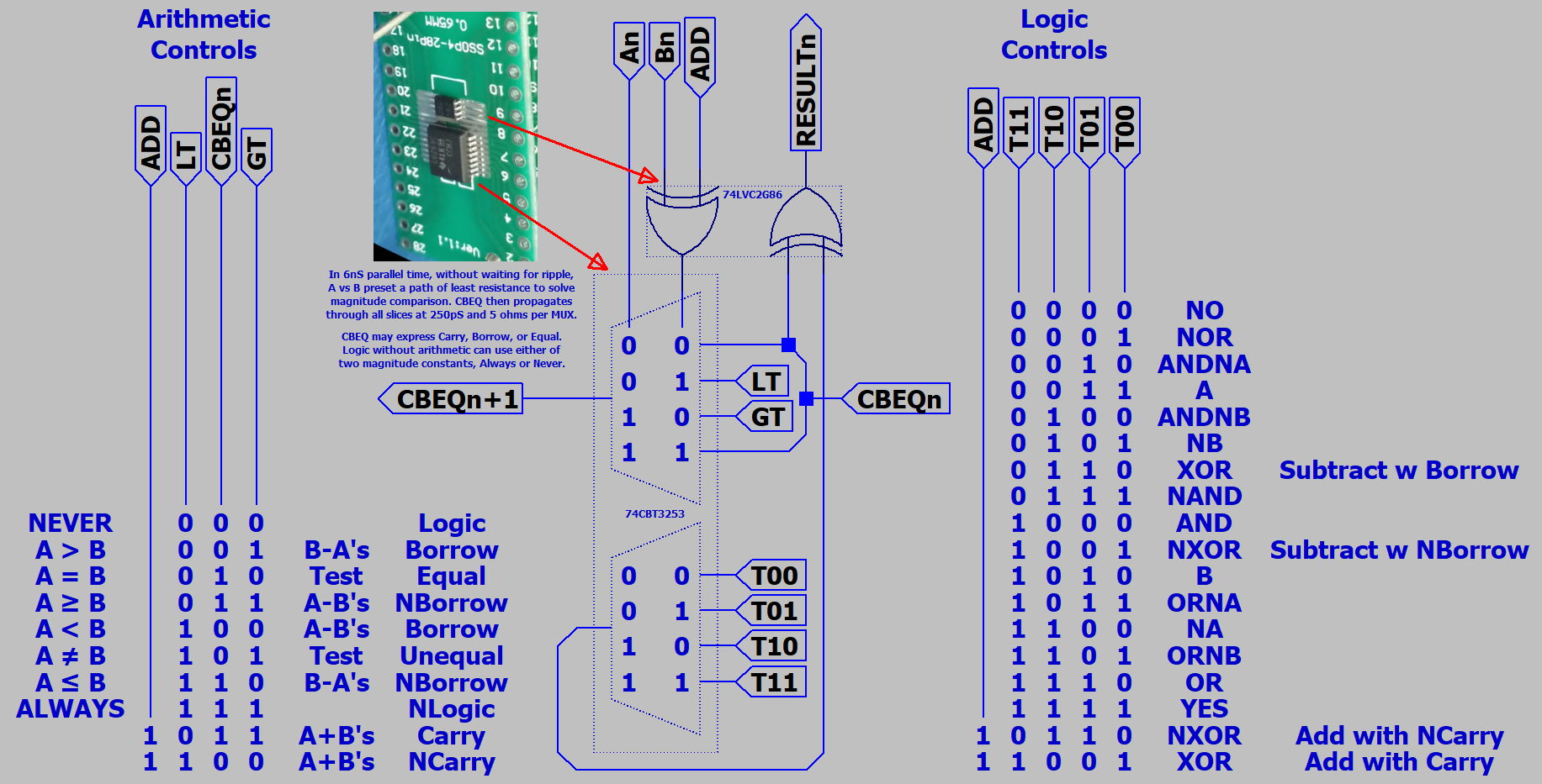

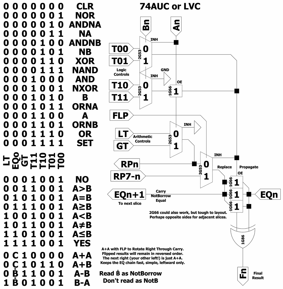

Abuse of 74AUC2G53 Inhibit pin allows for one less gate.
If it doesn't make sense, just ask. Not my clearest drawing.
Series prefixed Manchester Carry, Borrow, or Magnitude.
Karnaugh 0110 XOR for addition, 1001 NXOR for subtraction.
Propagation rules can be inferred from the Karnaugh map.
No wasted time or control line to XORvert the B input.
Generate and Annihilate are not wired as constants here.
Determined by replacement rules LessThan and GreaterThan.
Allowing < = > magnitude comparisons, A-B, B-A, and A+A.
A+A RLTC isn't using addition, but leftward replacement.
Rotate Right TC relies on an external reversing loopback.
RP loops back to reverse order 76543210 ~ 01234567.
No attempt made to flip a reversed result back to normal.
Just keep Rotating Left Through Carry (your other right).
These rules neck down to a single capacitive load when inhibited.
So not to burden a long chain of tranmission gated propagation.
I also triple 1G66 propagation gates to better handle fanout...
CBT doesn't switch as fast, but far less series resistance.
Not entirely sure AUC is better. Depends chain length.
PostPosted: Fri Sep 22, 2023 11:08 am
Joined: Fri Sep 22, 2023 9:42 am
Posts: 34
CBT slices are super easy to build.
Not AUC fast, and can't rotate right.
Even A+A requires pre-load B with A.
But low part count and 5V compatible.
74CBT3257 might be stronger for adjusting FLAG to make CBEQn=0.
Overflow (not drawn) is a simple XOR of CBEQ3 vs CBEQ4.
To ADD and nothing else, this slice might be faster.
Series prefixes are decoded for free, internally by MUX4.
Same for all above, even those wired to borrow or compare.

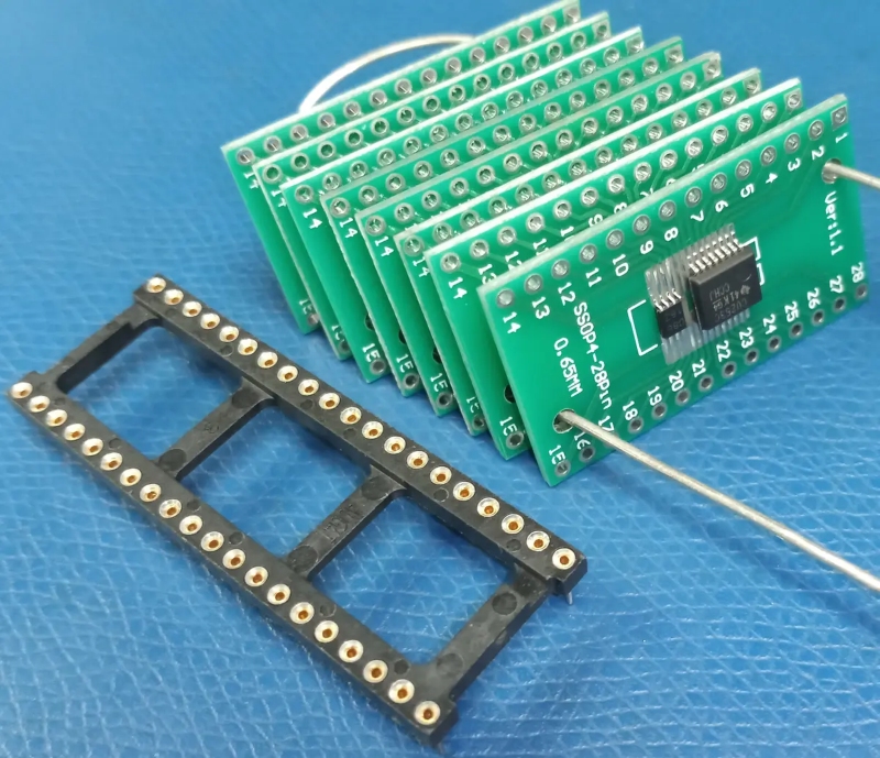

AOI of any width can be done with discreet diodes, resistors, hex inverters.
Got 5000 Schottkys and tubes of 74S04 for that experiment some day.
Once you factor spaghettis, the plan unravels without a custom PCB.
OTOH, an entire slice of CBT fits on a generic SSOP to DIP28 converter.
Only 2 SSOP ICs with plenty o wiggle room between...
74AUC2G53 MUX2 propagate through 15 Ohm and 9pF CIO_ON
74CBT3253 TwinMUX4 propagate through 3 or 5 Ohm and 18.6pF CIO_ON
Maybe 4pF less CIO_ON, depending stuff the spec sheet isn't clear about.
Reading both TI and NXP sheets to help fill in those blanks...
Still, external spaghettis could easily be much worse than internal.
The asymmetry you mention, less resistance to GND than VDD.
Either might propagate faster from a pre-charged high state.
Not exactly Domino, but maybe interleave ALUs to pre-charge?
Give the idle ALU some dummy task that results in all Carrys...
Too much Sphagetti. Doubt IC parasitics are the limiting factor...
Too little Sphagetti. Unreproducible construction method...
Striking a better balance.
