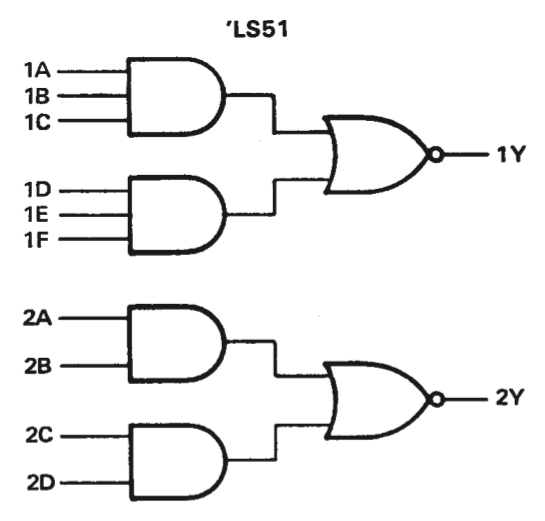

Sadly, though, Digikey list no AND parts in any logic family with more than four inputs, which limits the possibilities for building this from discrete logic. The fastest listed x283 (unless I missed one?) looks to be the 54/74F283 at just under 6ns to valid carry out, but obviously with the concomitant voltage limits and power consumption.
Can you reverse the logic and use a 74AHC30? Or, how about using a 16V8 PLD as an eight-input AND? Only thing you have to watch out for with the PLD is the TTL-level VOH.

Squonk wrote:
…if you can get combined AND/OR/NEGATE gates, which are not available as discrete chips, unfortunately
